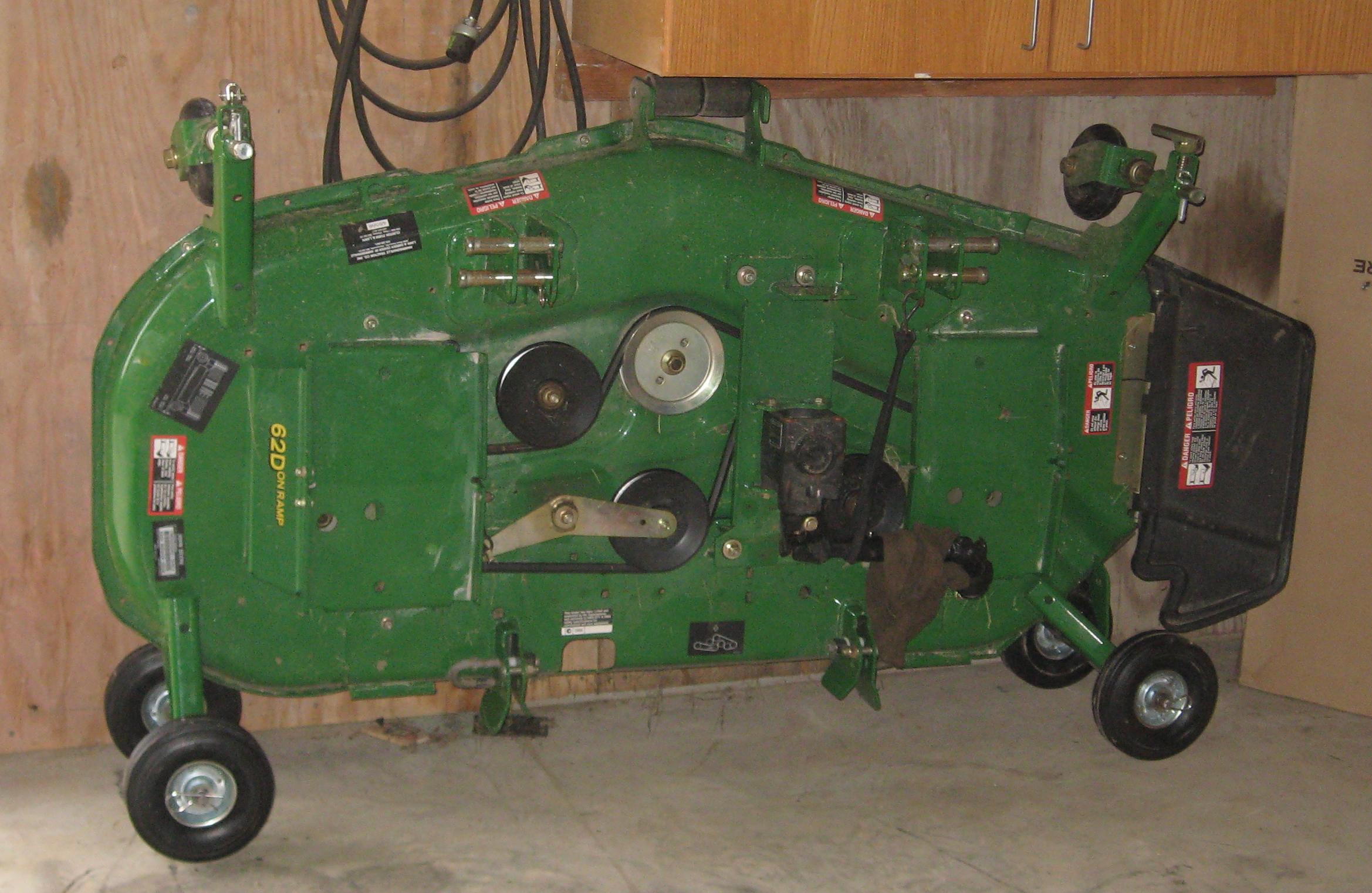

"Now I'm trying to figure out how the h... I'm going to move the thing to a winter storage spot."
Make or buy yourself a pair of axle stands.
   / 62D deck has me scratching my head...... #16
That is a good idea. Like your setup. Right now I'm having to lift them on to a pallet one corner at a time and move them with my forks. I can manage right now, but one day my back is going to give out. Eventhough I lift with my legs, sometimes the back does handle its share of the weight.
   / 62D deck has me scratching my head...... #17
   / 62D deck has me scratching my head...... #18
"That is a good idea. Like your setup. Right now I'm having to lift them on to a pallet one corner at a time and move them with my forks. I can manage right now, but one day my back is going to give out. Eventhough I lift with my legs, sometimes the back does handle its share of the weight."
Now, I'm trying to figure out a way to make them "steerable" so I don't have to pick up one end to turn it....as was said, the ...... thing IS HEAVY.
