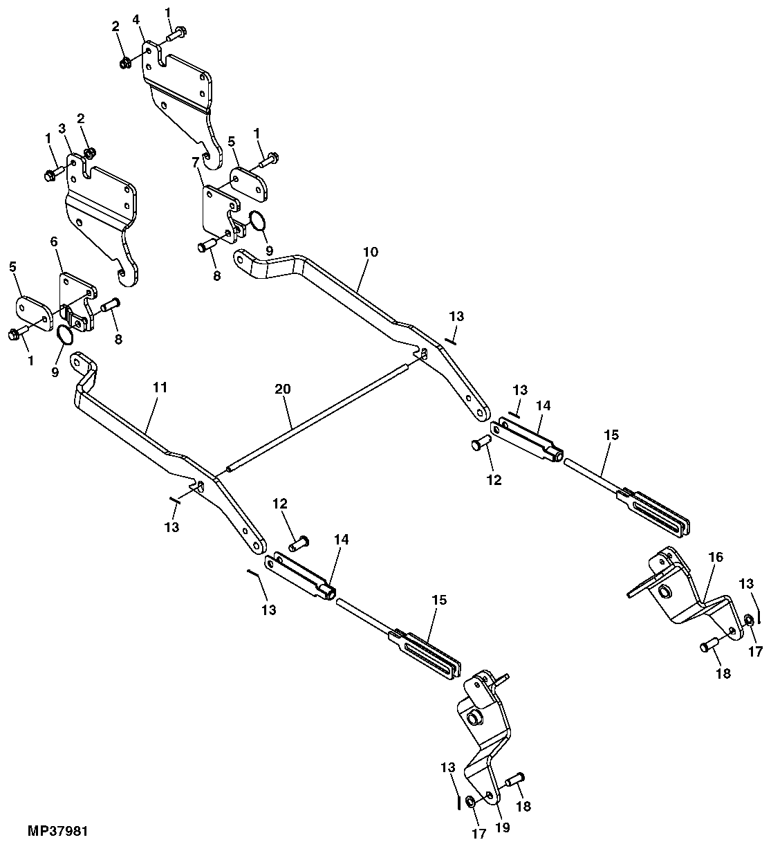

You are correct, there are two intermediate brackets that go between the rear of the long mounting arms and the three-point arms to allow raising/lowering of the deck. I believe these would be items 16 and 19 on the attached diagram.

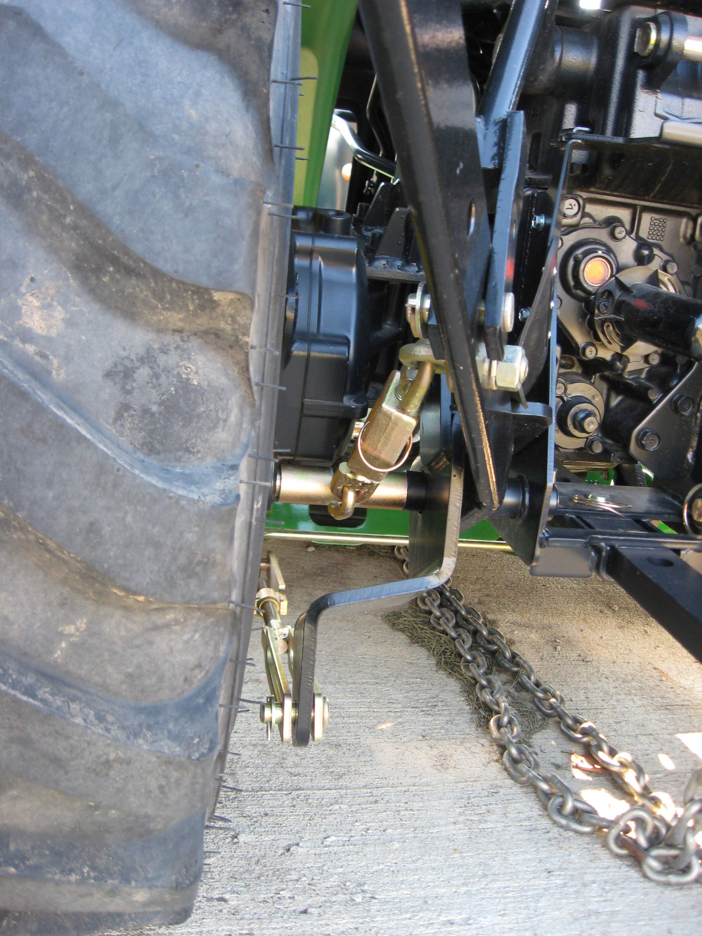

Here is one more pic, showing the left hand bracket described above.

Thanks, that's what I'm missing, I'll call today and see if he still has that on his tractor. Boy that sure looks like its close to rubbing on the tire!
   / 62D for 2520 tractor #14
They are very close to the tires, maybe 3/4 inch, but I haven't noticed an interference problem. The good thing is, you don't have to worry about them swinging back anf forth because they are mounted solidly on the pins that hold the three point arms.
   / 62D for 2520 tractor #15
If I may, a word of caution. When you get all the hardware installed and go to raise the mower the first time....be careful. Do not pull the three point lever all the way back. Pull the position control lever about 3/4's and then check the mower deck and insure no damage will occur if you continue raising. You could damage something on the bottom of the tractor or bend the mower deck. The bottom of the tractor has stops built in. Normally, on MMM you adjust the rods going to the three point lift arms to allow for the mower deck to be approximately 1/4" from each of the stops when at the highest raised point.

Wow, those brackets sure hang low.
