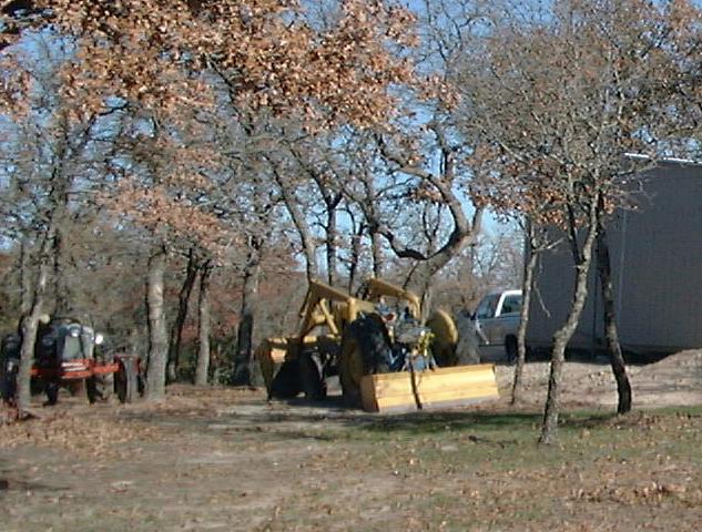

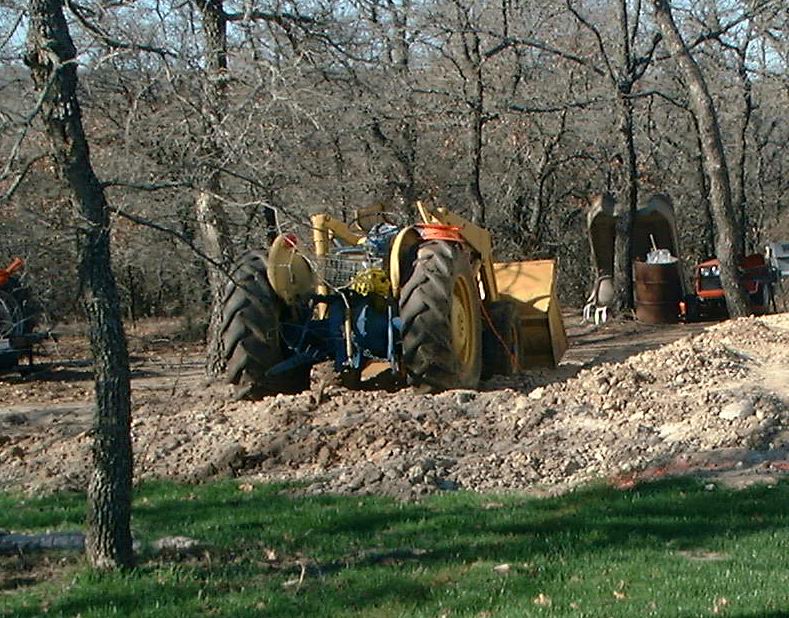

It is a 4000 industrial 4cyl gas with SOS transmission.
My 4000 was exactly the same. Here's a couple of pictures before I sold the "beast." I was never so happy to see a tractor leaving on a trailer as I was to see this ol' smokin' Ford go. The "Select-O-Leak" transmission was not one of my favorite features.:rolleyes:
