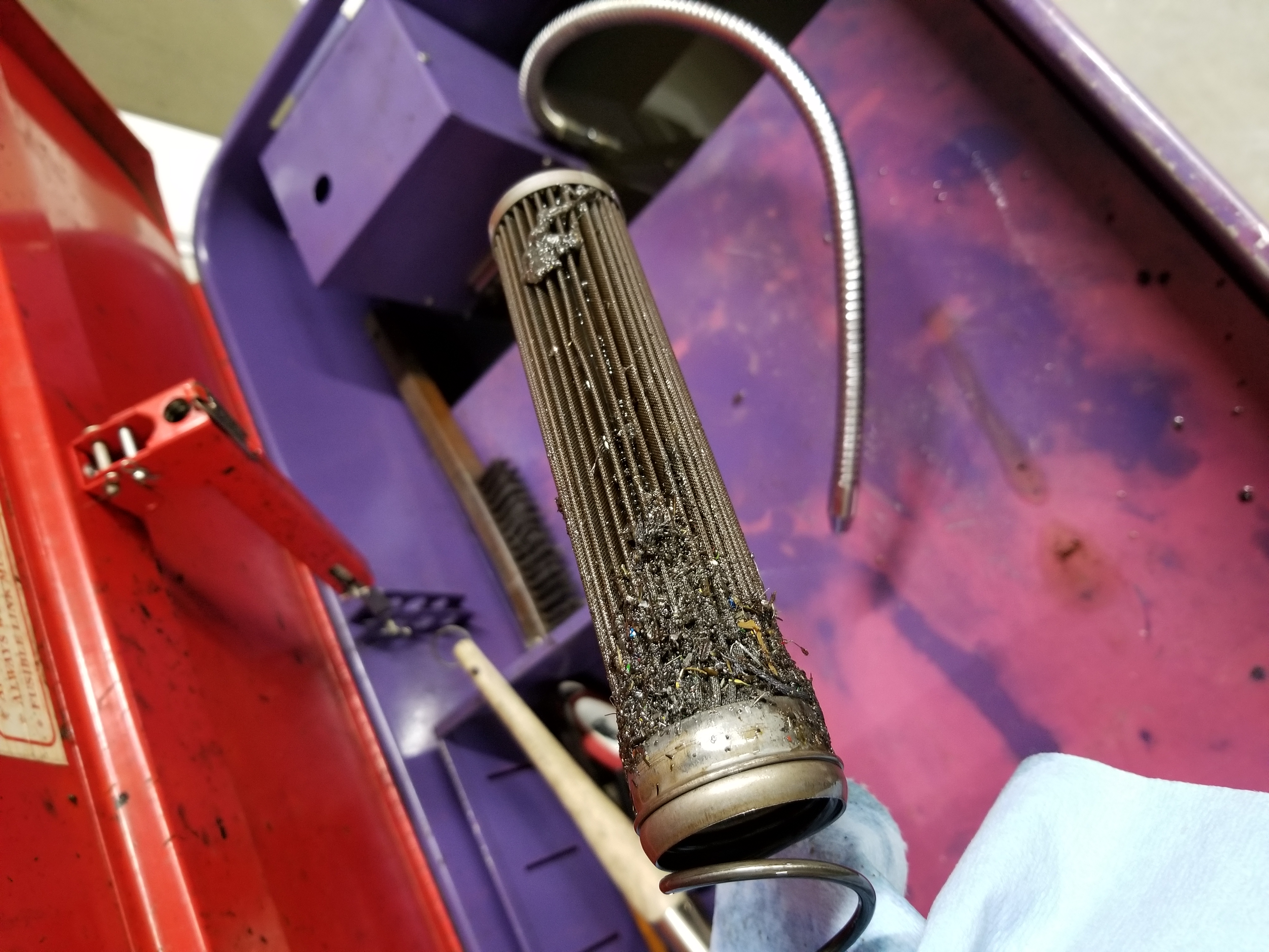

Ok, i pulled the screen and have a new one on order, it was pretty clogged up. I never knew that screen was even there, the manuals don't show it as something to check during service. Anyways, I'm going to put the pump back together with a new seal kit and reinstall. Hopefully between the clogged screen and bleeder I'll have better flow, and fixed my problem.
   / 6410 Hydraulic temp light coming on #13
What kind of material was clogging the screen? Could it be brake or clutch lining material? Can you post a picture of the clogged screen?

Here's the screen pic. There was a bit more sludge/goop material that made its way into the bucket when i pulled it out. What's the best way to flush out the sump to ensure the new screen doesn't get re-clogged?
   / 6410 Hydraulic temp light coming on #15
Cleaning the sump is alwas a challenge, but using a long screwdriver or thin prybar to scoop out what you can from the hole the screen is removed from is effective in that area. Then pour some diesel fuel through can help flush it out. It may be necessary to clean the screen a couple of times to get rid of the rest of it. Disassembling the transmission is not usually practical unless there has been a major failure and disassembly is required anyway. I think the material on the screen is not brake or clutch material. There does appear to be some brass flakes in there from something. Probably not enough to worry about unless it keeps reappearing when cleaned again.

Cleaned the sump out by rigging a garden hose to my wet/dry vac. Then flushed it out with some diesel, replaced screen with a new one, but still having an overheat issue. I got another suggestion of checking the rockshaft valve for cracks, so i'll be pulling that apart tomorrow to inspect. Apparently this series tractor has had a history of problems with that?
