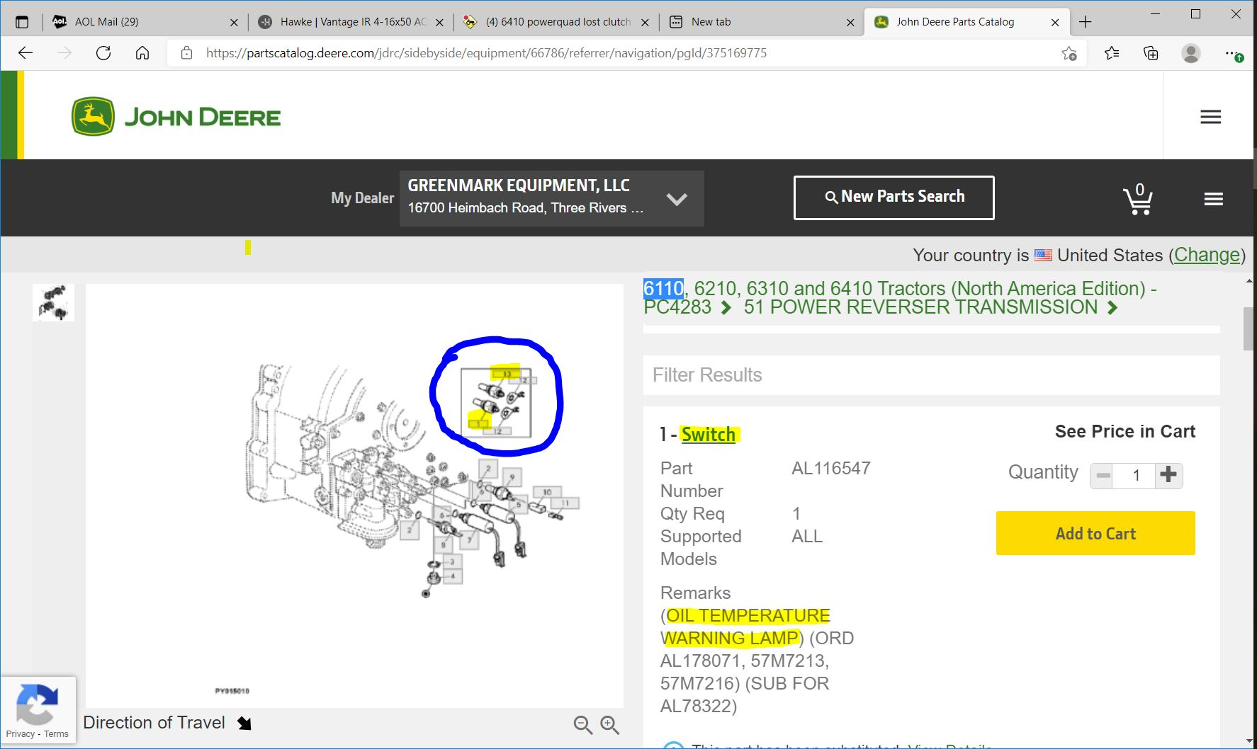

After mowing for 45 minutes this morning it would not stay in forward or reverse. rcu codes 17 and 67
17 = no effect on tractor opertion
67 = neutral start switch indicates not neutral, but no reason for this
   / 6410 powerquad lost clutch #12

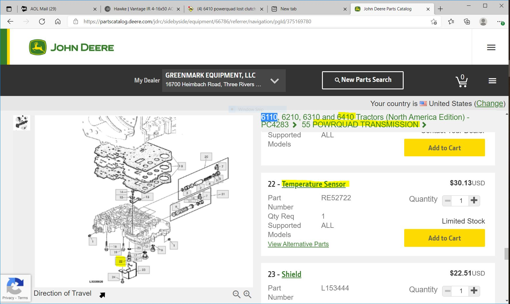

Where is the temp sensor? Guessing it’s not working since I have seen no light on dash when non contact is showing 245° on top of block by scv
I found two in parts, one is called temp sensor: Power Quad transmission, the other is called switch: for PowerReverser They show two different switches key 1 &13
#13
When I looked it up I found the picture for the powerquad which is what mine is. But this picture shows it on the right hand side of that bottom valve plate. On my transmission there is nothing on that side for sensors or switches. Only on left side near the solenoids for reverser.
