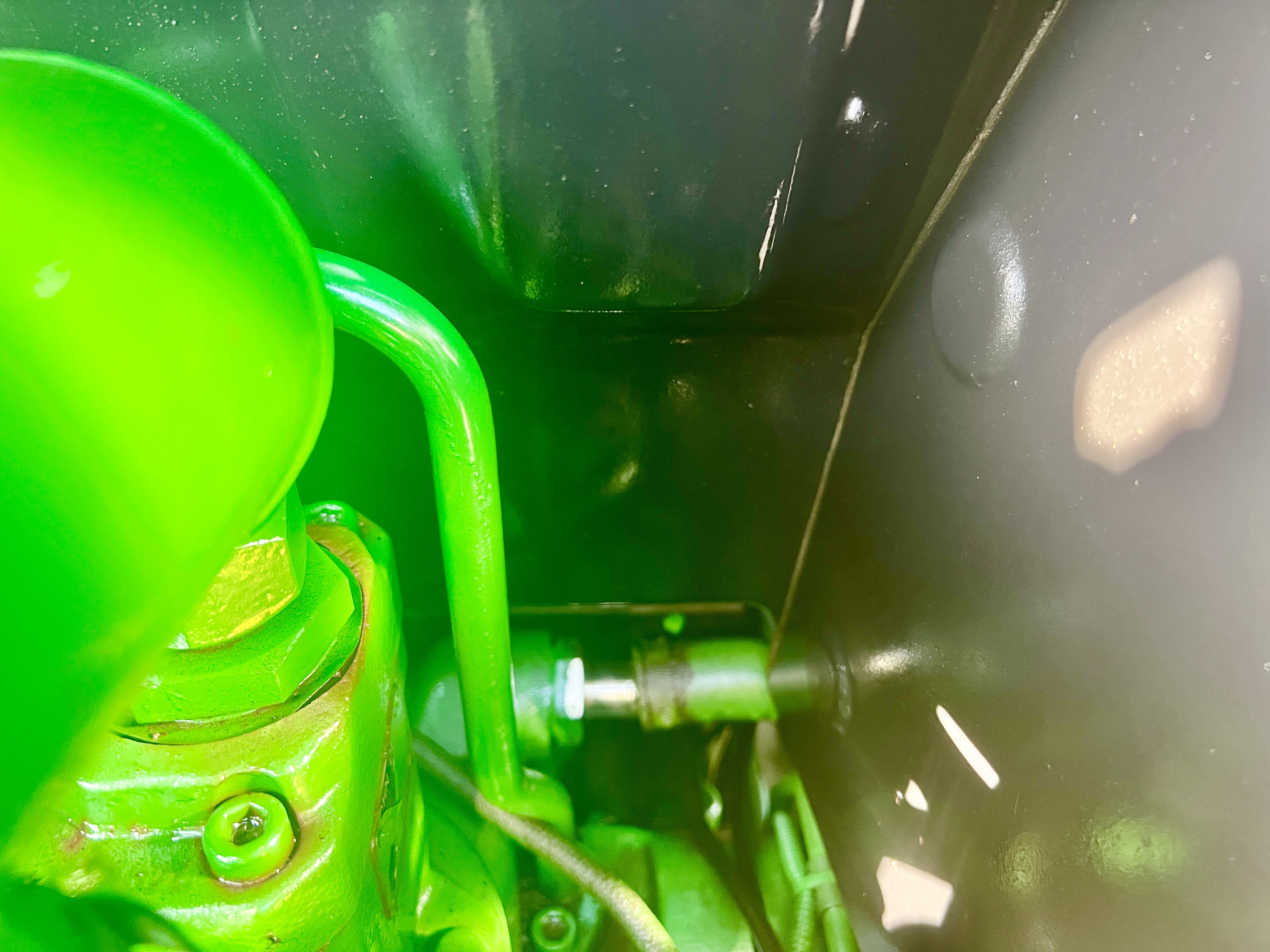

340 original hours. Anyone know what this is and how to fix it? Standing behind, looking in over top right arm just in under cab. TY so much and may God bless you and yours.

I’m a little disoriented looking at your picture. I see some kind of fitting or hydraulic cylinder that looks bent. I can’t tell for sure.
Other thoughts. Is the hydraulic fluid overfilled? Is it getting to hot?

I agree with Dodge Man I cannot make heads or tails of the picture.
I have found that when fluid gets too low you can begin to add air to the fluid causing foaming, thus expanding the volume of fluid.

On another forum it was pointed out a hose clamp is missing. I think what I saw when I first looked is a hose on the right, mostly painted green, and the fitting on the left that the hose slid off.
