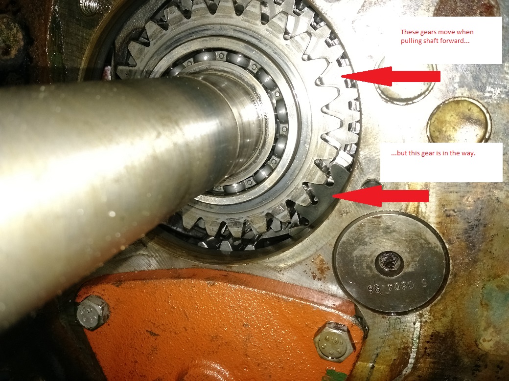

I know this is an old thread, but I'm hoping Bobvt is still hanging around.
I am trying to remove the transmission shaft (to replace inner shaft seal) and synchronizers (because no teeth left on front ring) from the 6500 4WD transmission, and I can't for the life of me figure out how to get the shaft out. Tractor is split and trans is open from the top. I was also starting to think I would need some special tool to remove the hi/lo gears and shaft, but it seems Bobvt found a better way. I agree that the service manual is not very clear when it comes to the 4WD trans.
Any chance Bobvt or somebody else could give me a clue on how to proceed?
   / 6500 4wd transmission #15
This is what I'm looking at, if that helps at all. Let me know if more pictures would be helpful.
   / 6500 4wd transmission #16
Just in case anyone's interested... I was able to remove both PTO and trans shaft, both of which need to come out to replace synchro. The short version is:
1. Remove reverse gear shaft - drive out roll pin, remove lock bolt from outside trans house, thread bolt into plug on front of trans housing and pull out. You'll need a magnet to retrieve pieces that fall to bottom of trans housing. Let the gear sit off to the side.
2. Remove shift shafts and forks from right side of trans. You should now be able to pull out hollow trans shaft. It might not seem like it will come out, but it will.
3. To remove the rest of the synchro, PTO shaft needs to come out. Remove PTO engagement lever from right side trans housing, disengage inner lever from collar. Curse and spit a bunch while removing stupid snap ring from engagement collar. Remove band retaining springs and detent balls. Drive out roll pin.
4. Pull PTO shaft forward. Remove rest of synchro from top.
