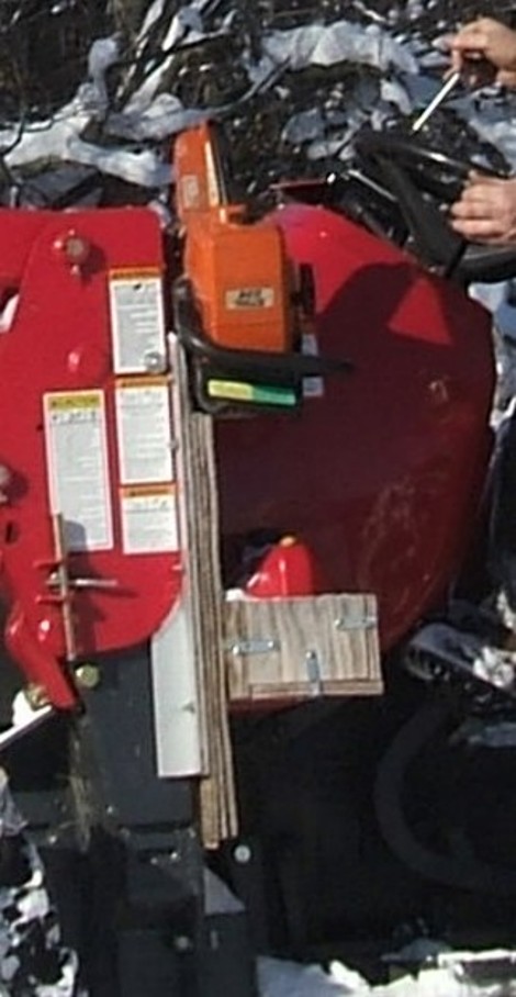

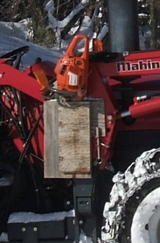

Just another way to make a chain saw holder. This shelf will hold 2 saws, oil gas etc. I it attached to my winch operator protection piece.
The holder is just a roughcut (2") 2x6 that I bored into lenghwise. Could probably use a reg (11/2") 2x6 if your boring aim is good.

Looks like the holder will do the trick. One of the disadvantages of my left side holder is it makes exiting the tractor a little more difficult.
