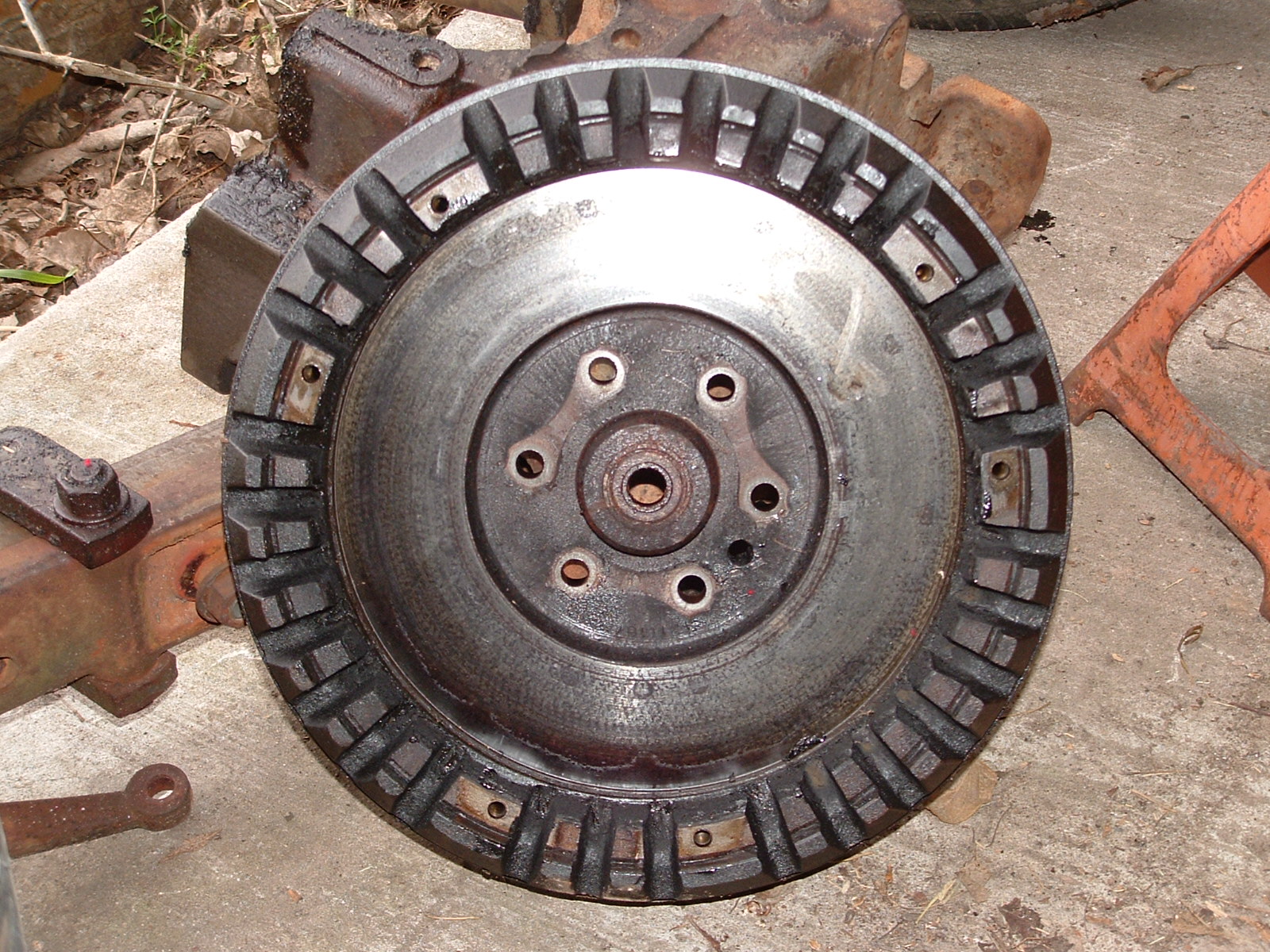

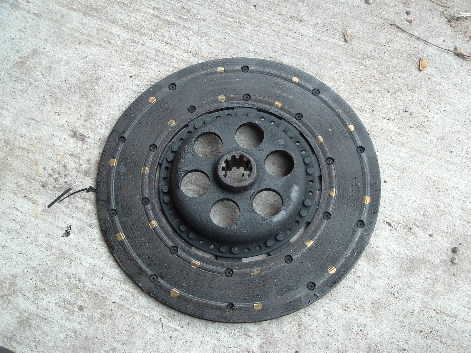

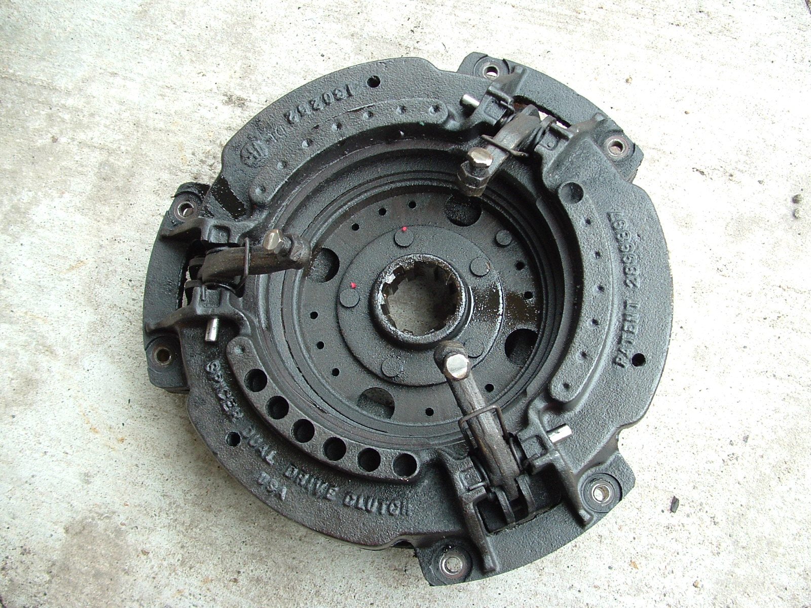

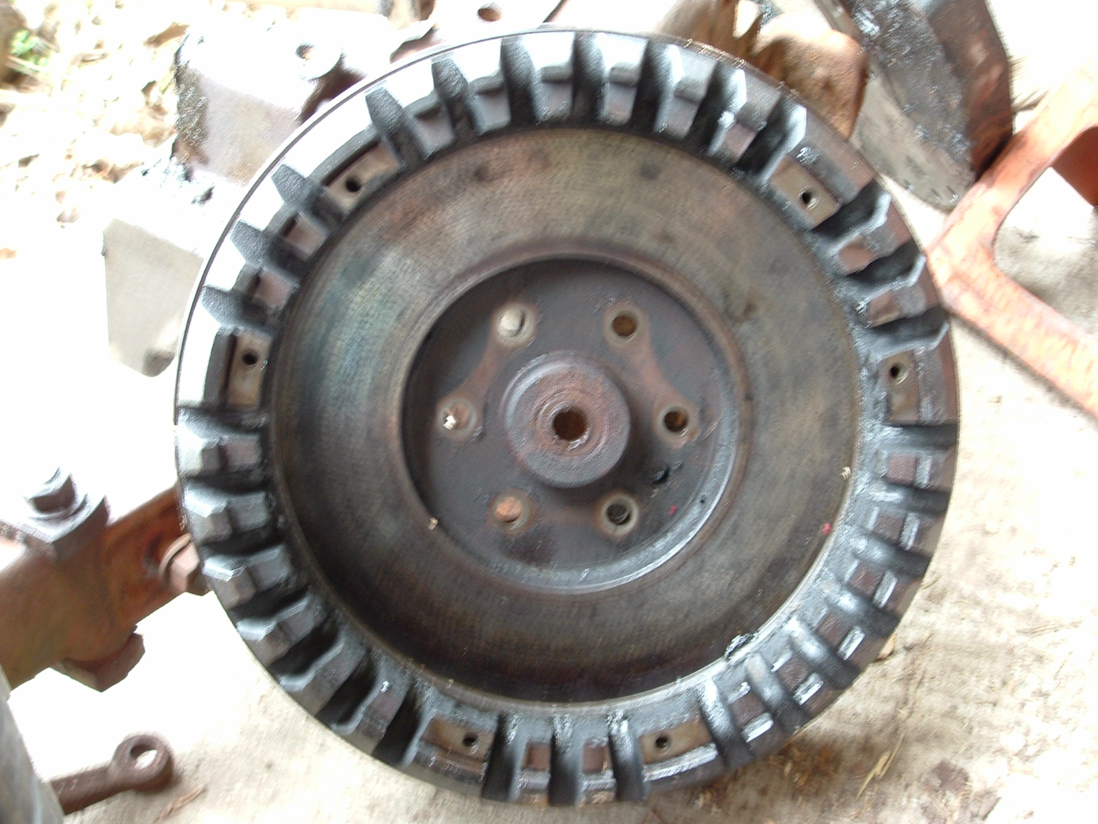

I bought mine on the internet. Dont recall from what company. If you do order on the net, try to determine how many springs are in the pressure plate. Try to make sure there are 12 springs in it. Some companys put less springs in there for some reason. Wasnt too pleased to see that the clutch I bougnt was made in India, but it seems to work ok. The original one was Spicer, made in USA. I saved the old one just in case. Heres a pic of the assembled old pressure plate, the drive disc, and the flywheel. TB

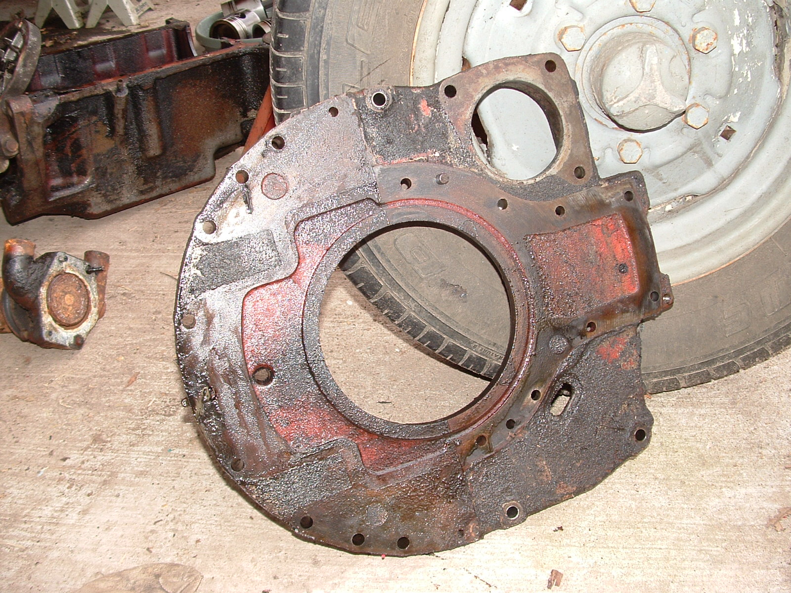

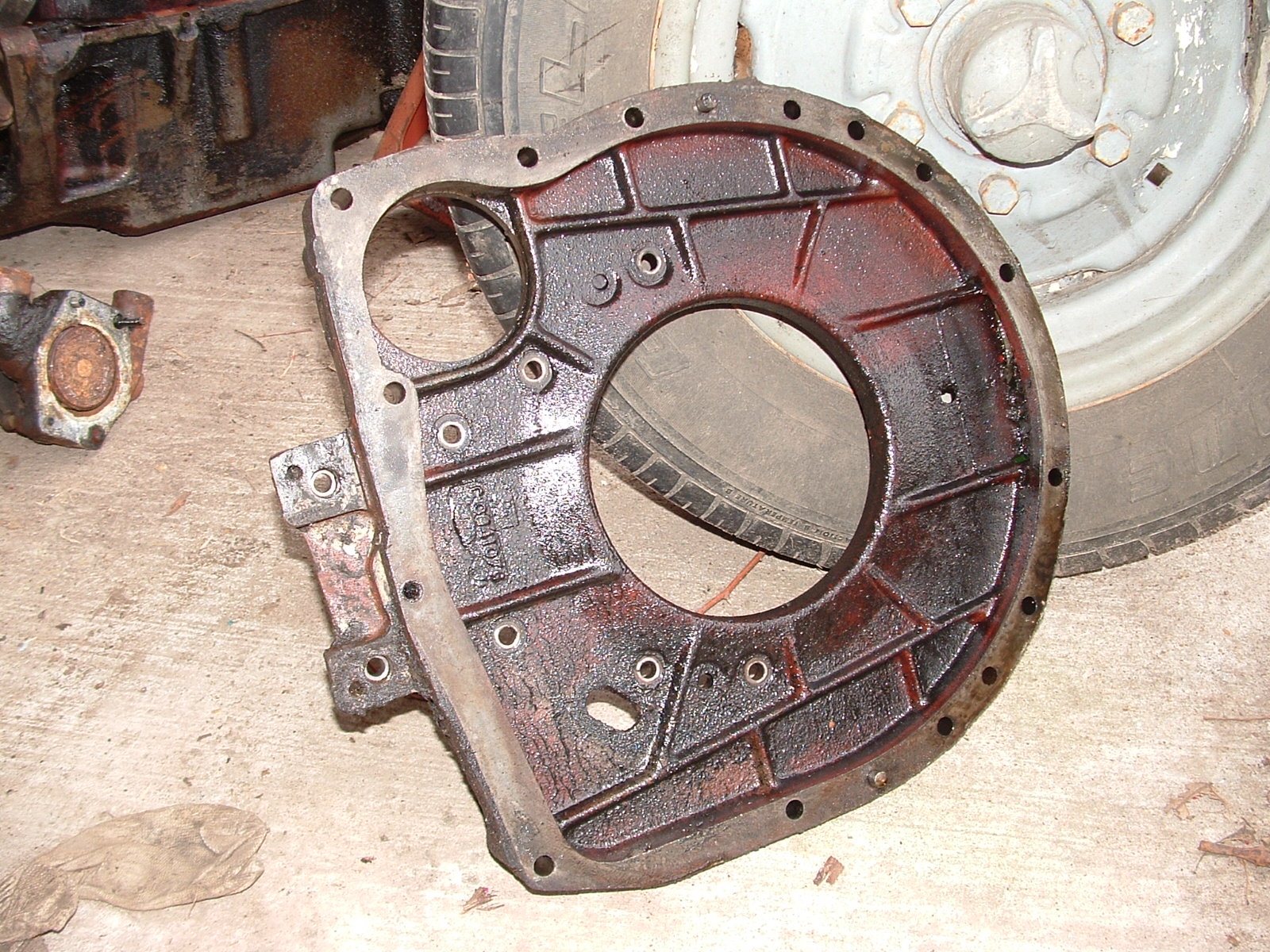

That flywheel pic is crappy, heres a better one, and also the backing plate that goes between the motor and bell housing. TB
