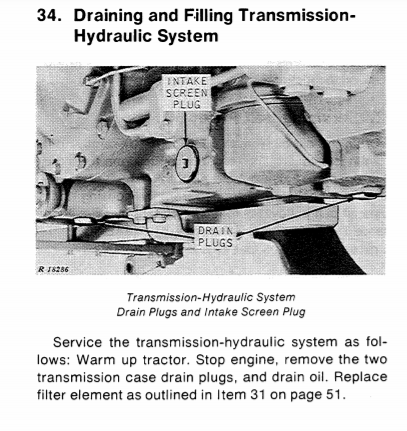

   / 68 JD 400 hydraulics acting up.HELP! #6
Before even considering replacing any hyd pump one should perform the easiest tasks first. It doesn't get much easier than changing the hyd filters & checking cleaning the hyd oil suction screen.
Next I suggest to perform good hyd diagnostic procedures before entertaining the thought of replacing any hyd pump!!!
Photo below is for an ag not ind tractor but round cannister holds 1 hyd filter & 2nd hyd filter is located near by.
JD 400 ind tractor has closed center 8 piston hyd pump in front of radiator with an internal stroke control valve that controls hyd pressure. If stroke control valve gets some foreign material in stroke control valve seating area it will affect system hyd pressure.

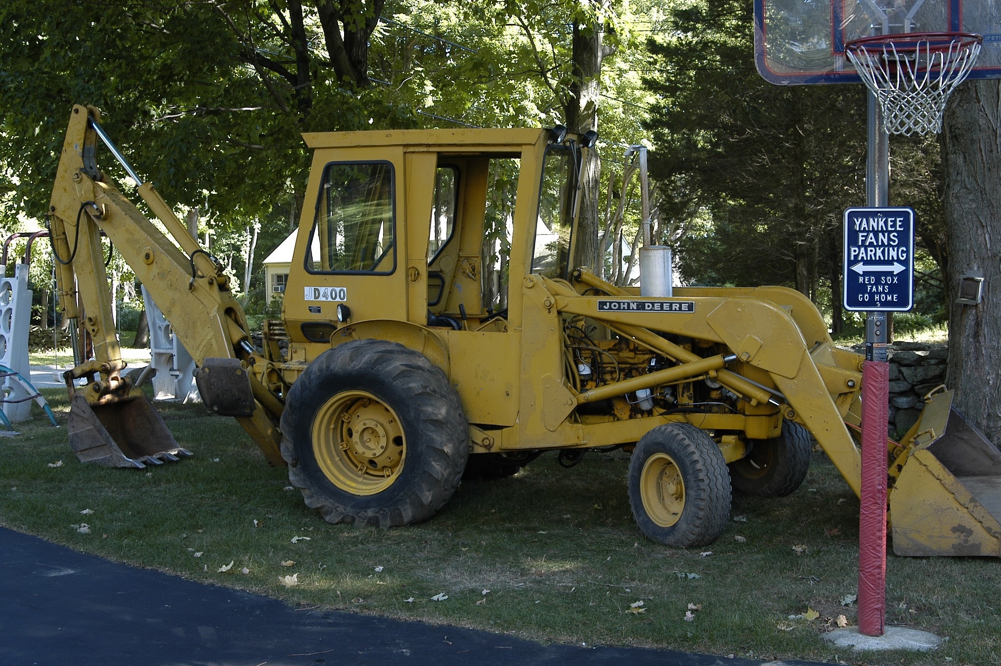

I had a 1970 JD 400 that had issues with the loader, it would work fairly well, although a little slow, until the oil heated up, then it would hardly lift at all. The backhoe and stabilizers worked like a champ. I tried everything I could think of, re manufactured hydraulic pump, rebuilt the diverter valve etc. I had the JD mechanic out to go over it and he was stumped.
About 2 weeks before I sold it, I read something about the steering valve having priority, taking pressure away from the loader. I removed the steering column and had a guy that worked at JD rebuild it as a side job. After I reinstalled the steering column, the loader worked like new.
This may be your answer too.
