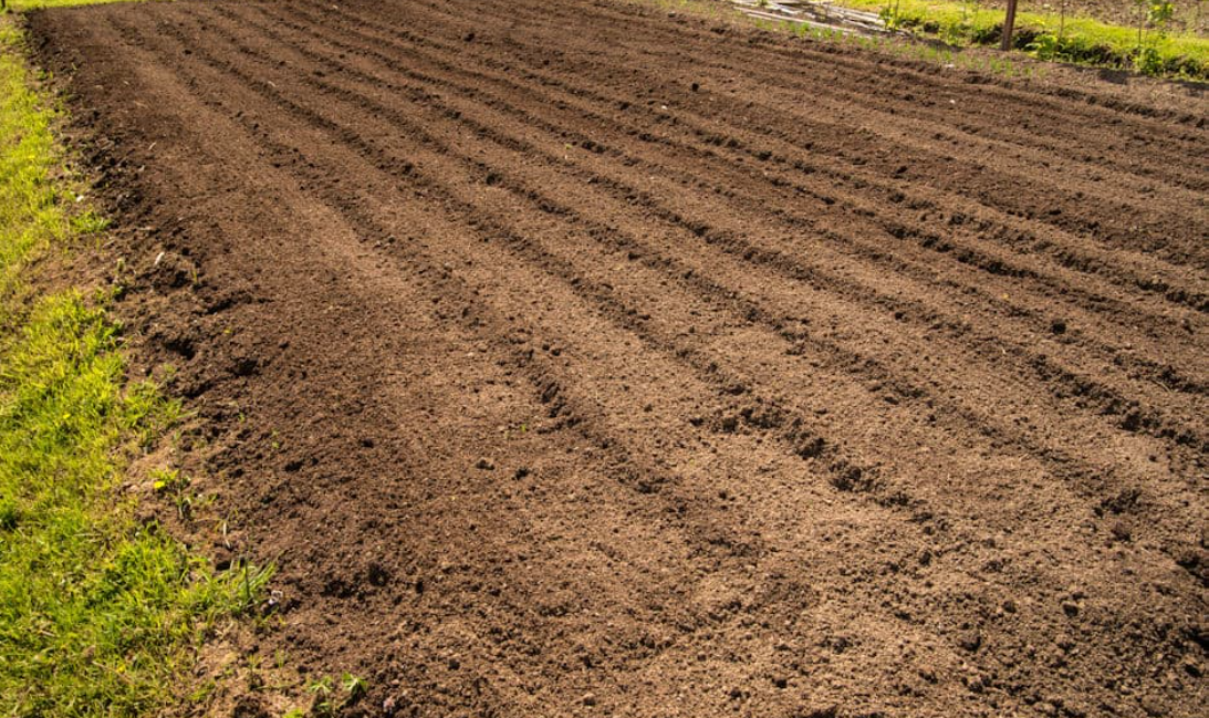

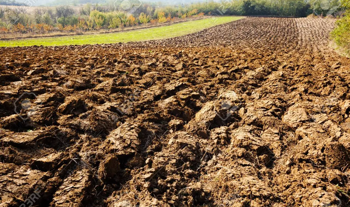

If the ground needs plowed and disced before using a tiller, why bother with a tiller at at all.
Different things, different tools.
Plowed
Tilled
