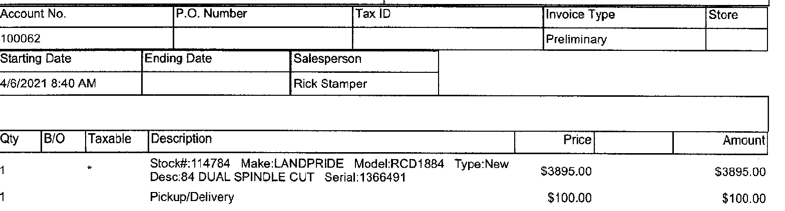

#11

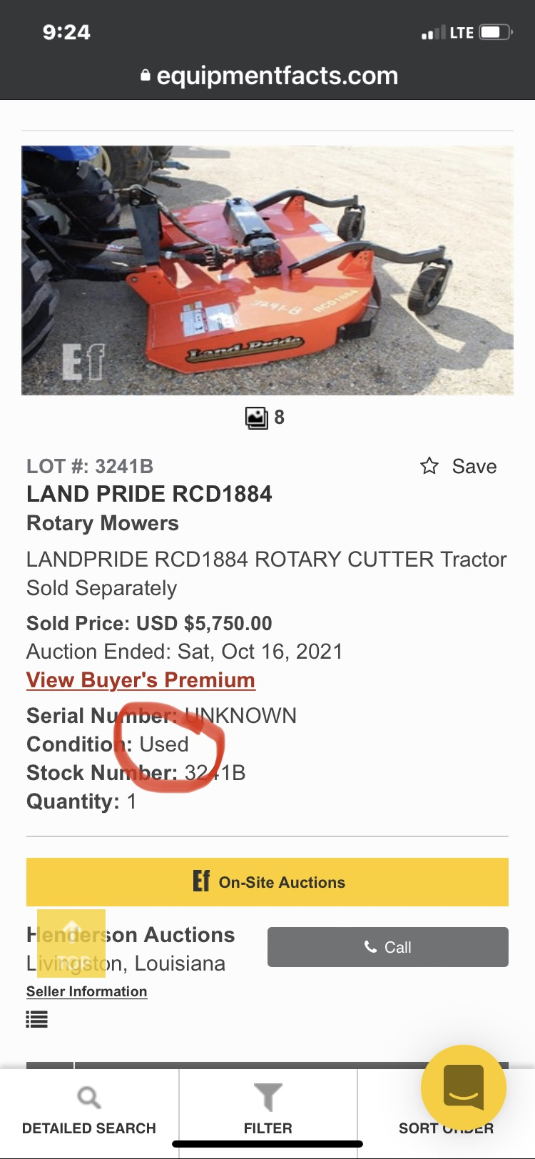

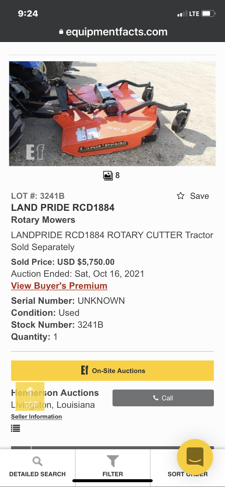

#12
Dbl sorry
   / 7’ and 8’ dual spindle cutters I’m considering-input welcome :)
#13
And the Titan came in at $6k. With a 4 month wait! At least we’re heading into fall- if get it in the middle of winter LOL
