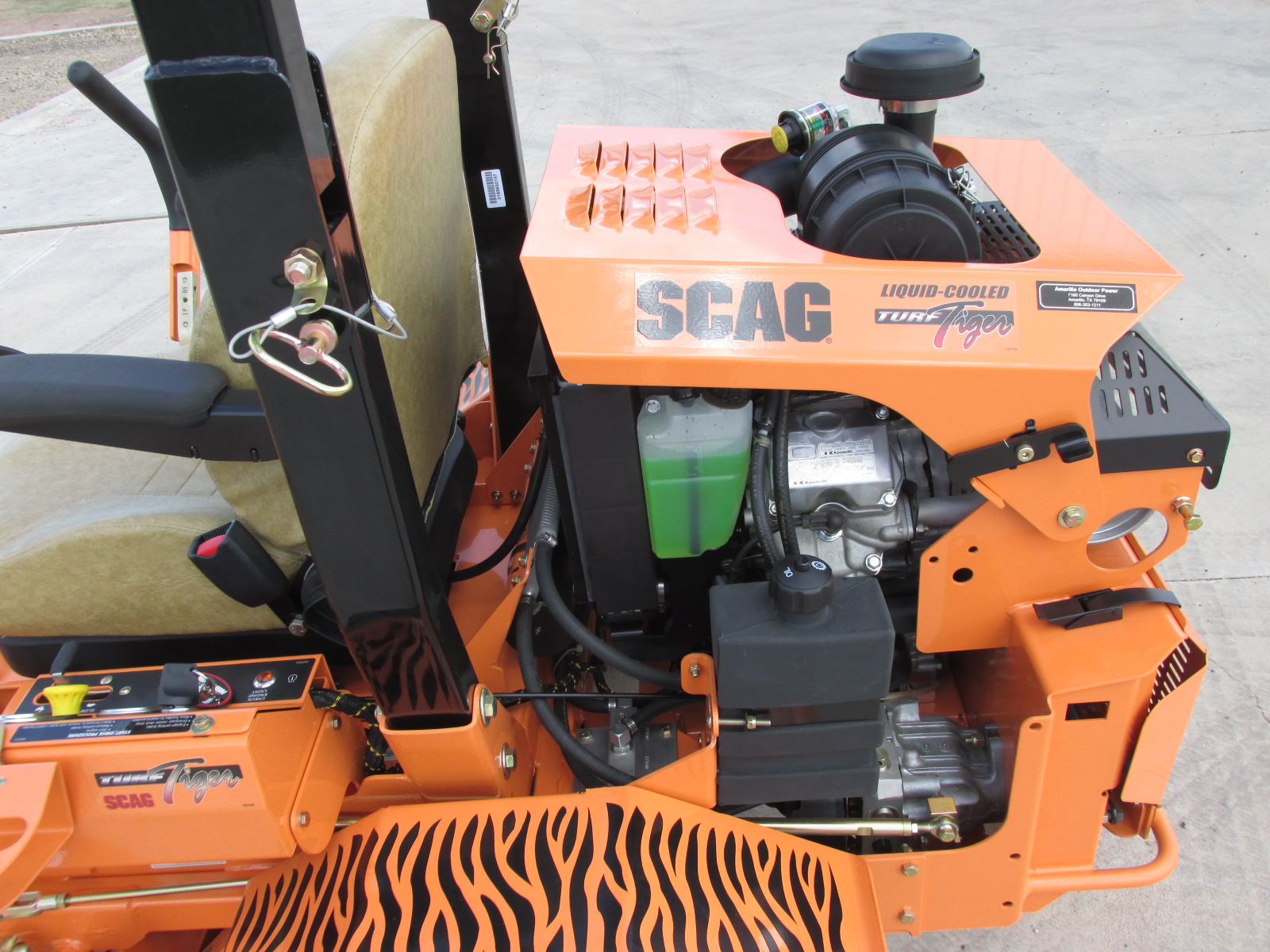

Which model Scag is that? Edit: Oh, I see, Velocity Plus
Velocity plus is the type of deck. The model of the Scag mower is a "Turf Tiger"
