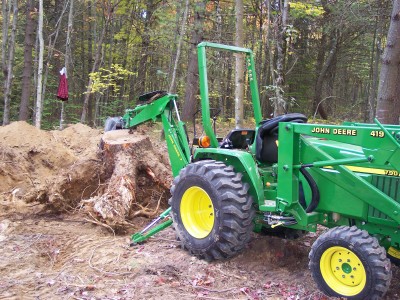

Hello, all. I've been anonymously viewing the John Deere threads for a few weeks since getting bitten by the tractor bug. The resulting fever culminated in my first CUT (or any tractor, for that matter) purchase - JD 790 4x4 w/ filled R-4's, 419 loader, & 7 backhoe. Well, I had to come clean - I've registered and here's my first post! Anyway, I love my Deere and it has easily exceeded my expectations of performance for any job I've given it so far. Believe me we've been busy; after only two weeks, the Green Gobblin' is ready for its 50-hour planned maintenance! Check out my White Pine stump test here in the rocky soil of northern New England...

View #2

Welcome aboard WD, that's a mighty familiar looking tractor you've got there. I haven't taken out any stumps yet but have had plenty of other fun (work) with my #7 hoe.
Question for you though... With that stump worked free, what do you plan on doing with it? Seems that'll be a bit big for the 790 to lift/move won't it?
Thanks for posting and congrats on your new machine /forums/images/graemlins/smile.gif
   / 7 backhoe stump test
The stump came out; the hole got bigger; the stump went below grade. Chances are, it'll be a really long time before I'll even notice the spot where it'll rot away. This was a bit too much for the loader to handle, but the BH easily maneuvered it up out of the dig where I could prep the hole for planting it out of sight, out of mind. BTW, Thanks for the welcome aboard!

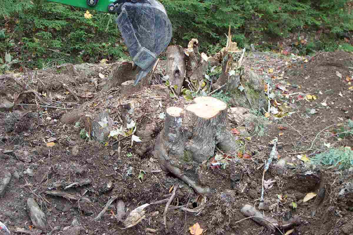

Your profile is not filled out completely, just wondering if you're in Nova Scotia ?? We have a Wartsila Operation here in Halifax our capital city. Question for you is how did you get the roots cut off ??? I started my stump(s) on the weekend & got rained out but after about 2-1/2 hours, I still can't get it to even move. I've attached a pic. Did you pull it out with the #7 or the tractor ??

Pleased to meet you GoodGuy! I'm in New Hampshire and my screenname refers to the diesel engines I'm most familiar with as a Marine Engineer. Part of my stump test required no use of chainsaws, pickaxes, or shovels. The roots were severed solely by the digging force of my #7! I was, and am, very impressed... This wasn't my first stump, though; I had to work my way up until I was confident the Green Gobblin' could take on this task. I've had the best luck working from the periphery toward the center - snap those tendrils off all around the base, then corkscrew the stump out with the BH bucket. My stump test logged 3.2 hours on my 790 hourmeter - definitely not 3.2 hours of work, but fun!
