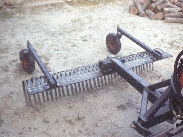

I have a B2710 and use a 6' super heavy duty homemade landscape rake. This rake is orders of magnidute heavier duty than any 6' or 7' rake that you can buy commercially. I have no problem using it in soil or gravel. Catching a root will stop the B2710 in its tracks but then agian even a large L series will spin too. A picture is attached.
I also have a 7' Landpride rake assembly without the hitch that I was thinking of repairing (needs a few welds) and making a bigger rake to eventually sell or just sell as is for anyone who wants to roll their own rake (PM me if local and interested). I would have no problem putting this behind a B2710.
