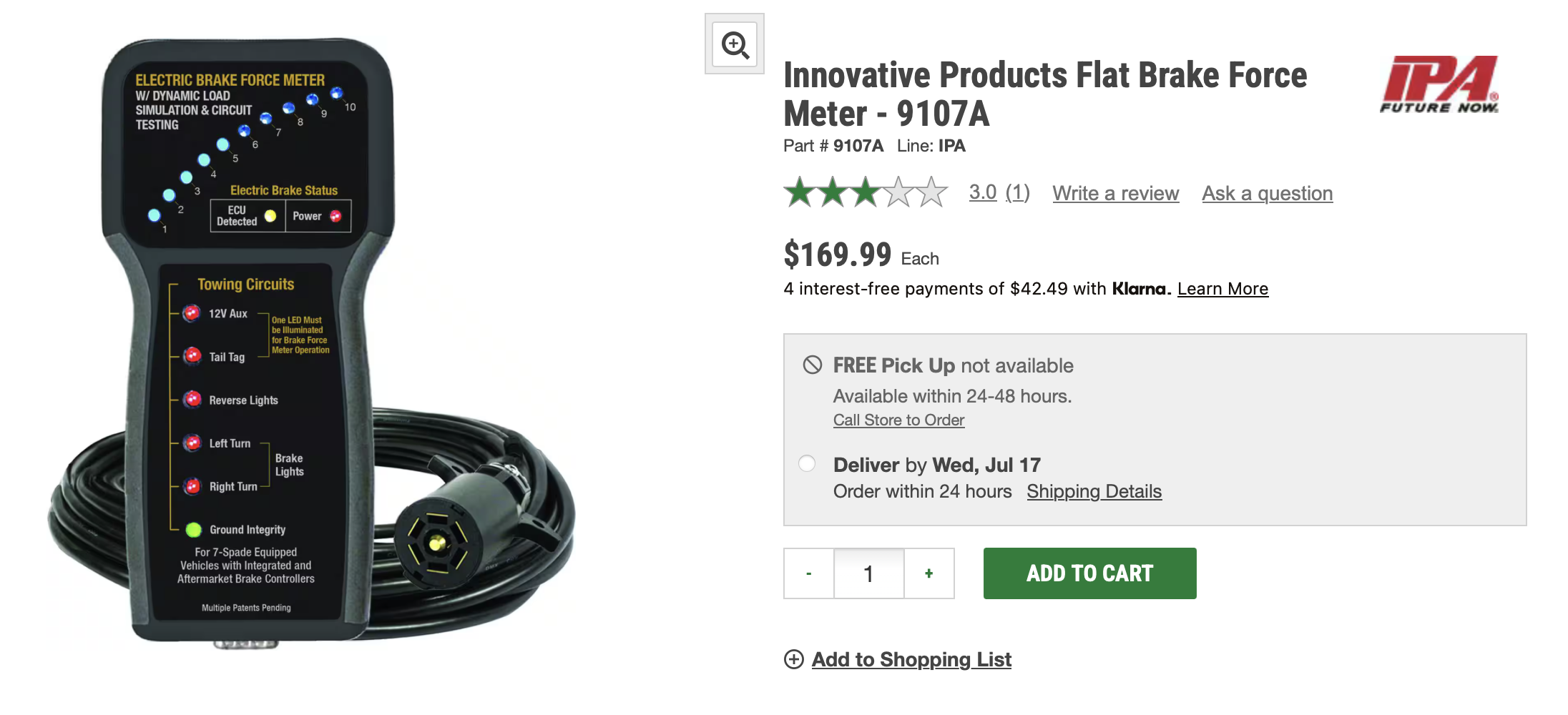

I need a 7-pin trailer tester that has a remote cord long enough that I can sit in the driver's seat and observe the output of my truck.
And.....
I need a 7 pin trailer tester with 12v power so I can stand watch behind the trailer,
push buttons on the remote and see the response.
I don't know how I'd test electric brakes like that but I could test everything else.
This doesn't sound like a difficult product to construct, even DIY.
Wow that's real nice, thanks PTSG !

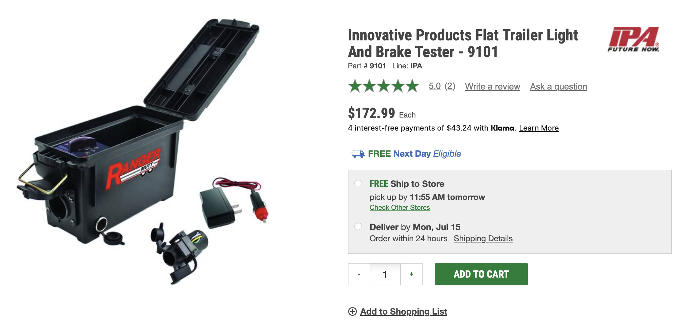

And here's my other wish: https://www.oreillyauto.com/detail/...flat-trailer-light-and-brake-tester/ipa0/9101
It has a battery in the box so you can test the trailer without a vehicle.

I believe that one will test the truck side circuits but not the actual trailer. Looks like the brake tester is testing the adjustable brake force signal from your brake controller.
Here is the one to test the trailer.
To get both it would be $343. I would have to find friend to watch the lights for me before spending that unless I was diagnosing issue at shop regularly.

View attachment 880087 Wow that's real nice, thanks PTSG !
View attachment 880088And here's my other wish: https://www.oreillyauto.com/detail/...flat-trailer-light-and-brake-tester/ipa0/9101
I have the trailer tester box in the second photo. It's saved my butt several time at work. I've also made up an adapter cable for it to test semi trailers.
That's come in super handy when I have a third party hauler saying the lights are bad.
I can unplug their truck from the trailer, hook up the box and show them the issue is on their end.
