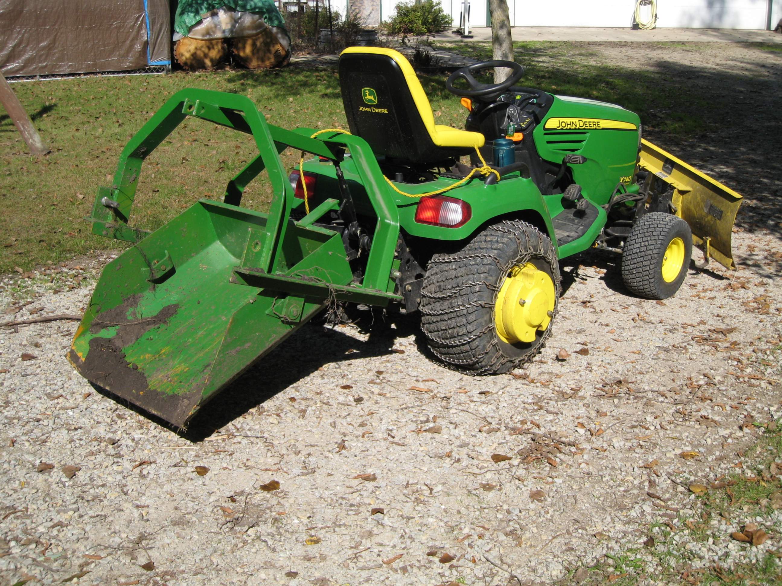

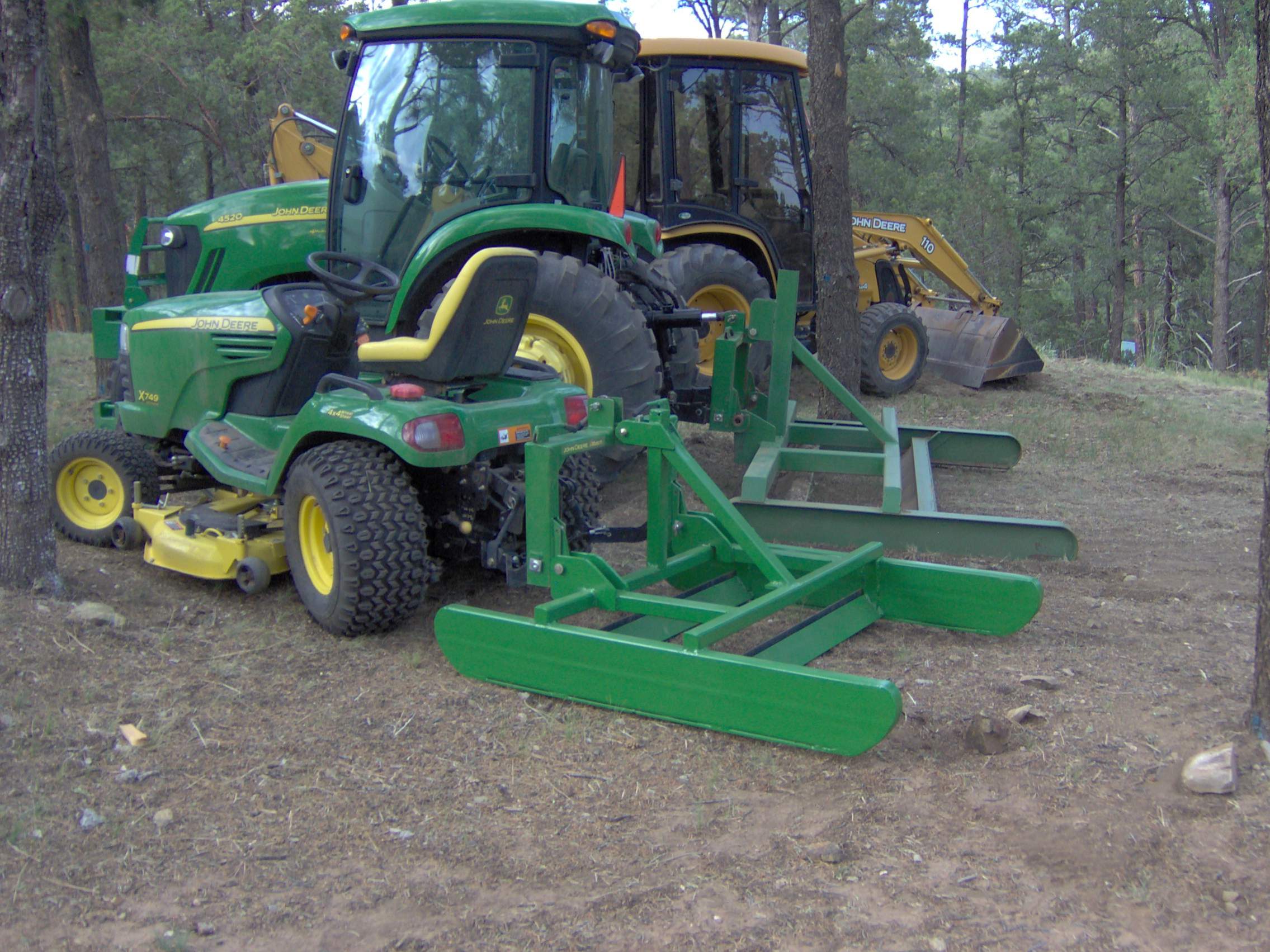

In my use the cat 1 hitch is far better in that all the implements I find are sized for it. Mot much cat 0 stuff available but lots of small cat 1 available everywhere. I have an IMatch on all my tractors including the x749 and it works great.

I had a cat 0 for a lot of years and when I traded in for something else I jumped on the cat 1 hitch for the reasons others mentioned; more attachments to go with it. I did get a 6' rear blade and dirt scoop for it and worked great. I have a hydraulic tiller for it also and continue to use that.
Since that time I bought a 3720 and use those attachments on the big tractor for obvious reasons. If I had it to do over again knowing I would keep my 3720, I would still get a cat 1 hitch, unless they are significantly more expensive.

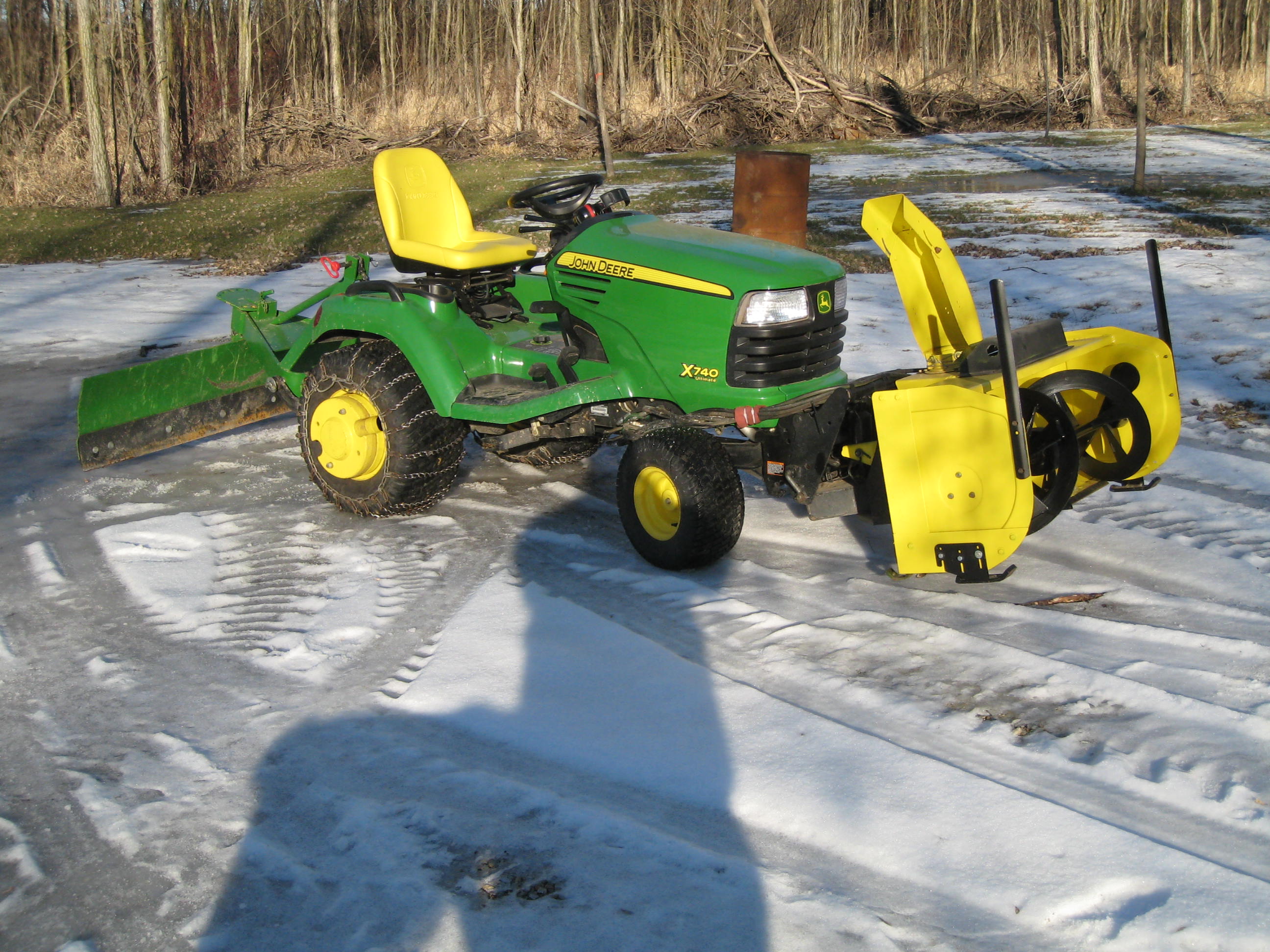

One thing does work good for for the winter months is a snowblower and rear blade combination. I blow the snow and after that drag the rear cat 1 rear blade over the concrete to get it down to the ground. IMG_0381.jpgIMG_0823.JPG
Of course I have to get the 3720 out once in a while to play in the snow, but would never have to.

Pretty cool withy hat dirt scoop on there.
