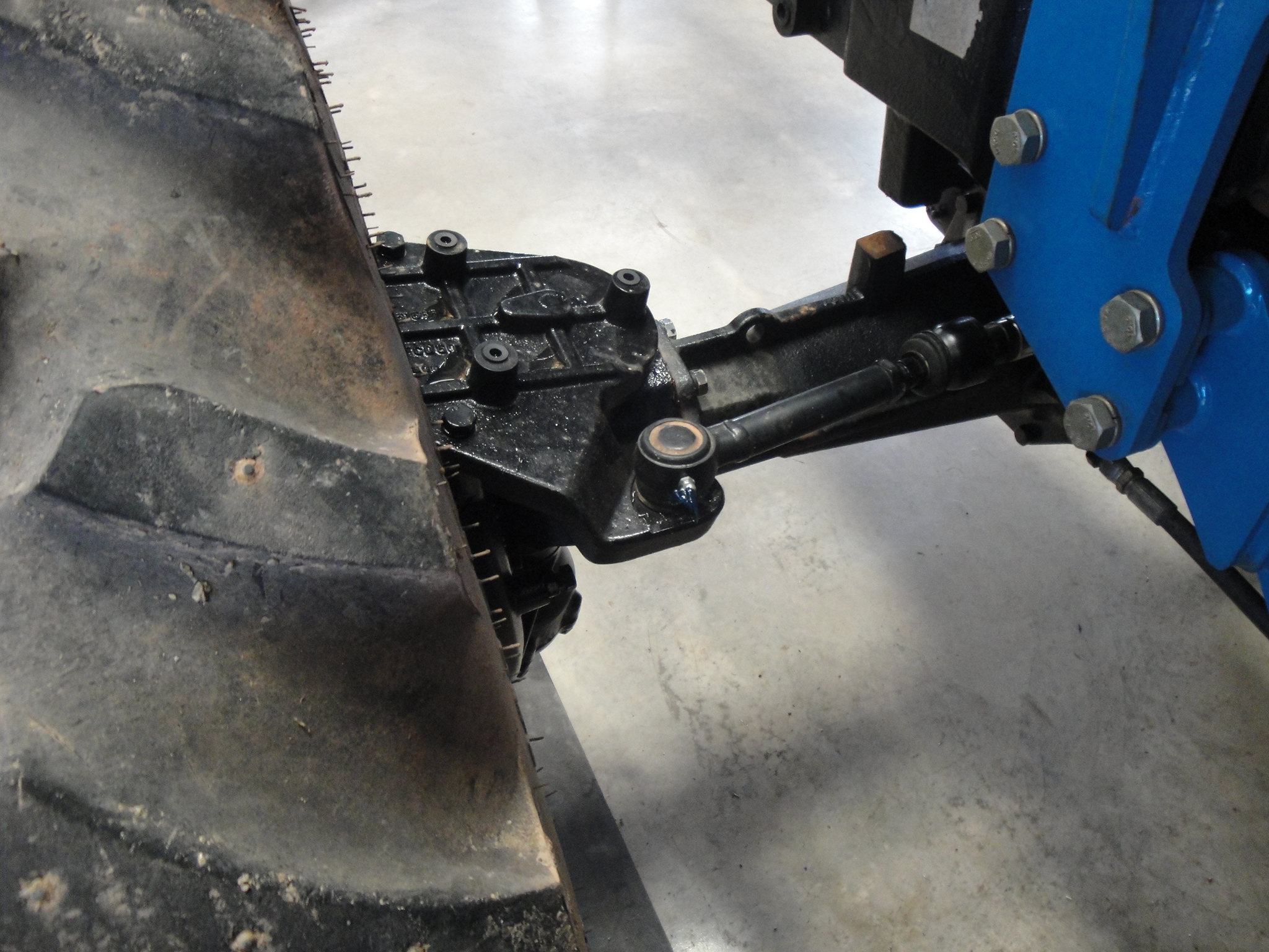

Today I added grease fittings to my tie-rod ends on the 7010. I thought it would be better to give them some grease before they fail. Just a note, that the boots should be sprayed periodically so they don't dry out and crack allowing water to get in.
