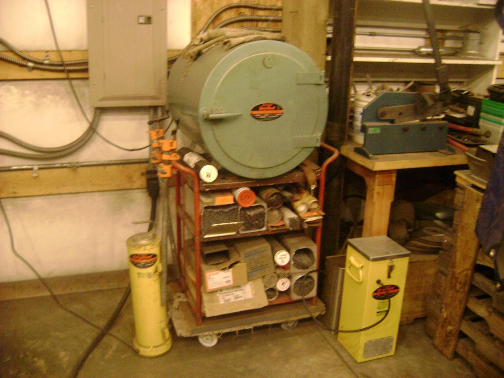

Keep an eye out on Craigs list, and ebay. Can't remember what I paid for the 10# oven, but I paid $25.00 for the 50#, and $140.00 for the 300# oven.

Shield arc, got a very good deal on your rod ovens. I have never seen them that cheap on Craigslist. For the guys with no oven, I would recommend the 50# size as they have the cross bars inside to keep 4 different sized rods separated which is handy rather than just tossing them all together. Your 350# looks exactly like mine. I better go check my shop to make sure mine is still there:laughing:
