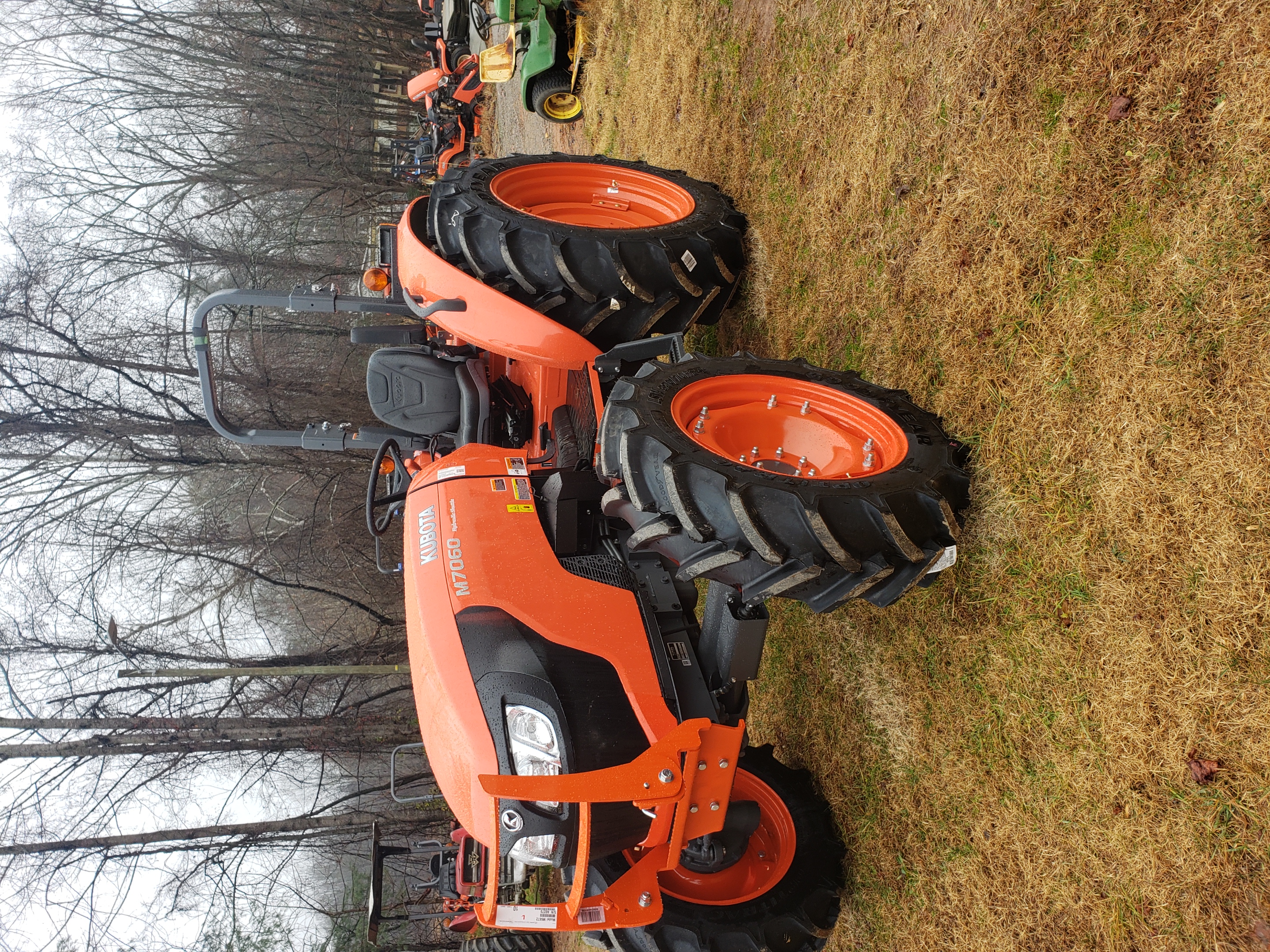

Showed up today with the big meats on it!
   / 7060 R1W tires #25
Those bigger dirt scratchers really look great, much better proportions than the tall & skinnies of the past. Look's good fella's.:thumbsup:

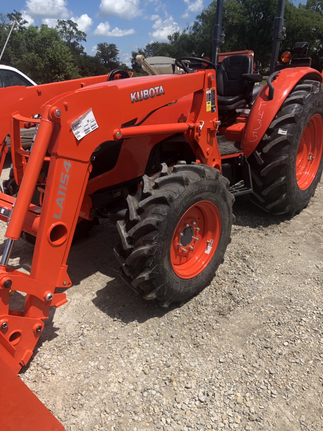

Mine came in this week went with the LSW radials with cast centers
