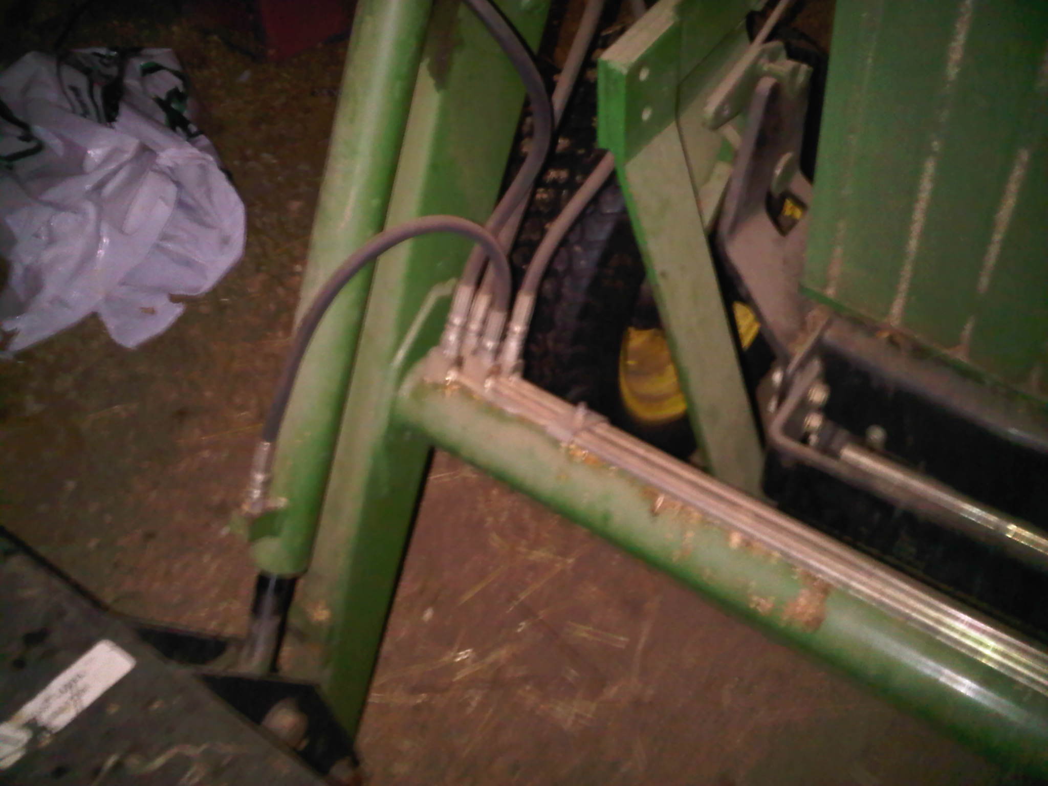

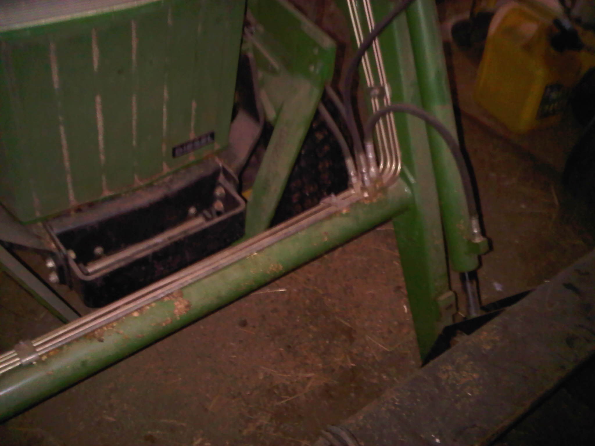

Thanks.... hard to tell in your pics, but are your oil lines one piece or two piece?
   / 70A Loader oil lines #14
Two piece. I can get a close up if you want. Just tell me what you need.

Had some free time today, so I took the oil lines off the loader. I see now why the PO bent the upper oil lines all out of shape. Two of the lines on the cross tube were not the correct part for the application... they must have come from a different loader. They were too long. The PO's "fix" for this was to bend a dog-leg in them to take up the extra length. Of course, now they do not terminate in the proper location so he then bent the upper lines all out of shape to get them to meet those two lines on the cross tube.
I'm going to try to make it by the hydraulic shop tomorrow. I will need to have all four cross tube lines re-made. I tried to straighten the two upper line and return them to proper shape, but they were too far gone. The tubing was bent too much... to the point of work hardening and both of them cracked right at the fitting block on the ends. I will have to have both of those lines repaired as well.
