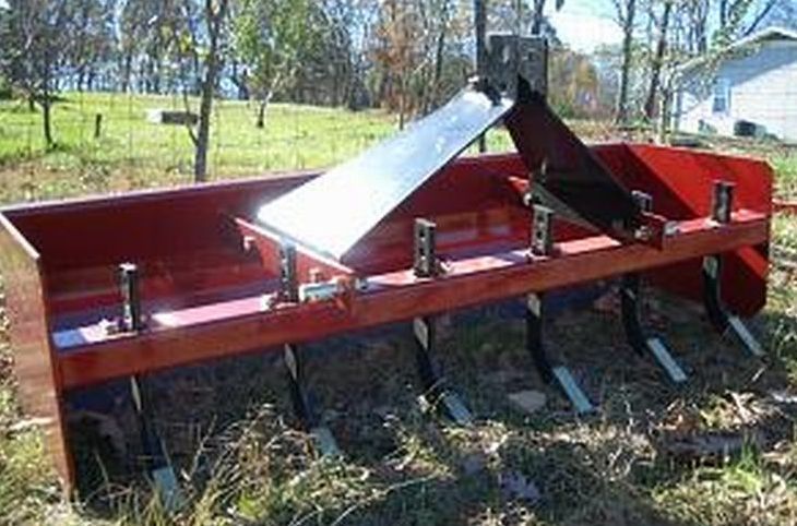

Think I should have been more specific. That's IM (International Machinery), as opposed to IH (International Harvester). No light left today. If I can remember, I'll post a photo tomorrow.
//greg//

Better late than never. Here's a shot of that International box blade I was talking about: six footer, weighing in at 550 pounds.
//greg//
