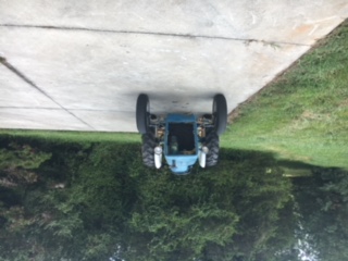

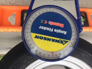

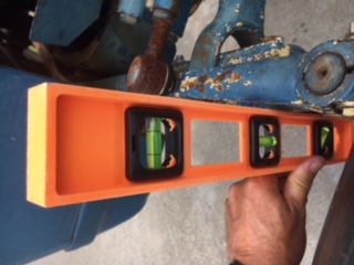

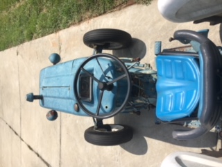

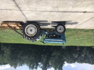

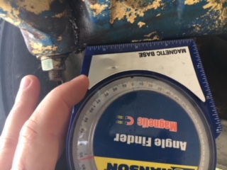

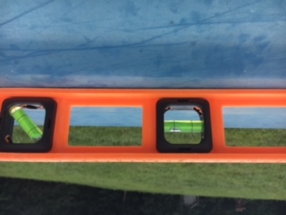

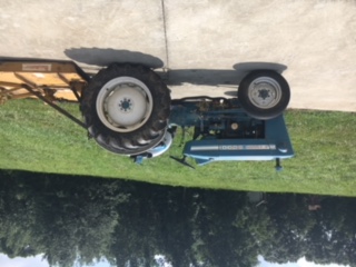

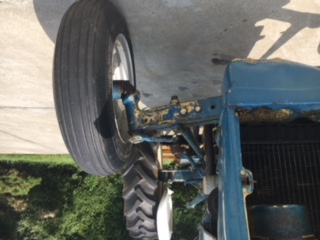

Ok pics are small and don't know if they show nose down accurately. The ground is sloped upward a slightly should have put a level on it for reference.
Looks a little toe out visually. It drives ok. But that is compared to before when I had a loose spindle and about 2-3 inches of arc length of slop in steering wheel.

Do the thrust bearing under the spindle wear out and cause the spindle to ride more on the knees to increase effort?
I am wondering if i put new knees, spindles, bushings, bearings if the steering will get easier.
I don't expect the equivalent of power steering ease but if it will decrease effort and improve steering it might be worth it to me to switch out knees/spindles.

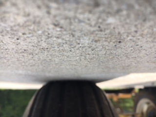

I could give you a college level engineering treatise on steering effort, but let me make it simple first. It looks from your pictures that the front tires are not suited to providing low steering effort. I believe the o.e.m. tires had a single thick narrow rib in the center which would minimize the tire self-aligning moments. Tire aligning moments (from twisting the tire sidewalls) are the principle ingredient of steering effort. Other contributors are scrub radius, wheel rim width, steer arm length, steering gear ratio, etc.
Your tires have a lot of tread ribs which give good traction when the tire is steered, but bad from an effort standpoint. This tractive force generated by twisting the tire carcass is the cause of your problem. You can raise the tire pressure a lot to reduce this effect. This lowers the tire contact patch area and the resistance to steering. You can also reduce the axle weight to reduce this effect by adding a ballast box off the back hitch to lighten the front . If the front wheels are reversible and still clear the kingpins, this will reduce effort if the tread centerline is moved inward (reduces scrub radius).
Easiest thing is air pressure, then weight, then tire construction, then front camber (to reduce the scrub radius), then adding power assist steering. There are some new kits around to add electric power assist and avoid the need for a hydraulic source.
A larger steering wheel can be effective, too. That's the Mercedes-Benz solution to their manual steered cars.

Here is a pic of the ground reference so add another few degrees to caster to my pics and little more bubble nose down if the tractor would have been on perfectly level ground.
I am estimating 5.5-6 degrees of negative caster from my pictures.

   / '72 Ford 2000 steering effort with new steering sector ?
I think caster is a big component of it.
I just went out and drove it up on some ramps and its a little easier to steer on the ramps vs concrete or vs in grass with the nose down attitude. Here is a close up of the contact patch too. I have about 32psi in tires and it seems to mostly be on the 3 center ribs I am guessing about equal to slick tri-ribs contact patch???
I'll probably wait and see if I change out his steering unit then compare the tractors more closely for effort in steering but it seems like right now the short knees are increasing my steering effort a little.
I did not want to change his steering unit and increase his effort for some reason like if the aftermarket units had less ratio than the factory steering unit. But no one has commented on that so I guess they are all the same. I'll measure his turns lock to lock and compare mine vs his new and old etc.
