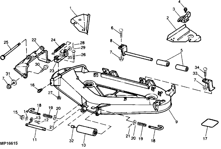

On another note, I noticed while I was changing the blades that there is a bracket of some sort behind the blade area. Is there a roller assembly that fits in there? I bought it used a year ago. I'll go out and take a picture tonight if it helps.
   / 72" MMM. Dang, its heavy!! #16
Yes, there is a rear roller assembly similar to the one on the front.

Yeah, that part is missing on my deck. I'll look into it and see what it costs.
   / 72" MMM. Dang, its heavy!! #18
Do not know what parts may already be on your deck, but quick check of two main parts shows this. Two rollers are required.
Part Number: AM101226
Part Price: 21.48 USD
On Hand: 0 Check Other Stores
Description: ROLLER, REAR ASSEMBLY
Part Number: AM106632
Part Price: 65.40 USD
Description: BRACKET, WELDED
