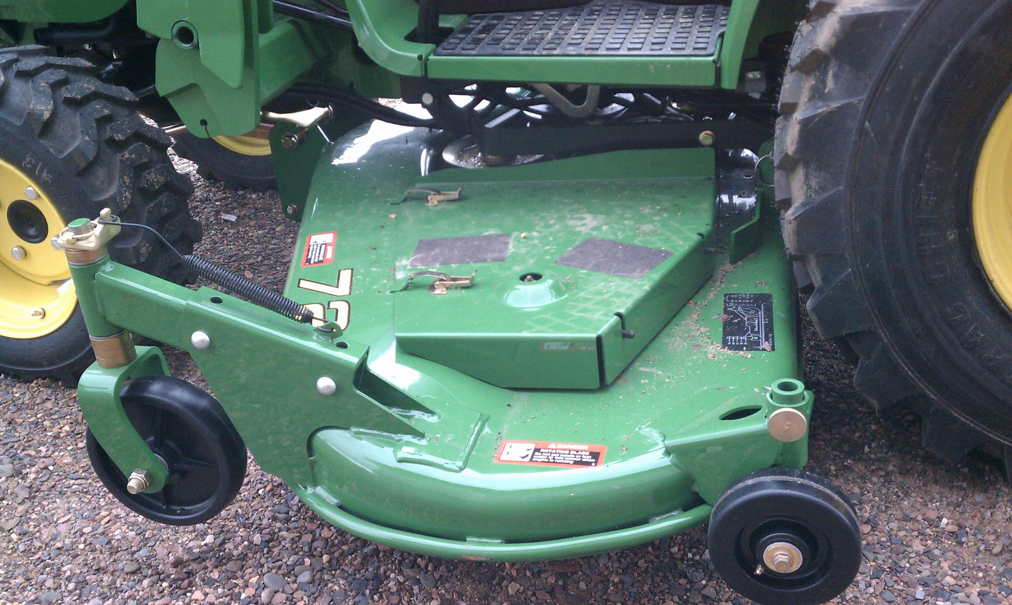

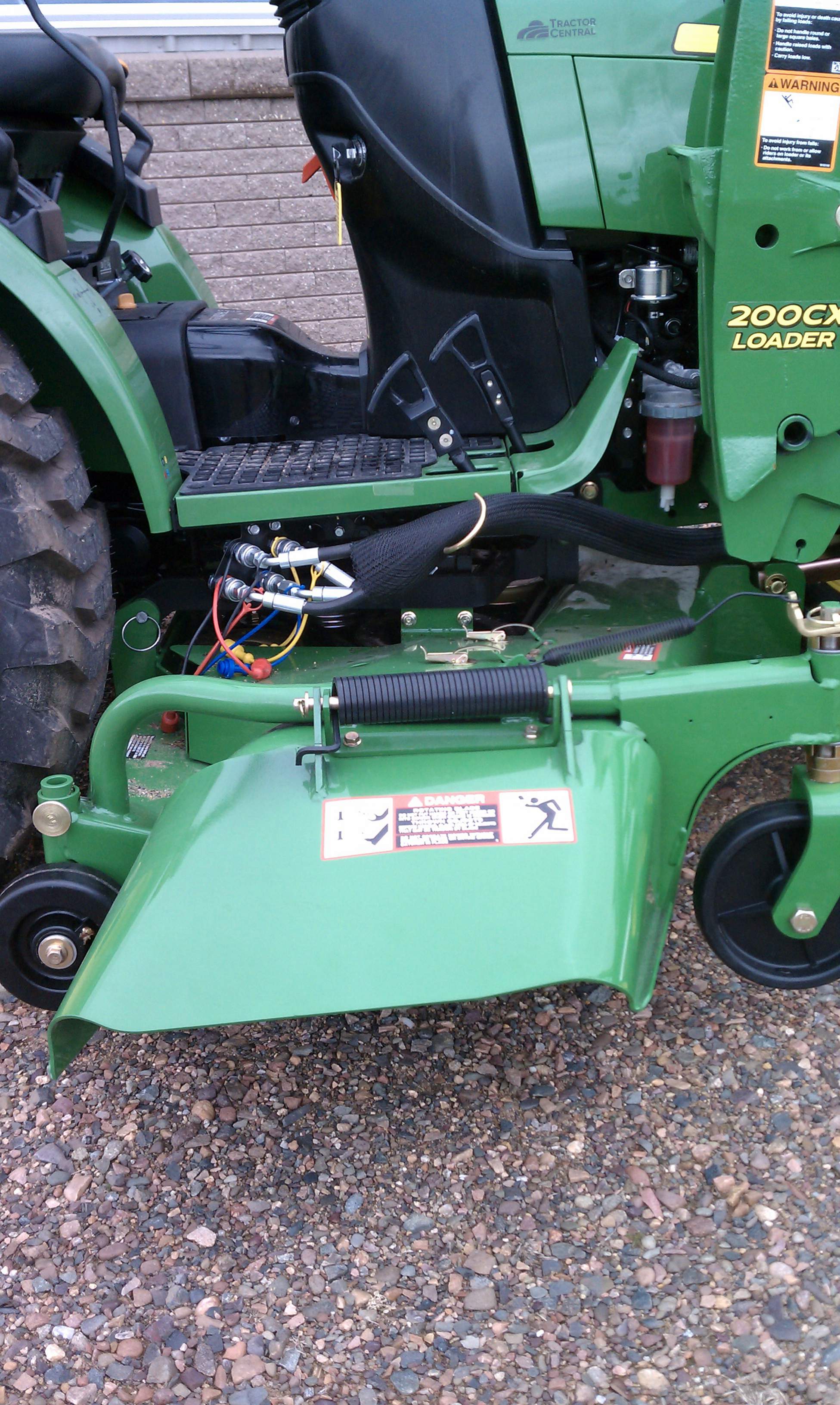

Thanks PCABE5. Looks a lot like a 62C, just heavier duty. The gage wheels are similar to the 62D. Do the rear wheels pivot 90 degrees to allow you to pull it out from under the tractor?

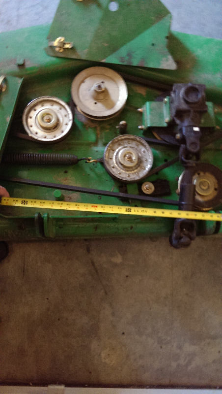

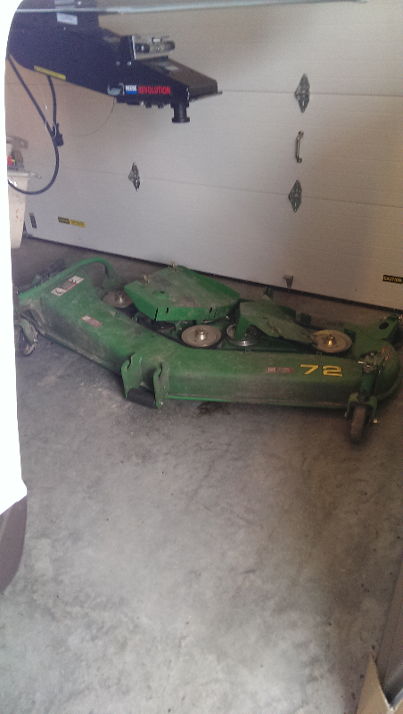

Would this one fit your needs? I don't use a MMM any more because I bought a 72" F-935 front mower at an estate sale. And, I got an 84" rear mower for field work. The extra width gives you more 'reach' around trees and bushes that the tractor wheels interfere with.
I'm a little east of mid-Michigan. I have all the brackets and covers, etc. Its in pretty good condition. Has been sitting in the back of my machinery shed for 8 years or so. I have the belt drive covers off to show the underlayment.
The wheels do pivot. The wheels are different than my old 62D.

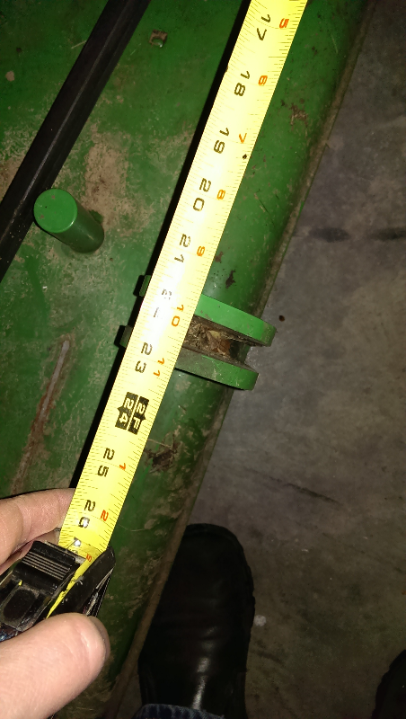

Those pics help a ton, but I'm still having some difficulty after I got the attaching parts.
Any chance you can take a measurement between the rear pickup points on the mower?
Mine seem too wide to fit with these brackets.
Thanks a bunch
I'll take some tomorrow.
Thanks a bunch
23 inches outside to outside.
