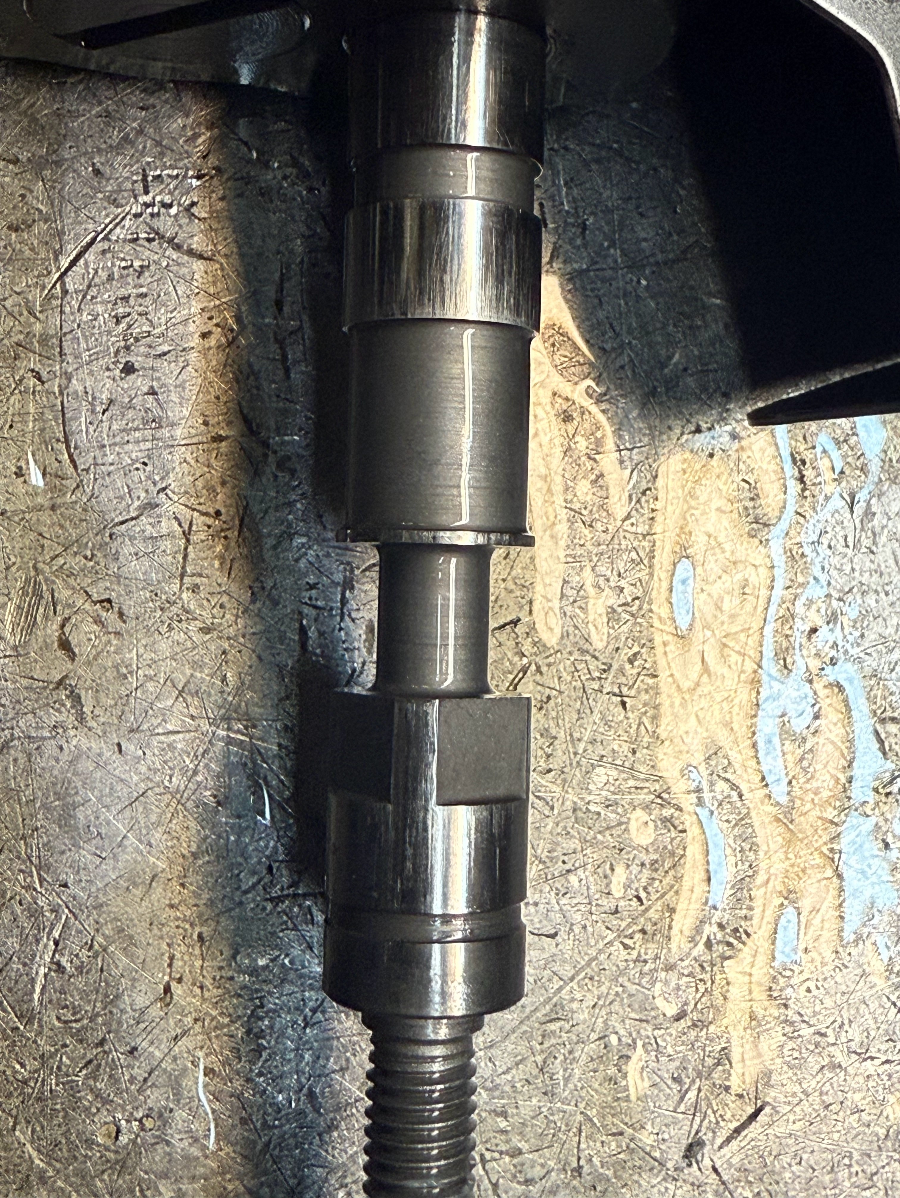

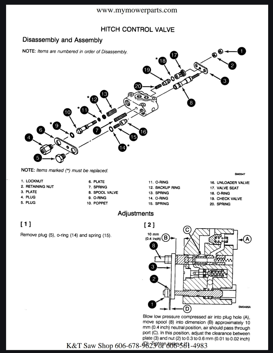

I currently have my 7260 hydraulic lift housing in the shop for a diagnosis and just got a call that the spool valve on the hitch control valve has some signs of wear. I'm looking to replace the whole hitch control valve (MA-69473-40700). Not seeing any online. Anyone have an idea of a source for parts? I greatly appreciate any advice.

The 7260 is a Mitsubishi built tractor. I am dealing with a similar issue finding parts for my 7300. The Case IH 1130 and 1140 built in 1991 and the Mahindra 3015 and 2615 built in early 2000’s are very similar tractors and parts would probably be the same. It seems like Mahindra has the best parts support. I would try your local Mahindra dealer and lookup a 2615. If all else fails call the salvage yards. I just ordered axle gears from a dismantled Case 1140. Praying everything fits.
/ 7260 Hitch Control Valve Needed #3
Cub cadet says it is discontinued. My Mitsubishi distributer says Mitsubishi lists it available, but no price. the last price i had from Mitsubishi was $1478.
