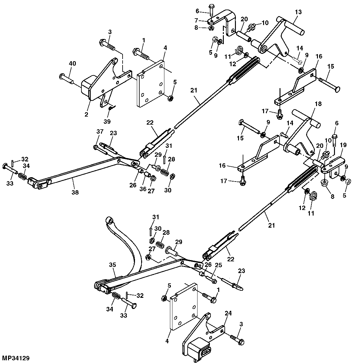

John,
I think I have misled you:eek::eek::eek:
I just looked in JD parts, and only found the rockshaft lift control. I had mistakenly ASSumed that it was set up like the 3x20 series machines.
See the picture below...I am sorry to have confused the issue. Check you PM's for my #

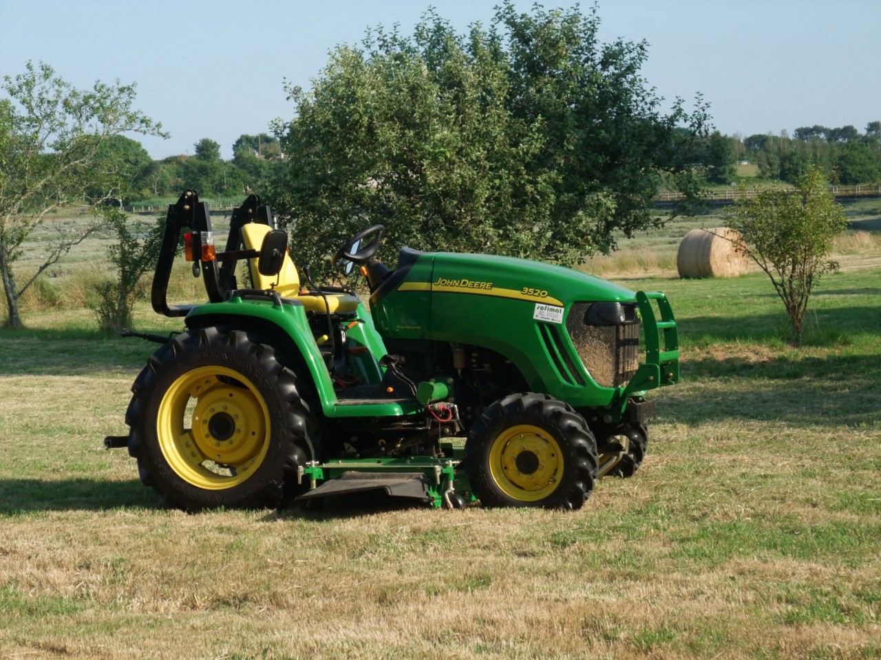

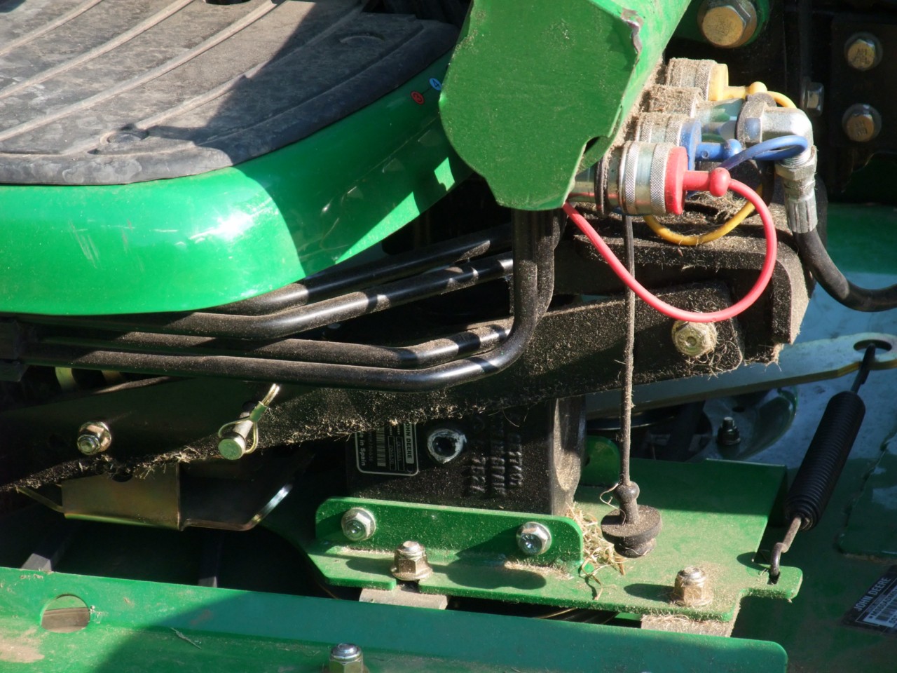

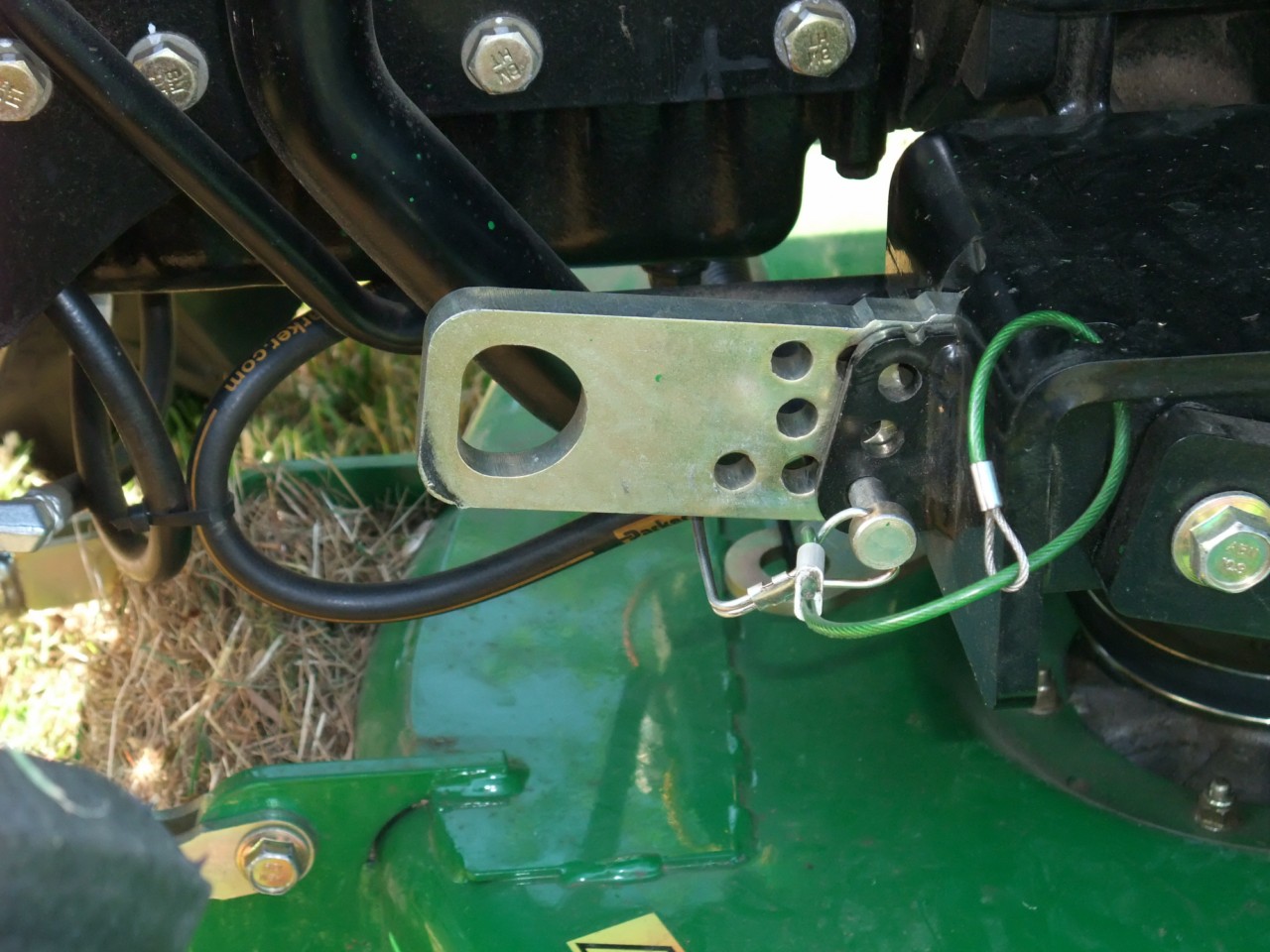

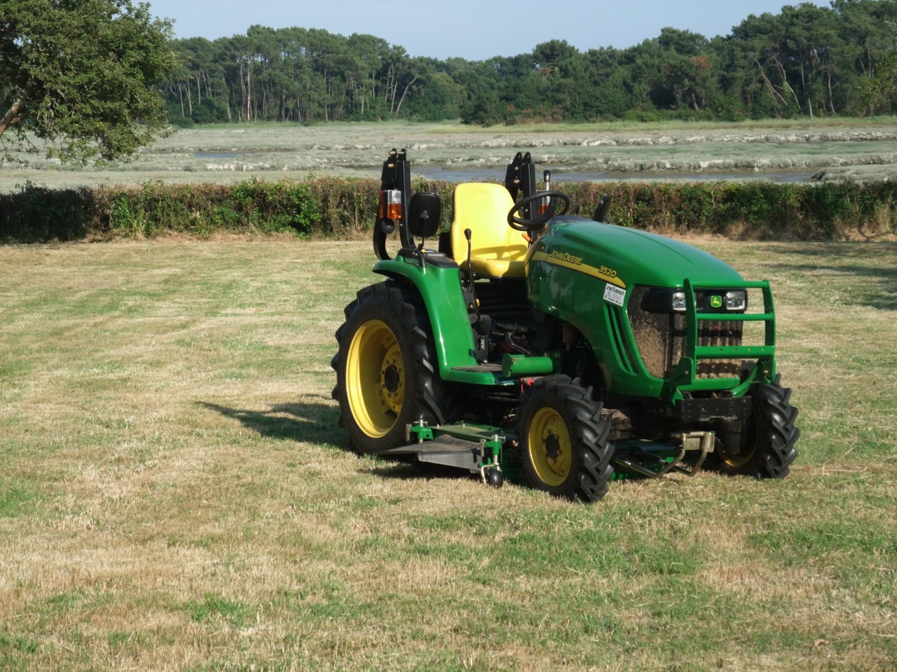

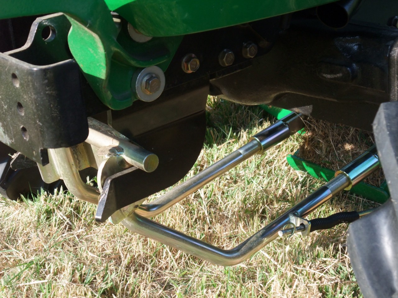

I have a JD 60" D Autoconnect MMM on my 3520 and am very happy with it in spite of a few glitches.
It is worked by one of the FEL lines (the black one on the pic), so you operate it with the FEL lever, which is quite convenient. It is a single action cylinder and works in a bizare fashion. If you move the lever in the direction corresponding to the line you used and maintain it there, the mower goes up then down, then up again and seems to cycle endlessly. That is not convenient at all.
It does bleed down, but it takes several hours and doesn't seem to happen when the engine is running.
