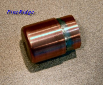

Hazmat, I know this is hard to believe, but did you read the part in my earlier post that said:
</font><font color="blue" class="small">( ...the pressure was so high my hoses actually straightened themselves out. )</font>
I fold my hoses back in a u-turn and lay them over the top of the loader arm. When I came back to my loader, the hoses were straight down on the ground. The only thing that could have caused this was internal pressure. I'd love to see what the pressure is when the loader is just sitting out in the hot sun. I have a pressure gage, so I may just rig it to a quick-connect and do the experiment. Of course, it was in the 60's and overcast/rainy when I removed the loader before and it was in the high 90's and sunny when I went to rehook the hoses. I think if the hoses had no air trapped, the fluid lock pressures could be very high. I only know the end of my quick-connect is so bradded it looks sad. I hit it really hard and it didn't budge. I'm sure it's soft metal, but that's a pretty "real world" test in my book.
I can't be the only one who has had a similar experience. Surely others in sunny/hot areas have seen similar symptoms. Or is it just me.... /forums/images/graemlins/blush.gif
