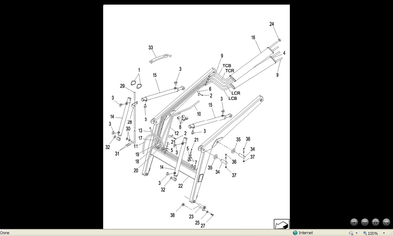

See the attached illustration from Messicks.com.
Looks like you need the following parts:
28 GUIDE
Tube
86548329
1 Needed for Job
$74.58 In Stock : 2
29 ROD
Indicator
9600334
1 Needed for Job
$27.62 In Stock : 1
30 WASHER
3/8", SAE,
87016
2 Needed for Job
$0.61 In Stock : 46
31 COTTER PIN
1/8" x 3/4",
80756
2 Needed for Job
$0.13 In Stock : 59

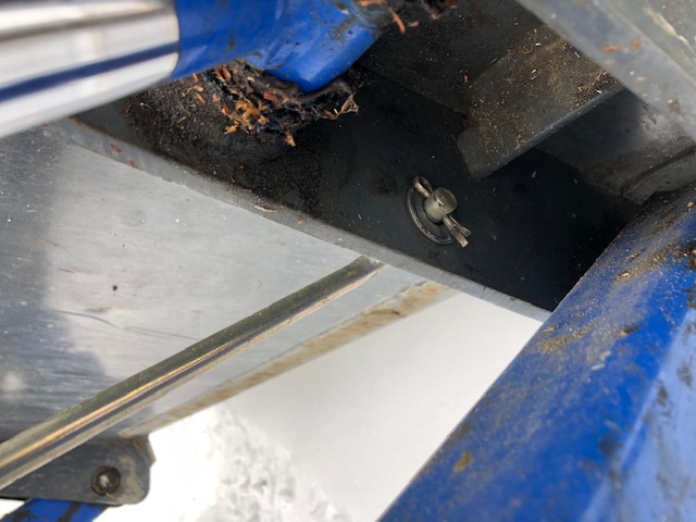

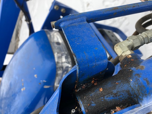

I have a 7308 as well. My tube is still there, but the rod and any attachment parts are missing. Could someone send me a picture of the rod attaching to the bucket/pin? The diagram from Messicks, and the parts diagrams I have seen all show the exploded view, but not the assembled view. I have attempted to enlarge some of the photo's I have seen online, but cannot seem to see the detail needed. Thanks, in advance.
/ 7308 loader bucket level indicator? #10
Sorry for the late reply, hopefully these are what you were looking for.
/ 7308 loader bucket level indicator? #11
That is exactly what I needed. I bought a piece of Zinc plated rod (TSC), bent it, drilled it, and installed it. I am very happy with the repair. I even left the label on the rod, as it passes through the top of the receiver at the level position. One word of warning, is to make sure the holes are far enough apart to allow a washer on each side of the bucket.
