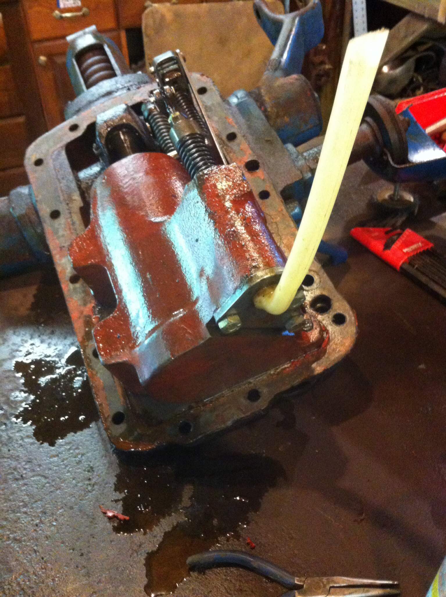

Ok still scratching my head today:( I have read all the threads here and done all they say to do... No air in the lines pump is working, but still no controls!
I started with draft down and pumped the crap out of the arms in mod position up and get some resistance but after a few minuets of pumpin it just goes easy again....
Anybody???? Please help before I grenade it:)
   / 74 Ford 3000 3 point hydraulics bleed?
Well no replies;(

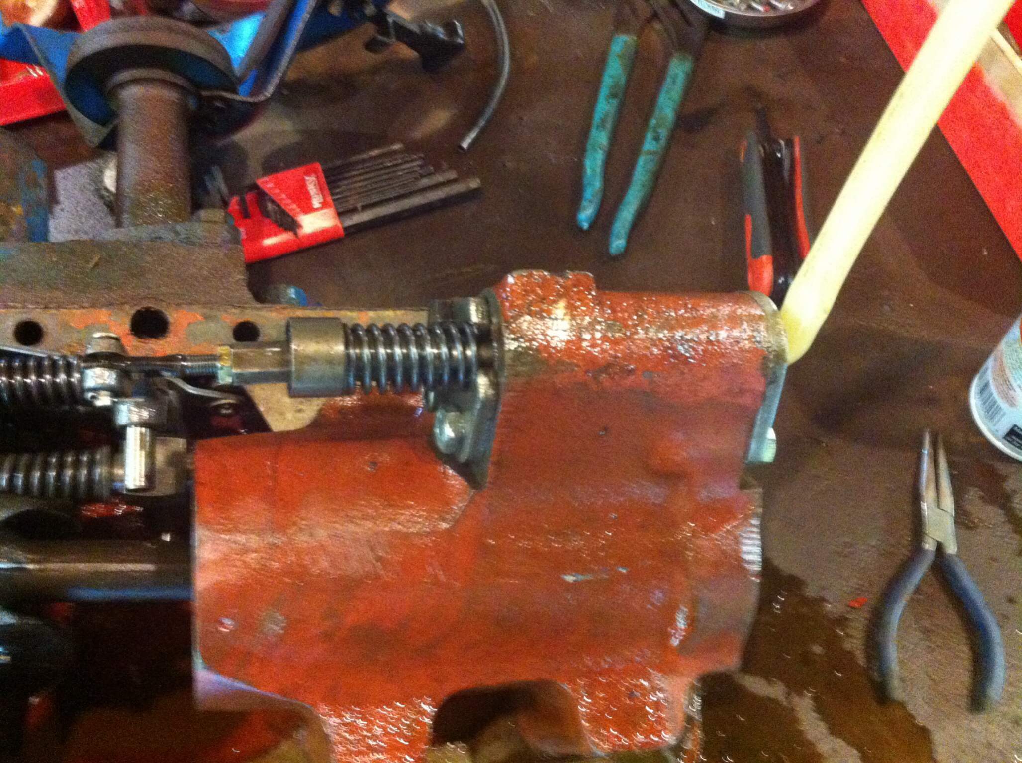

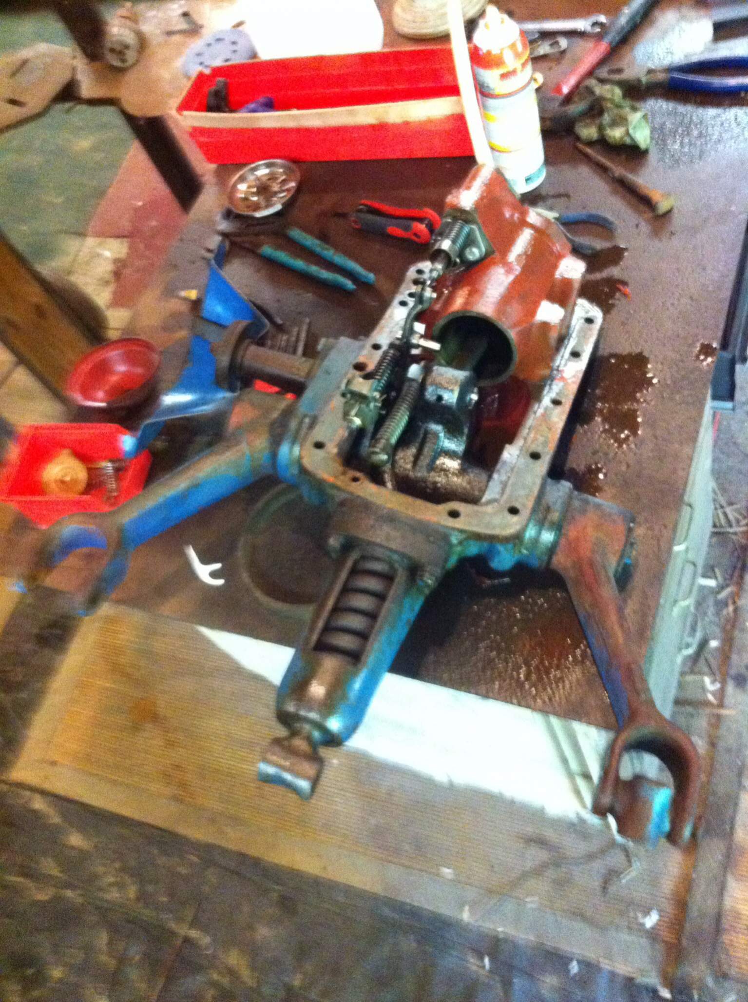

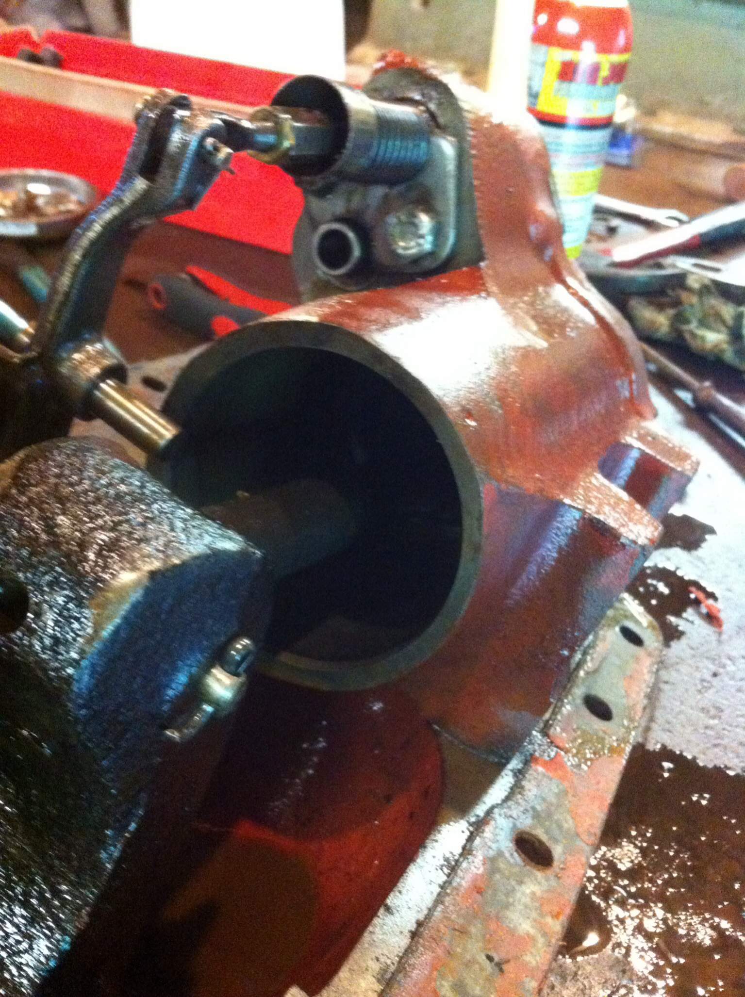

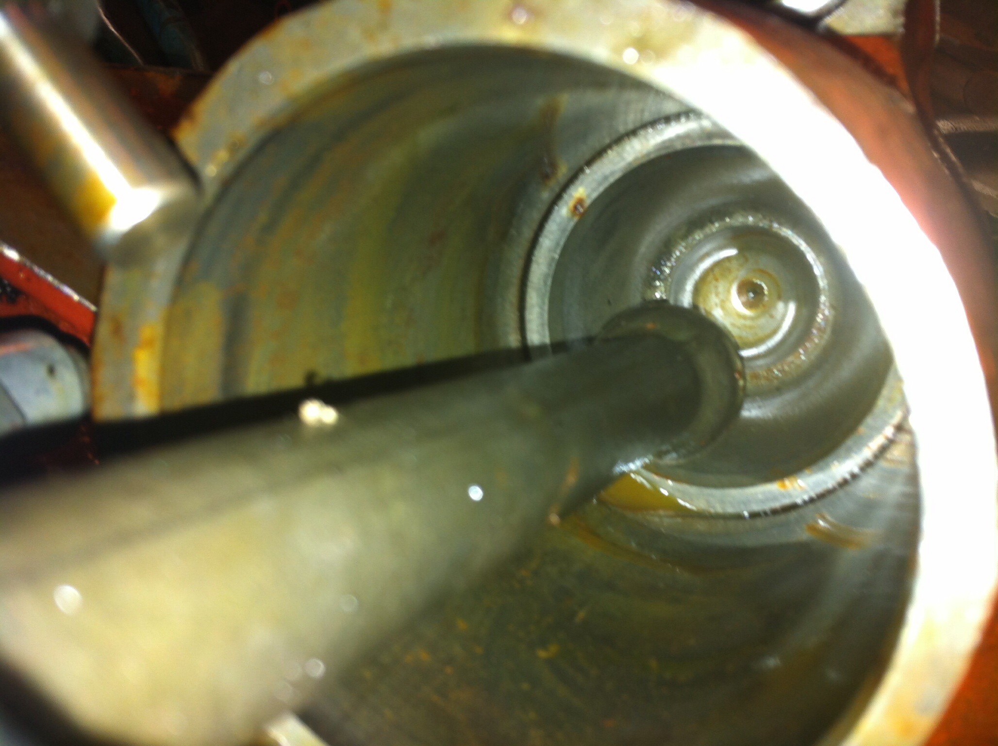

Here is pics of the pump off the tractor. And yes it is heavy! About 160lbs! I can't see any screens anywhere! I tore down the entire thing and blew air through the plastic pump hose and the piston moves freely and pushes up the arms.... Reinstalled and still no fluid is pumping through the piston! Arghhhhhhhh anyone out there???
   / 74 Ford 3000 3 point hydraulics bleed? #6
pumping hte arms does nada. there is no solid connection from arms to the lift piston.
had this thread been int he old ford section.. I'd have seen it sooner.
Determine if you have hyd flow. pull the plug ont he 3x5 cover on the hyd top cover and crank tractor being ready to shut down quick. if you get oil at that port.. you have pump flow.
now from there. if you have pump flow but now 3pt. check the unloade and backpressure valves. the unlaoder can stick and dump oil to the sump. if BP valve is dead.. there is nothing to activate unloader.
   / 74 Ford 3000 3 point hydraulics bleed? #7
by the way.. that ain't the PUMP.. the pump is up there in front of your left knee on the engine!
that's the lift cyl and valve body on the underside of the lift cover.
i sugest someone actually get a service manual if you are going to continue to work on this thing.!
