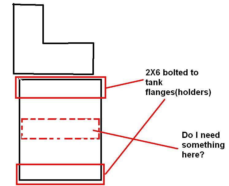

Well I picked up a 75 gallon "L shaped" tank from murdoch's locally here and I'd like to put some treated 2x6's along the bottom/outside edges so I can get under the tank with either straps or forks to lift it on/off the pickup.
Here is a link to the tank I got:
Better Built Steel Transfer Tank — 75 Gallon Capacity, L-Shaped, Model# 29224162 | Fuel Transfer + Storage Tanks | Northern Tool + Equipment
My question is.. do I need to add a 2x4 or 2x6 along the middle of the tank bottom to support it? and if so... what is best way to attach something in middle...??? Liquid nails?

How about bolting it to a cut down pallet, that way it's supported along the entire bottom.
/ 75 Gallon "L shaped" transfer tank... #4
How about running the middle 2x6 perpendicular to form an 'H' shaped frame?
that would negate the OP's original intent of getting straps or forks under it which was the whole reason to put 2x's under it in the first place (to create a gap)
/ 75 Gallon "L shaped" transfer tank... #5
What does the mounting kit for this tank look like? That might give you/us some clues about how many attachment points you have available on the bottom of the tank, and/or how much of the tank *must* be supported. I'm guessing the tank expects almost continuous support, typical of sitting on a pickup box floor.

/ 75 Gallon "L shaped" transfer tank... #6
I think it would be best to ask the tank manufacturer rather than peaple here who have never seen what you have...75 gallons of fuel is a lot of weight. You will also be tranfering all that weight to only two small places in the truck bed also...
/ 75 Gallon "L shaped" transfer tank... #7
My tank has atachment location on each side. Also a large note saying only use when tank is empty. The only strengh is the thickness of metal and when empty can move without any other means. Why are you wanting to unload a filled tank. price of pump is not that expensive.

Hey Ken,
My thoughts are to fill the tank up in the pickup... and then bring the tank home and put it in the shead (on wheel dollys) so I can move it around. I don't want to haul all that extra weight around all the time. I just want to have some reserve fuel on hand if/when the S*&# hits the fan with our economy. Then If I need to bug out I can lift the tank back in the pickup and have enought fuel to get to our family safe spot w/o having to rely on any fuel stops.
And of coarse have the plenty of fule for the tractor at home is a nice bonus as well.
Hope for the best.... but prepare for the worst.
Phill

Hey Rus,
I'll post some actual pic's of the tank... but I'm sure you're not saying my "most excellent" paint shop delux drawing above is sub-standard!!!! I'm shocked! <grin>
Phill
Hey MNJ, Schmism hit it on the head. I want to keep an open channel so I can get something under there (Insert "underwear" joke here).
I may end up welding a cradle for the tank that has a steal lattice bottom to give it max support.. and with six legs under it?
Oops on my part for reading this stuff late at night. Anyway, a lattice like your second design would work, or if you want to stick with wood, how about the following using your original design as a basis.
1. Cut two 2x6's for the longitudinal frame members.
2. Cut one 2x6 the same width as the frame will be, and mount it on top of the first 2x6's forming an 'H' as I suggested before.
3. Cut four 2x6's the same length as the wood in item 1 minus 5.5". Place these in front of and behind the member from item 2. This will bring the frame equal in height all the way around, yet allow forks to come in from behind the tank.
4. Cut four 2x6's 5.5" long and mount on the underside of the members from item 1 at the ends; thereby forming feet. These feet will allow side entry of the forks and lessen the amount of wood in contact with the ground.
If I didn't describe this idea worth a darn, let me know and I'll whip up a quick sketch.
