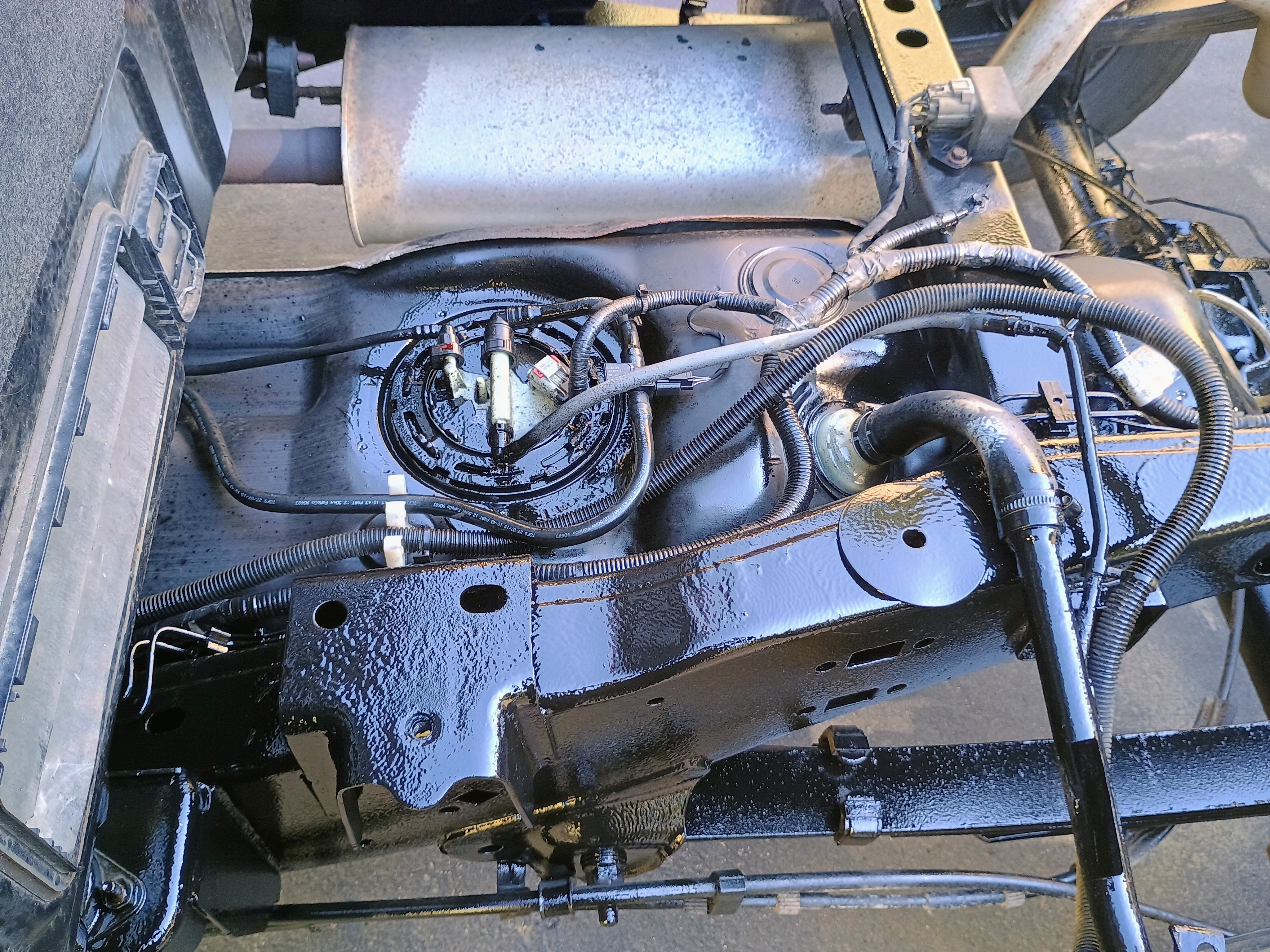

Well yall, after pulling the toolbox, draining a little more fuel via the fuel cannister WIF drain/running the lift pump, I ended up dropping the tank :cautious: It was so darn hot yesterday that I wimped out and opted to lay under the truck in the shade to work. After all that info and mentally prepping...
I have the new pump in and the tank is technically ready to be reinstalled. Before I do I'm going to review a tank vent mod and I need to address the two leaking fuel lines from the tank to fuel canister. Much easier while the tank is down.

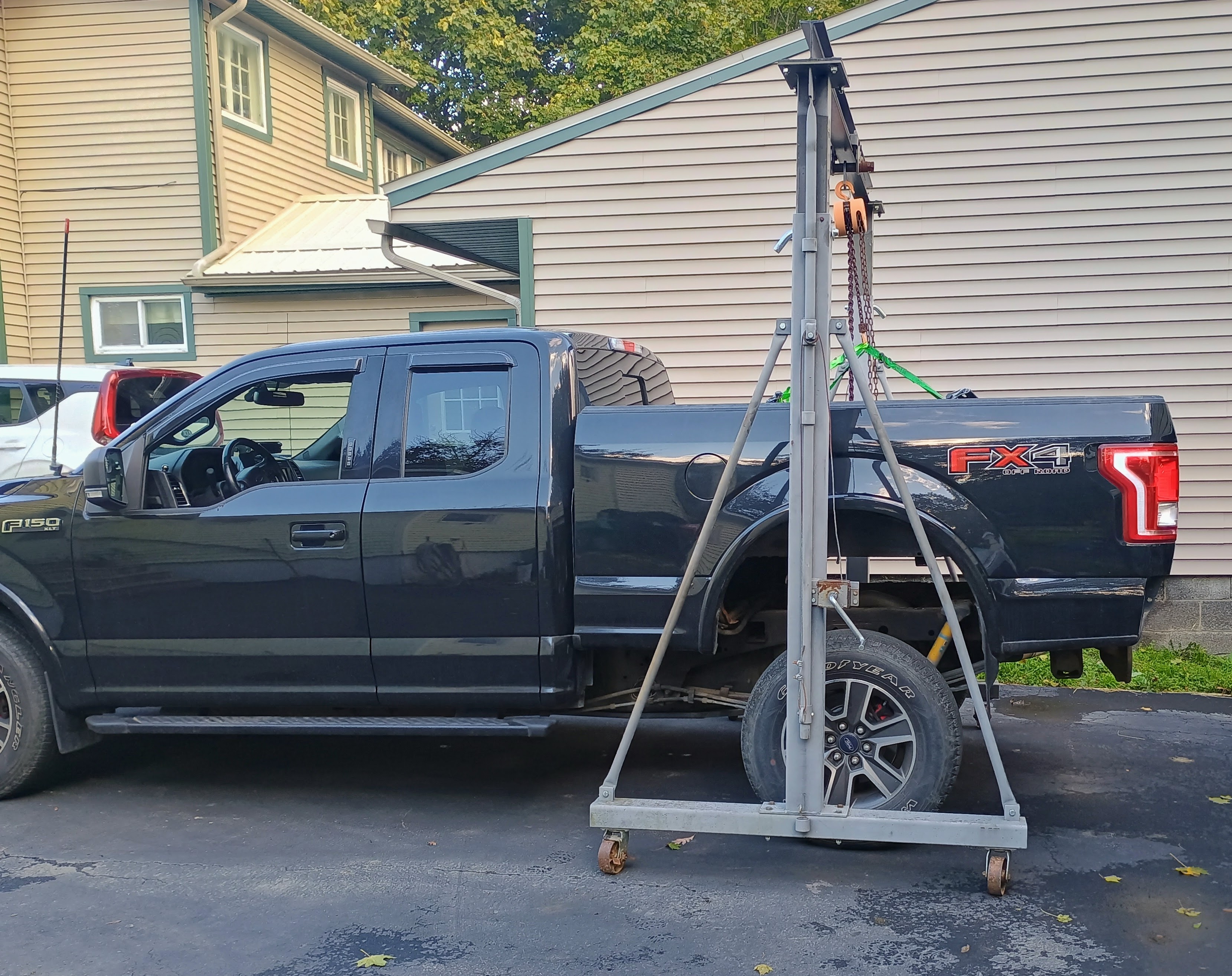

I found that if you lift it from one central point that you don't have good control. it is very likely that you will end up scratching something badly.
I noticed in videos that the lifting methods seemed to vary on results. Of course it's hard to tell how much operator skill it is vs method. I'm guessing the central lifting point being less controllable due to the tension being applied in a diagonal direction vs a more vertical way?

I gantry lift would definitely have helped me. Out here on this property I have started to consider building one to help. I seem to have a lot of more heavy unloading situations now.

Just get under there and drop the tank. Cutting bolts, breaking this, scratching the bed - not worth it. Siphon out fuel, Undo two or four strap bolts, and lower it by hand or on a jack with plywood and/or 2x4s.

That's what I ended up doing yesterday Drained about 8 gallons too. The 34gal tank has two strap bolts actually, which one gave a hint of fight but relented with the 27" breaker bar. The threads had a bit of gunked up residue, I think either some gear oil or atf that had combined with general dirt/dust. I didn't pb blast a whole lot. I can't stand the smell of it. I used both floor jacks I had, wasn't that heavy to get down. Instead of weight I ran into height issue scooting the tank out while still on the jack. So I wiggled the tank and the jack out one at a time. My nerf bar mount off the body mount is just low enough it interfered. Nothing some finagling didn't fix.
