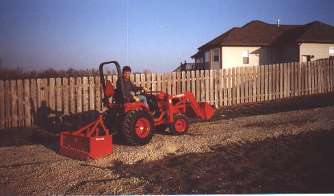

Actually used in the proper method a boxblade will spread and then smooth gravel very nicely. It can also be used to recontour the drive and redistribute the gravel from thick to thin areas by varying the technique used. I use my flexible tine harrow in a similar method to the way you use your rake which is what the guy was using the chainlink fence for---or was it really a flex harro?. I drag the tine harrow and it fluffs up the gravel and smooths it and makes all the ruts and dips dissappear. It is often enough without any help from my rear blade or boxblade. When I built the pad around my new well I spread piles of gravel with the FEL and then smoothed and pushed them together with the boxblade, same with my road--it will certainly spread gravel but it requires technique and PC helps a lot. Yes, I think a landscape rake is an excellent tool for smoothing and maintaining a drive--sounds like a must have!
I still do not think you need loaded tires but lot's of guys do that, I think momentarily shifting to 4WD or using the diff lock should be better on the lawn if you can cut thois area in straight lines.
Pic is of the gravel pad around my well --the gravel smoothed and contoured using primarily the box.

Let me re-phrase. I don't feel comfortable using a box scraper to spread gravel. Too dangerous.

MrP, what do you feel is dangerous about spreading gravel with a BB? Are you referring to the (likely) possibility of "overscraping" if it is not adjusted correctly? Or are you afraid of dropping the blade on your toe while you adjust the tilt with the top link/w3tcompact/icons/tongue.gif. There are potential risks of using the boxblade, but most of these are to the surface and material you are working with, as opposed to yourself or those around you/w3tcompact/icons/wink.gif

The box blades I have used for my L3410 are heavy with cutting blades on back of the box that cut in both forward and revers. If I am trying to spread gravel on my driveway, I think it it just to easy to scarf the driveway when I don't want to. I would much rather use the rake to get the gravel where I want it, then use my chain link fence to smoothe it even.
As far as the danger, the danger is ME operating something with a cutting blade on my driveway (definately a recipe for distruction).
And it would hurt if I dropped a BB on my toe. /w3tcompact/icons/shocked.gif
