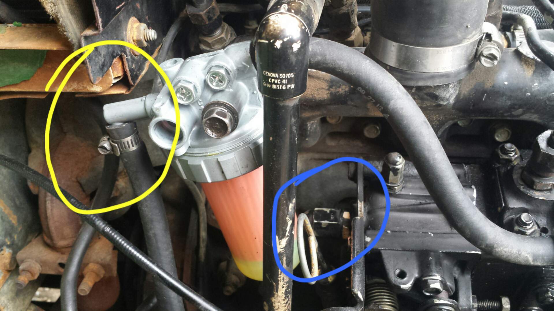

One reservation I had on the governor screw, was I didnt see any witness marks on the nut, so I wasnt sure if some had already messed with it. I just didnt want to adjust it further and cause any issues. Is it possible to over adjust it?
Also, my fuel filter housing is in the way of the acorn nut because I had to mount it canted a little because of how close the corner of the battery tray is to the elbow fitting. I believe thats how the elbow broke free on the original housing. Almost like there should be a spacer between the filter housing and the mounting plate that bolts to the engine. Doesnt seem like theres enough clearance once the engine is running and vibrating. Ill attach a pic to better explain. I circled the in yellow the area that doesnt have enough clearance. Blue is the acorn nut that deals with the governor adjustment correct?

I'm guessing, but I'd say no one has adjusted it before.. Yes,, the item circled in blue is the correct place.. Underneath the cap nut is the hollow threaded piece.. Actually the cap nut screws onto this threaded piece that is adjusted...
Could it be adjusted too much ?,,, well I don't know.. However, if you think your governor is not responding good enough,,, one turn counter clockwise at a time should be safe, and that's the same or less than anyone else has done... If for some reason you got a negative response,,, it could easily be turned back in where you started from...
I did have my governor apart, at the time I didn't mess with this screw because I didn't know about it..
It's actually just a limit bumper that limits the pump arm movement in the open (more fuel) direction of movement...
It's not something where a bunch of springs and balls are going to fly apart, or the governor break or quit working... The worst could happen I'm thinking would be too much fuel...
When I turned mine out, the only thing I worried about was if it was out too far, the cap nut might bottom out and not seal against the lock nut when I put it back on... (More threads sticking out that the length of the cap nut). I guess that could happen,, but it didn't in my case..
Like you said before,,, you can wait and see how the tractor is running first.. But if it's obviously underpowered and not trying to pick up the load,, (they act like they don't have a governor and they should act just like your lawn mower engine) then I'd look into making the adjustment...
