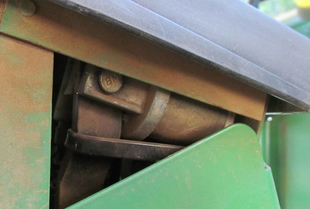

Heavy Duty Tie Wrap for the win. :)
   / 755 PTO problem #14
JD855
Good close-up pic and am sure I see what is the tie wrap and it apparently functions as an aid to the magnet, but wonder if a panned-out shot would be helpful to have a better idea just what the tie-wrap is doing and where located.. tks.

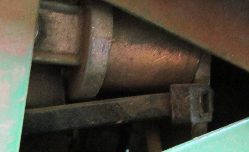

   / 755 PTO problem #15
JD855
Use at your own risk!
The lever is independent of the linkage that operates the pto. The tie wrap in the picture is wrapped around the lever and linkage with the magnet on it. It effectively bypasses the safety system and makes the pto engagement full manual. Mine was like this when I bought it and I never fixed it. You will need to unbolt the side panel to see and work on it better.
This is the other end of the tie with the lever pushed forward.
And when I say heavy duty tie wrap I mean the fat 120+ lb type. Not the standard 50 lb.
Another rig/patch I had to do on mine was the PTO linkage moved so freely it would vibrate down and disengage the PTO. I loosened the pivot bolt, wrapped a couple turns of teflon stem packing around it, and re tightened the bolt. This increased the resistance on the lever without binding it.
