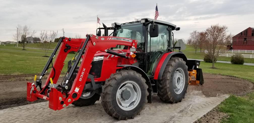

I have a Massey Ferguson 4707 with DOC only. It's a full flow DOC, designed to last lifetime of engine and can never plug up. It was a major deciding factor in my purchase. Love the tractor after 2 years. No issues. 20190407_175344.jpg
