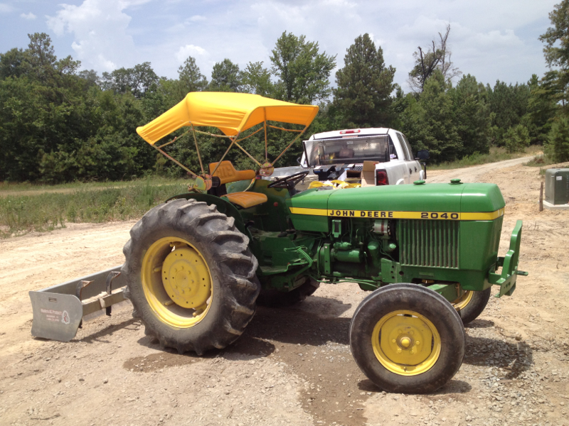

Thanks Russ. I didn't realize the different models would change the look that much, I'm glad you brought that to my attention. Looks do make a difference to me and my little Deere is in really good shape for a '76 model so I don't want to Frankenstein it lol. I have found pictures of all the loaders but the 520 online and there is a 175 for sale fairly close by.
It seems most of the used loaders are around 3500$ or so, and most nice ones are 500+miles away. It does make buying a new 521 seem like a better option. Best I can remember, the JD dealer told me it was around $5000+, I only paid 4500 for the tractor...! I'll call tomorrow to get a price on one, but I may still just take my time and try to locate a nice used one. If anyone runs across a deal on a gently used one please let me know.
Btw I did add something to my tractor today. The TSC sunshade is not quite the new cab tractor I've been dreaming of, but it sure is better than nothing with these 100F days!

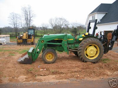

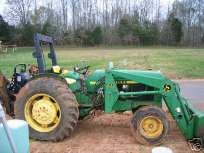

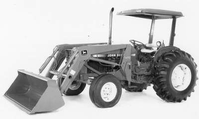

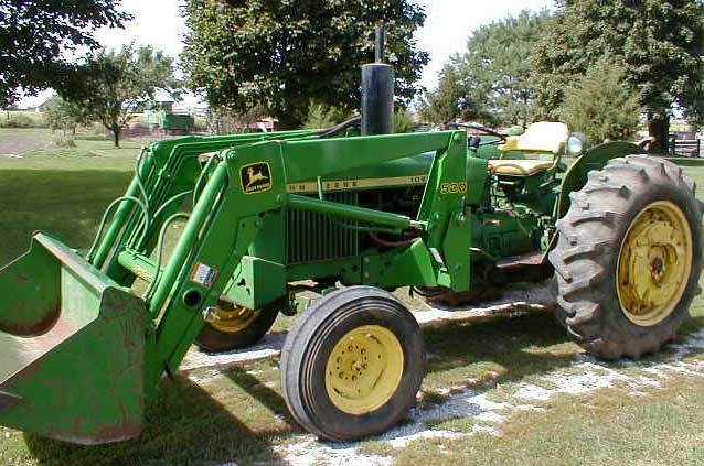

Wow!!! That is a great looking 2040. I like the sunshade. That is all the cab a tractor really needs, right??? Sounds like you did pretty well buying it. I think that series of JD's were one of the nicest they built. Sure are heavy duty and will likely last forever. Here are a few 520 loader pictures I had along with a 175 snuck in. I have a few more 175 pictures around also if you like. I also saw some 143 loader pictures. I forgot about those. They were just a single curl cylinder like some of the older loaders and some of the TLB's like the 310. From looking at the pictures I think I like all of them and would be happy with any of them if you can get a decent deal on one that is in good shape. Happy loader hunting and they are out there if you are patient, otherwise a new 521 may not be a bad alternative either.

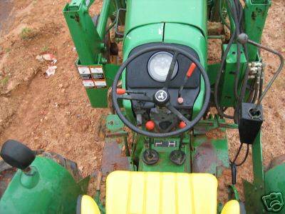

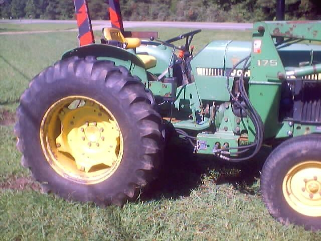

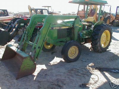

The 175 was the first picture. It did not show much of the loader, just the valve and joystick JD was using. I agree the 175 loader would be a good match as long as the look is appealing to dntfxr. Here are a few pictures of the 175 I had around. I think the 175 still needs 4 bolts pulled to remove the loader, similar to the 145 and 146 (6 I believe on these two). Is that correct? I think the other change for the 521 was the single plate mast loader frame on the tractor (for lack of better term) that I think is supposed to help visibility.
6b51_1.jpgJD2150w175loaderi.jpgJD2150w175loader.jpg2040w521Loaderiii.jpg2040w521Loaderii.jpg2040w521Loaderi.jpg2040w521Loader.jpg71_1.jpg01_1_b.jpg5ae3_1.jpg06_1_b.jpgJD2150w175loaderii.jpg
Well here are some more pic's. From left to right: 521, 175, 175, 521, 521, 521, 521, 520, 143, 521 520, 175. Sorry the order is all mixed up. Someday I will take time to figure out the managing attachments better.
