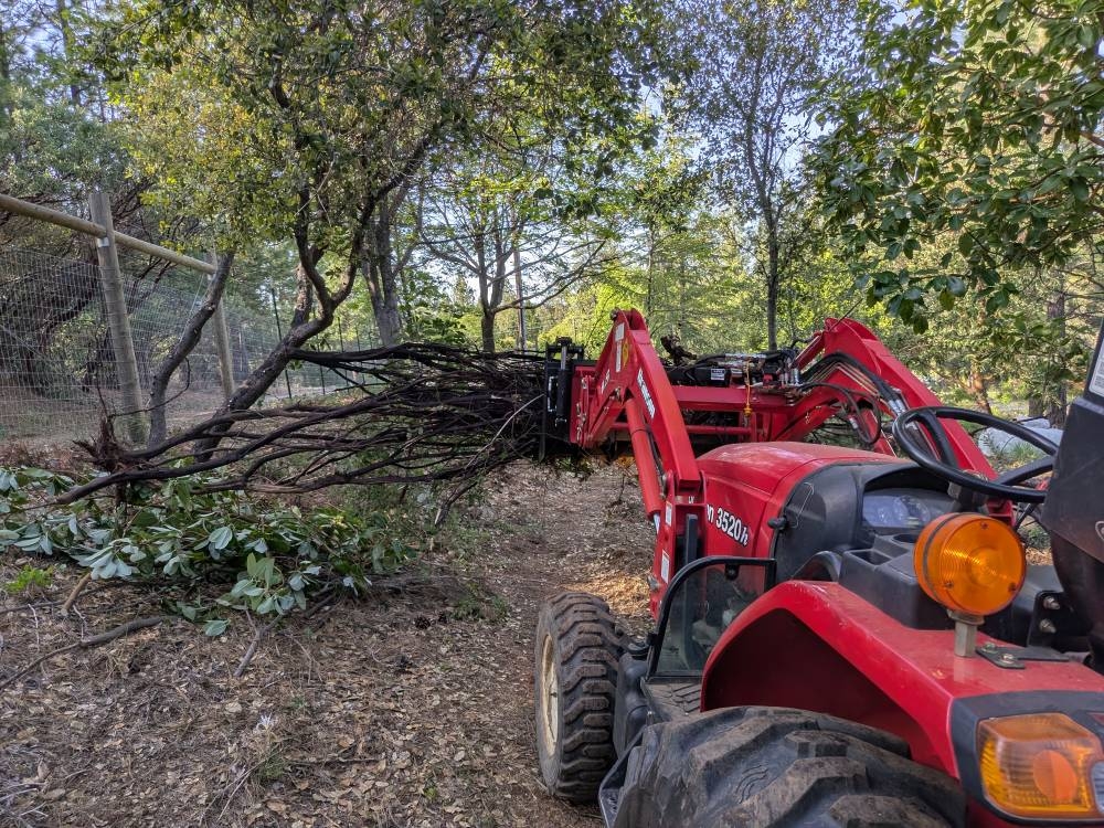

Most of my work till now has been me cutting trees, setting aside oak trunk wood and branches 2-3"+ (small stuff gets chunked for grilling) and making piles of greens and small branches. I change my minimum "keep for later" size when I have a lot of smalls cached.
I've typically made hand piles about 6-8' long, 5' tall and deep, reasonably easy to fork and a good amount to drop on a burn pile (which is officially supposed to be 4x4' but you really can't make a good hot burning pile so small).
With the grapple I'm able to grab one of my piles and compress the !$#@ out of it by closing the grapple, then drop it on another pile and grab it too, and one time already I've done this to take three piles at once to my burn spot, though I did lose a couple small branches from the mouth.
Still it's an efficiency win just from fewer trips, plus losing much less - and I haven't started making grapple-specific piles yet. Having to fork piles requires that they be more approachable and not be somewhere that the tractor will have any side slope as you can lose much of a load off of forks that way; of course much of the land I've been clearing is on a hill and unfortunately I do have to access it somewhat on a side slope.
Till now I've dragged slash to a nearby area with a fork-tolerable slope to make piles, but the grapple will be able to grab them on the slope and not dump them.
Obligatory grapple shot:

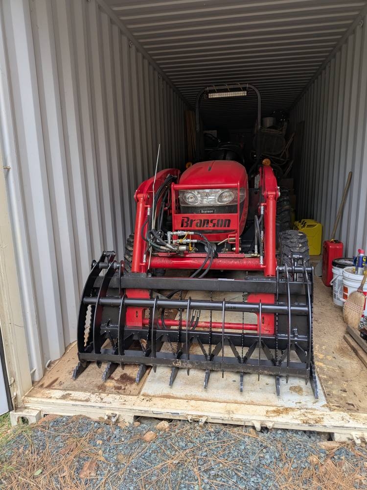

Tractor fits fine in the container with the grapple not adding much length; there are storage racks in the second half and an unfortunate number of bikes in the middle that need to be hung up somehow - also the backhoe is on the tractor in this pic - doesn't fit with the bucket on and definitely not with forks sticking forward.

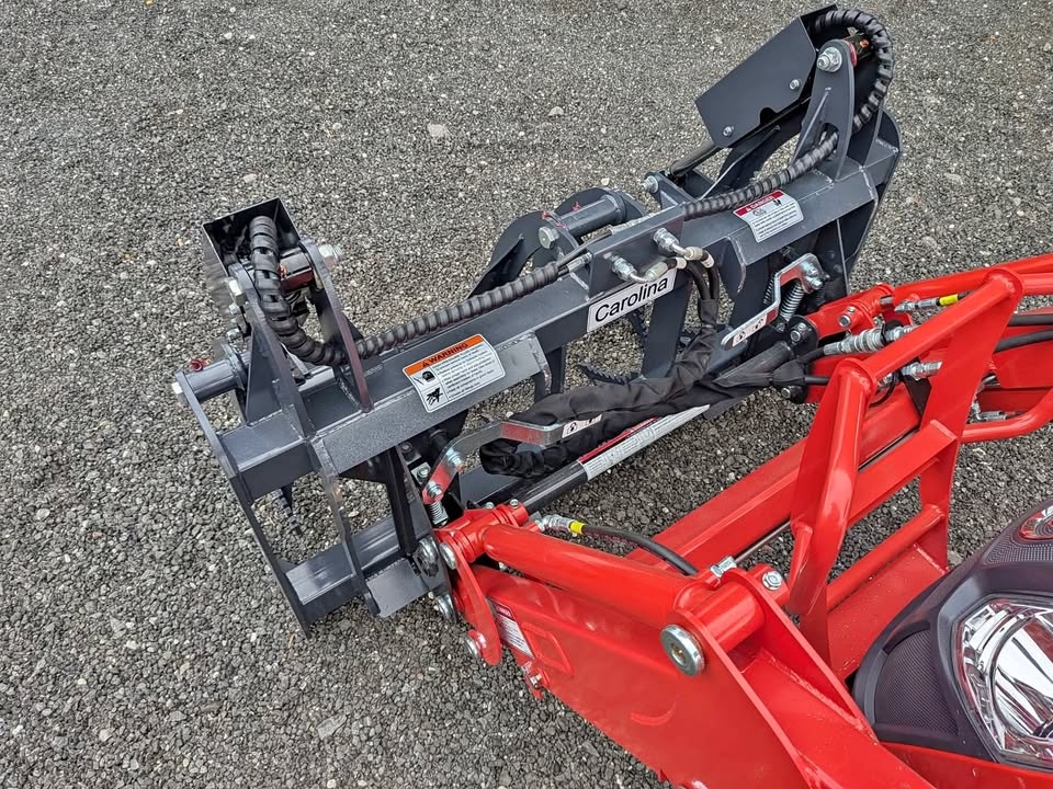

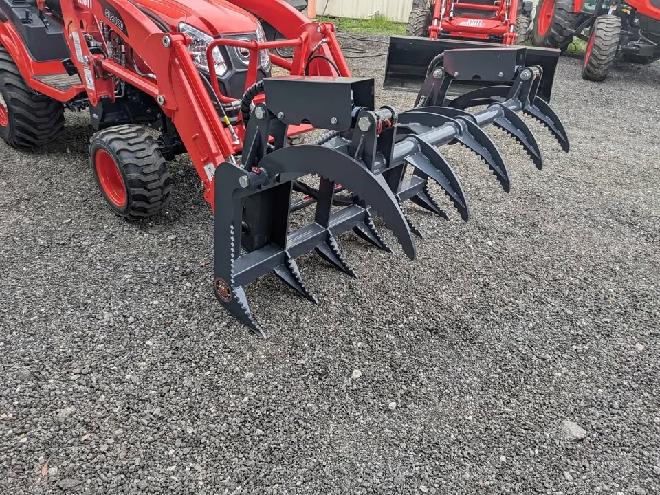

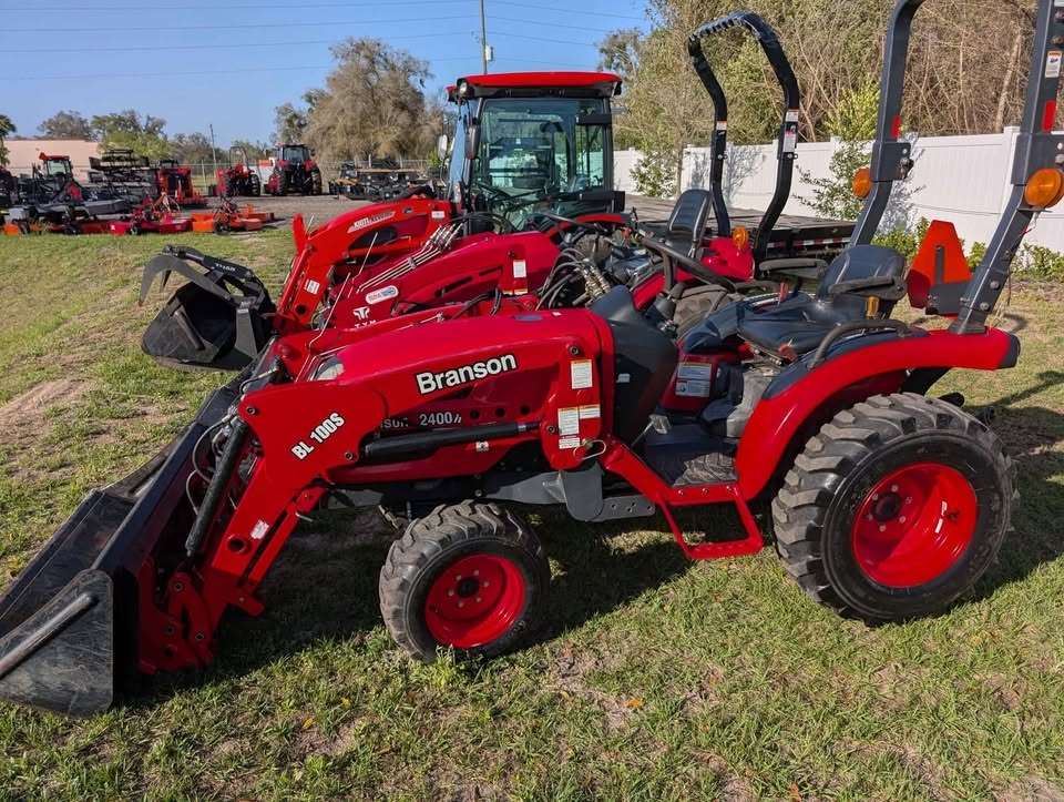

Weight is my concern with BL100S looks like 1300lb capacity.
Catawba 54" does not have any lower teeth, but weighs 212lbs, $2200
Catawba 55" nice teeth 2-6" cylinders grease fittings but weighs 300lbs, $2600
RBG3-54 nice teeth weights 238lbs but cylinders are on top. $2500
Dealer told me to go with Carolina 54" 1-lid with 2- cylinders on top weighs 250lbs,$1500
Just home owner work with veins, scrubs few trees and small logs.
Are cylinders on top that bad?

Not that bad.
It's just a matter of potential exposure to damage.
At least with them on top, you can see what could possibly get at them.
If you're just doing brush/light wood grappling, I don't see an issue. If you were doing building demolition, it could be a concern, but then a small tractor would be a bigger concern. Personally I'm not too hip on how exposed the hoses look, but $1k+ can buy a lot of hoses. The RBG3 also has fairly exposed hoses; looks like the Catawba's are tucked behind pretty nicely.
$1500 would be a tough price to pass up IMO, also the carolina's lower "teeth" seem well braced.
If you're in the Catawba free shipping region though I'm seeing a price of $1965 for their 54 and without paying for shipping. I have questions about their "teeth" not having any bracing though.

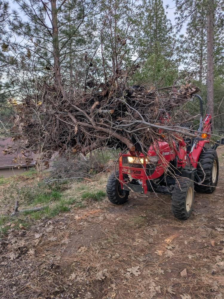

Update
I just used the grapple non-stop for a couple hours picking up stuff I had cut or knocked over in my jungle area - the primary purpose I bought it for.
Before I started, I swapped the hydraulic connectors as when I first got it, my tractor had two F connectors and the grapple a F and a M; I randomly chose one connector on the tractor to change to M (this is my first and currently only front loader hydraulic attachment) and I wasn't very comfortable with the choice, it felt awkward in use.
After the swap, using the grapple via the "third function" diverter setup felt immediately natural, completely intuitive. It's like night and day compared to the previous direction. I've found that I can curl the grapple back and close it mostly at the same time as if feathering the two functions by rapid-fire hitting and releasing the button.
I'm really appreciating the size of the grapple - I would want no wider (it's 56") and it wouldn't bother me a bit to have it a little narrower.
Maneuverability in my partially cleared jungle is better with the grapple than with a bucket - not only is it ten inches narrower but when closed it doesn't stick out as far.
Picking up brush and small trees etc doesn't require any sort of counterweight, particularly with filled tires; a large load might weigh a couple hundred pounds at the most.
