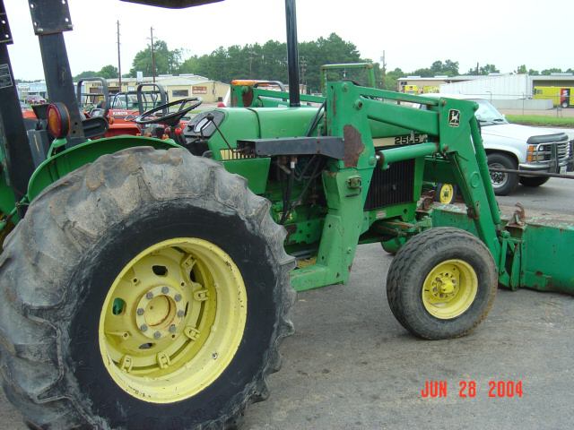

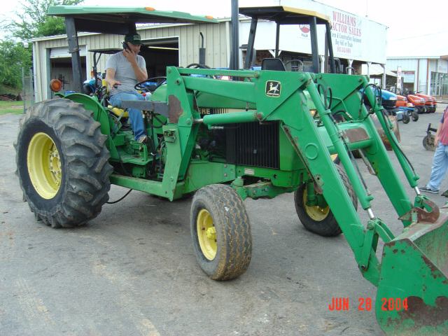

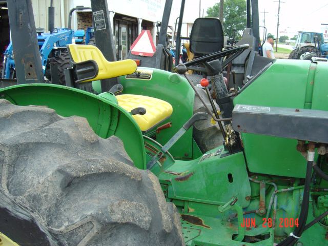

The 175 loader in LA looks pretty nice in the pictures. Like you said, a little faded, but the bucket looks straight and overall it appears in really nice shape. The 522 sounds like a great deal. Might be worth calling the dealer on that and see what it includes. If it does not have the correct loader brackets for the 2040 and does not include the spool valve and joystick, the price may not be as good as it appears. If the price does include these or for a small amount more, see if the dealer deals with any trucking companies that could ship it for a reasonable price. If not check this link for hauling schedules. I used a hauler thru these listings before and had good luck. As far as the 175 hydraulics, it appears the valve and joystick are there. Find out from the dealer if it was on as open or closed hydraulic tractor. If it was a closed, then negotiate in the correct valve plug to switch back to open. The mount of the joystick is similar to what you would see on the 145 and 146 loaders where the valve stays on the loader. Only two lines to tie into your hydraulics and you would be all set. Here are a few pictures of what the valve setup would look like. You could also change this setup to a cable operated joystick like some of the pictures I posted before if you like that better. Most everything you would need could be purchased from supluscenter.com
