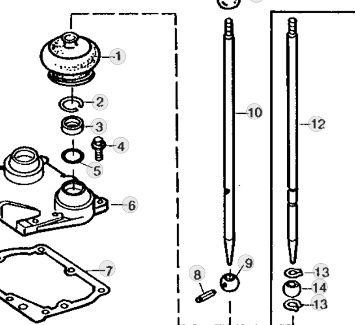

Working on getting the covers off the trans and rockshaft. How do I get the ring snap off L4035T? They don稚 have any holes for pliers. Looks like its supposed to compress to come out but now sure how that痴 supposed to be done.
   / '76 Deere 2040 Restoration #19
May I ask why you desire to remove snap ring(KEY 2 PN L4035T). Is gear shift lever broken? I'll add that snap ring will be a PITA to remove IMHO. I'm unaware of any cover on rockshaft housing except at the very frt that gear shift levers protrude through.

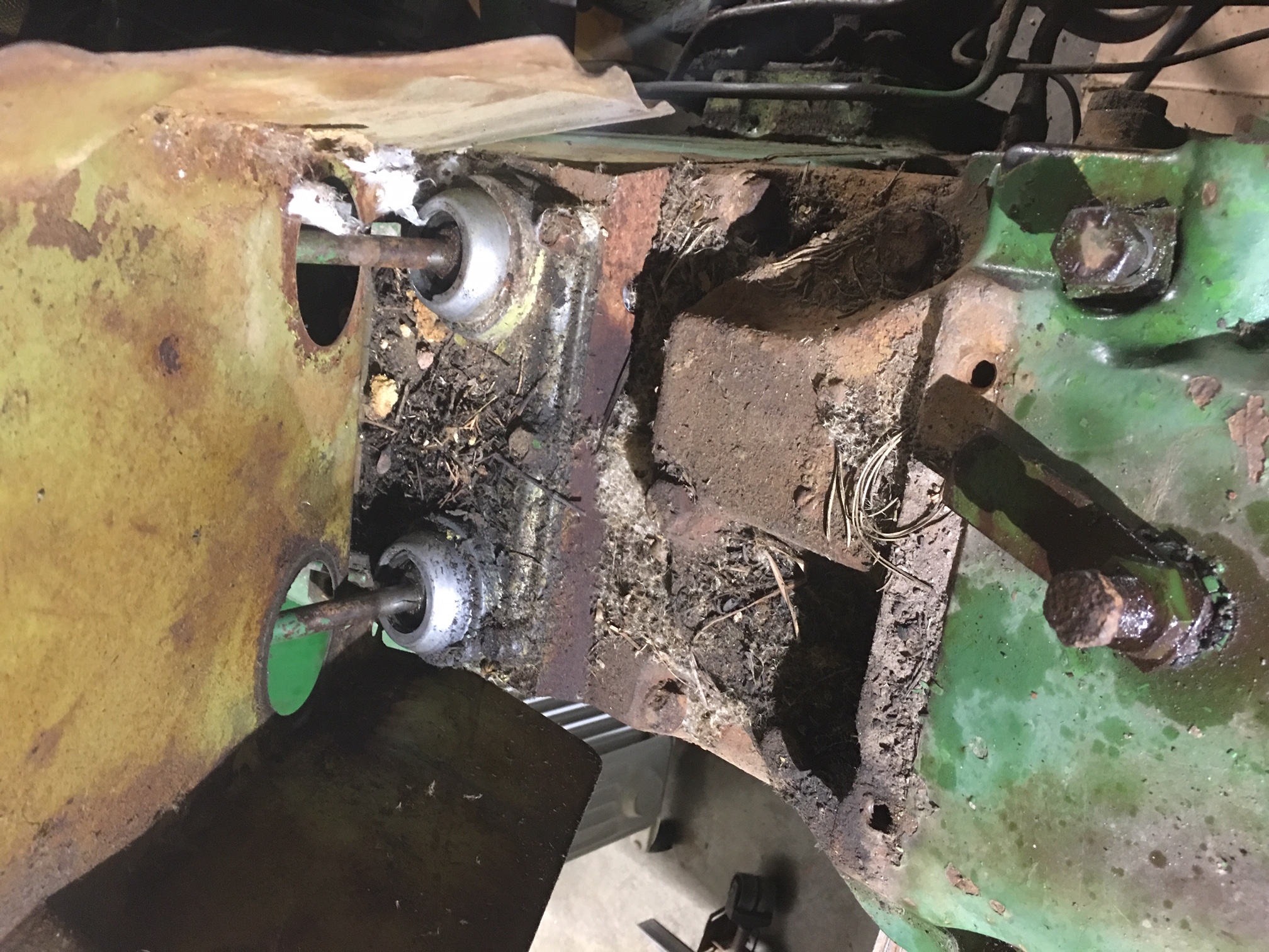

I am having difficulty getting the knobs off the levers to remove the boots so I can get the cover off (cover needs some re-shaping). Boots are not in bad shape as I replaced them a few years ago. Still may replace them anyway because they sat outside for a while during my move south. I figured I'd get the levers off so I could submerge the ends to loosen them up. Loud and clear on the rings being a PITA to remove, so I'll go with some heat on the lever. I have some high temp insulation that goes on woodstoves that I can protect the knobs from toasting. I'll just have to be sure not to heat up the lever too much and damage them from the inside.
Thought I could get a pipe wrench on the lever but it would just slip each time. I guess the levers are hardened because the teeth on the wrench could not get a bite at all.
