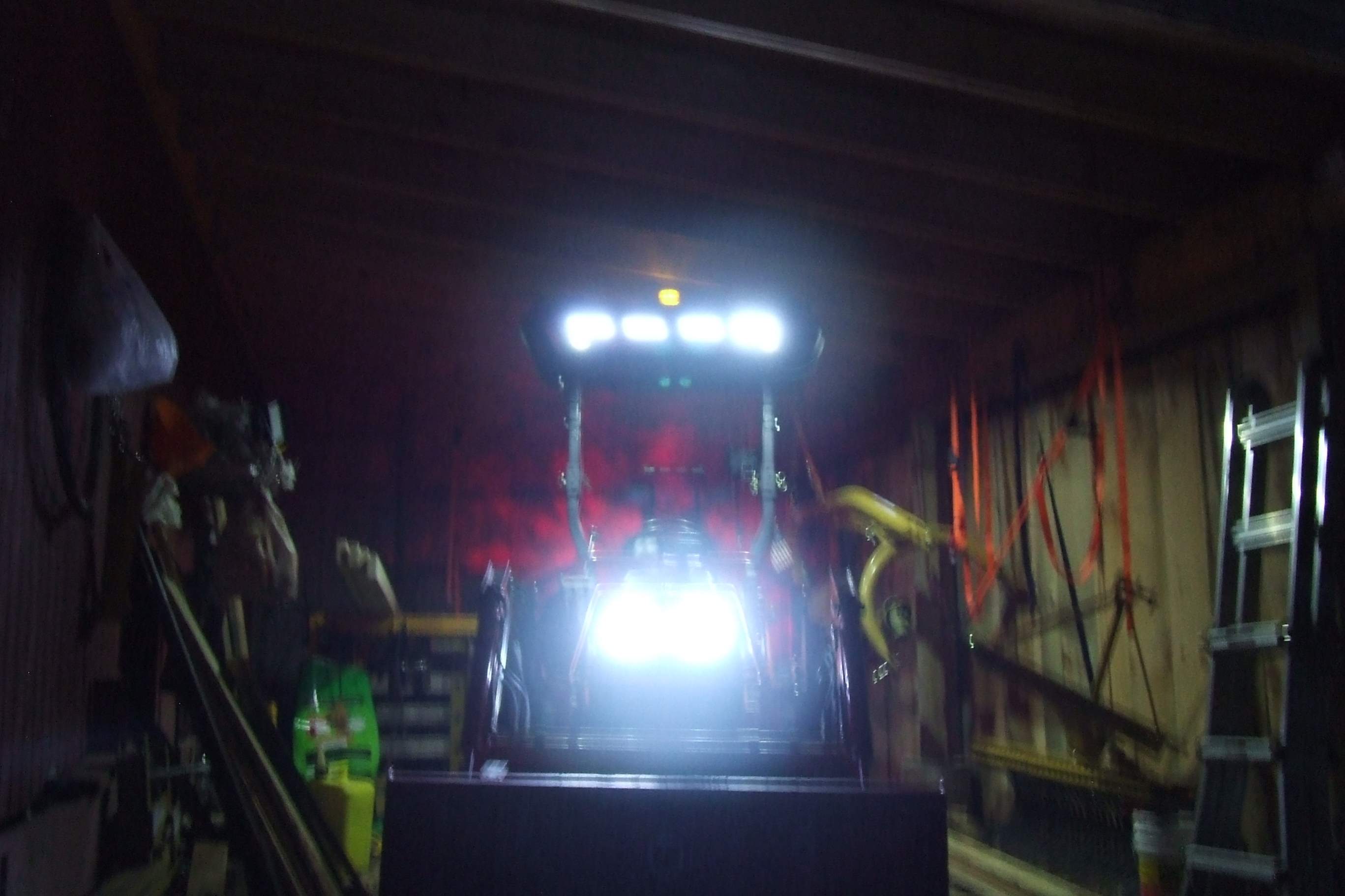

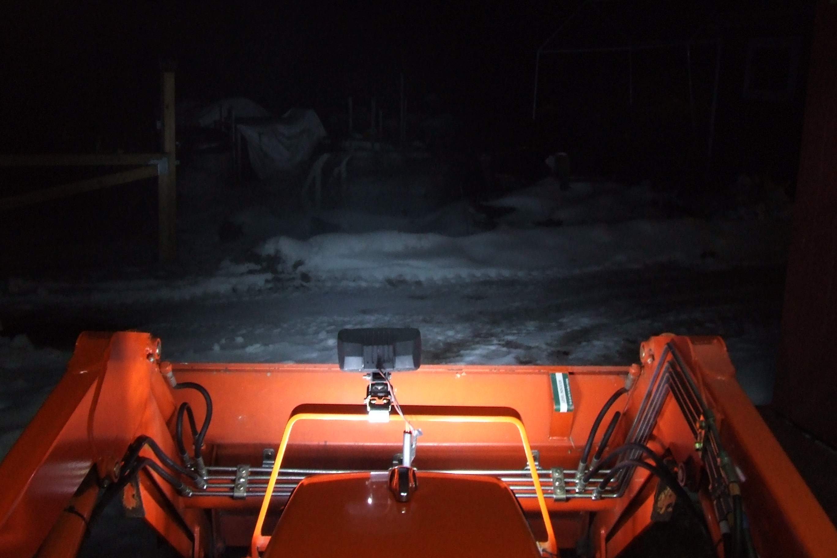

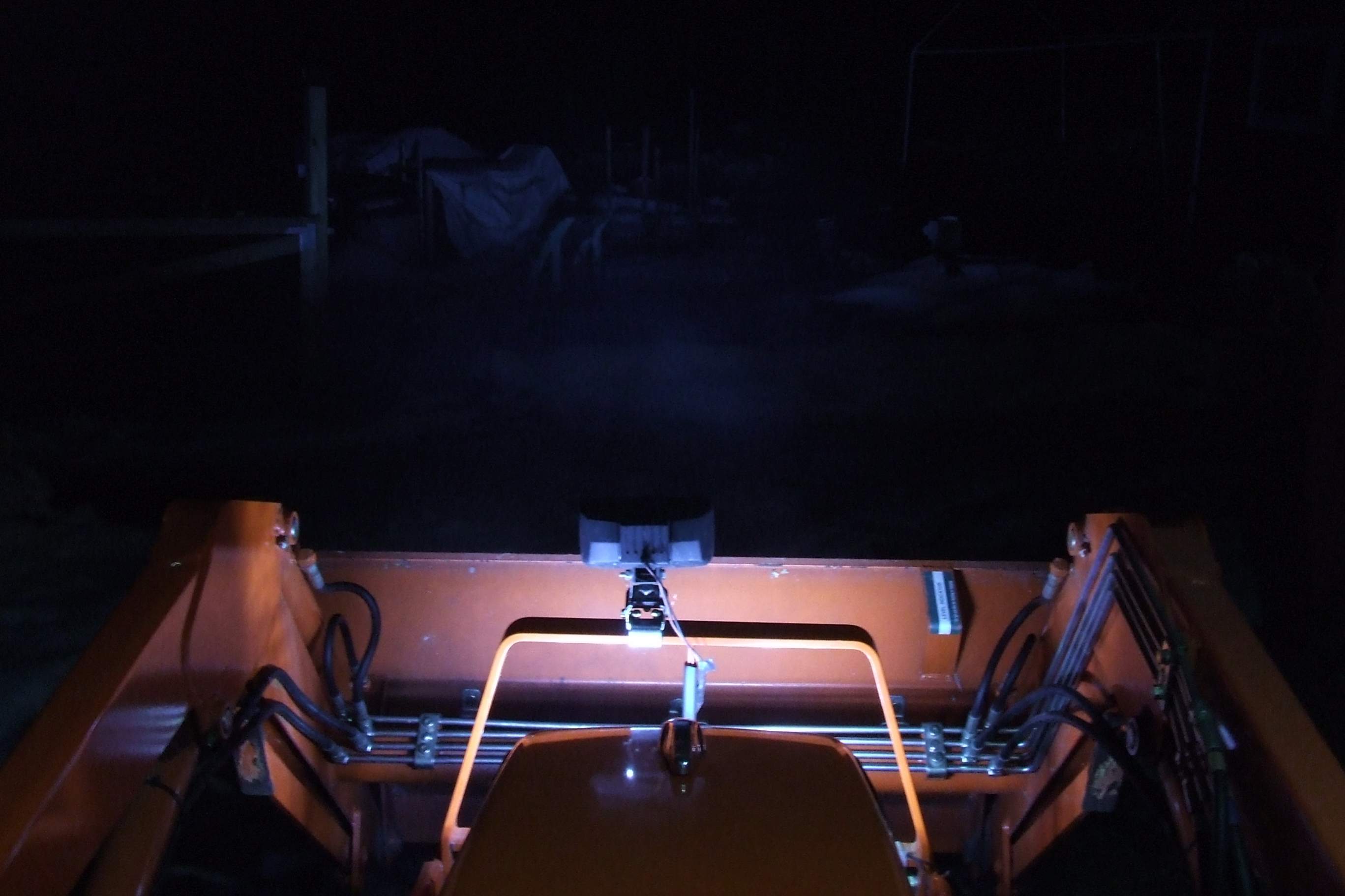

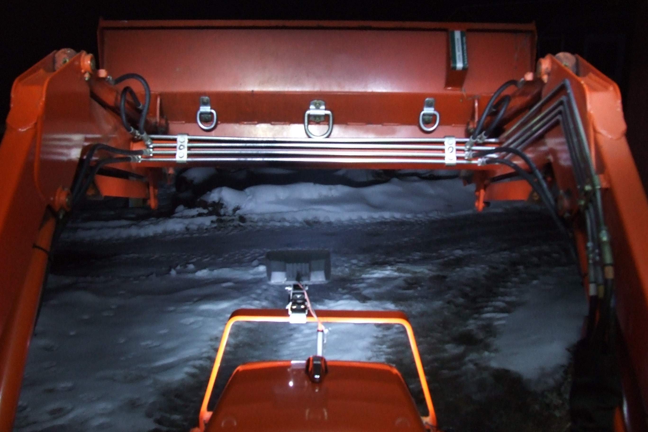

Here's some pictures with the loader in different positions and a from-the-front shot. Sorry for the blurry stuff. There's no flash on these shots so you get the best representation of the lights.
As you can see, the loader area fills in nicely even if you've got the headlights covered. If you're working up high with the loader, like dumping into your pickup truck, you can see the loader clearly without a lot of glare. Since the loader lights are under the edge of the canopy, they don't get affected by rain or snow.
I need to add some specific lighting to my 3 point hitch area next.

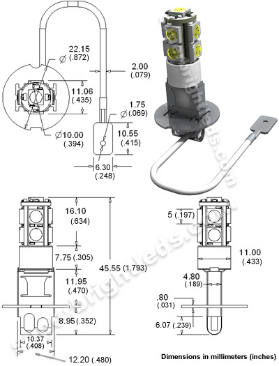

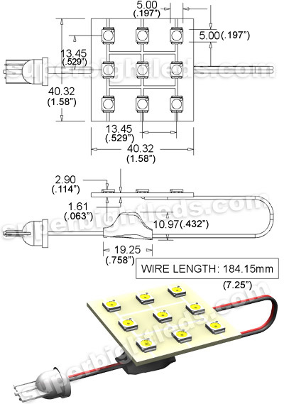

I used the 1156-x18-T bulbs in the headlights.
The HP-WHP9 gets used in my back facing worklight. It's made to fit standard H-3 55 watt halogens. They're not as bright, but they use .065 amps instead of 4.6 amps like the halogens do. I might put a couple more of those in front.
Finally, the "cab" lights (T10-PCB-WHP9) are on a little printed circuit board. These are bright enough to light up the ground on either side of the tractor as well. I put one in each of the overhead lights.
