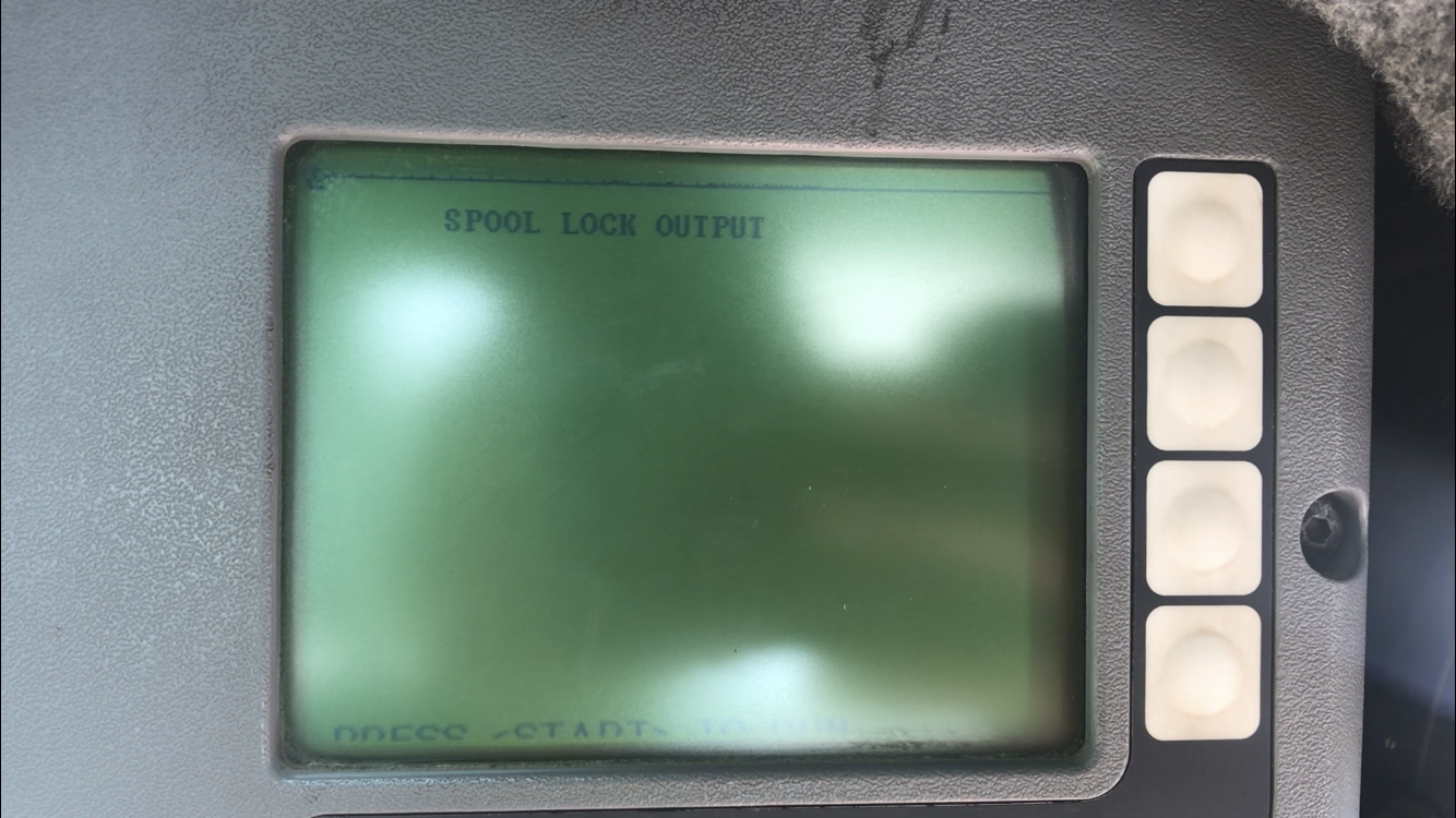

Hi there,
ive got a 773G skid, that I’ve owned since new and all of sudden it’s developed what I think is an electrical issue.
When I go to start it, I press the yellow “Run/Enter” button, the gauges and BICS screen all come to life, but only for a couple of seconds, literally. As it shuts down, the top of the BICS screen quickly flashes “Spool Lock Output” and the hour meter says “Replay.”
I can, on the odd occasion, get the machine to start, but it’ll shut down within a few seconds.
Has anyone ever encountered this before?
I’m the original owner of this machine and it has 1700 hrs. on it.

Update:
So, last night I decided to try and do some more troubleshooting.
The first few times I tried to start the machine (pressing the yellow “Run/Enter” button), it simply stayed on for 2-3 seconds the. **** down.
I noticed that if I held the “Start” button, the starter would turn over until the machine shut down (2-3 secs).
After a few more times, the machine stayed on, the glow plugs cycled and she started and ran for about 20 minutes. In that time I did a bit of work with it, like pushing back soil piles, loaded down sand into my trailer, and just regular skid steer stuff.
She ran great until I shut it off myself (machine did not shut down on its own).
Shortly after I shut it down, the problem came back. I decided to shuffle my weight around on the seat while trying to turn it on; Sometimes it worked, sometimes not.
At this point I’m thinking there’s a loose/corroded connection somewhere? I pulled the BICS module out and put some contact cleaner on those connections, but they seems clean already.
Is there a connection under the seat that could be related! Or under cab, below the seat,
the machine is showing no codes.
thanks for reading my update! 👍

Hi, we have extensive experience in Bobcat repairs and I definitely know where your problem is. Your problem is in the right panel defect. This panel model often has this defect. 70% of the panels that come to us for repair have this problem.
Try the following:
1. Press and hold the "RUN" and notice what errors appear on the display on the left panel (I think you will get 34-04).
2. Press and hold the "LIGHTS" button on the left panel, notice what you get on the right panel (I think you will get B> D).
You can send the panel to us for repair.
Contact us and we will solve your problem. Repair time one day.

Thanks for the reply.
Interesting information.
Can the “Press & Hold” tests be performed with the machine off? I’m unable to get the machine to stay on for any long than a couple of seconds.
