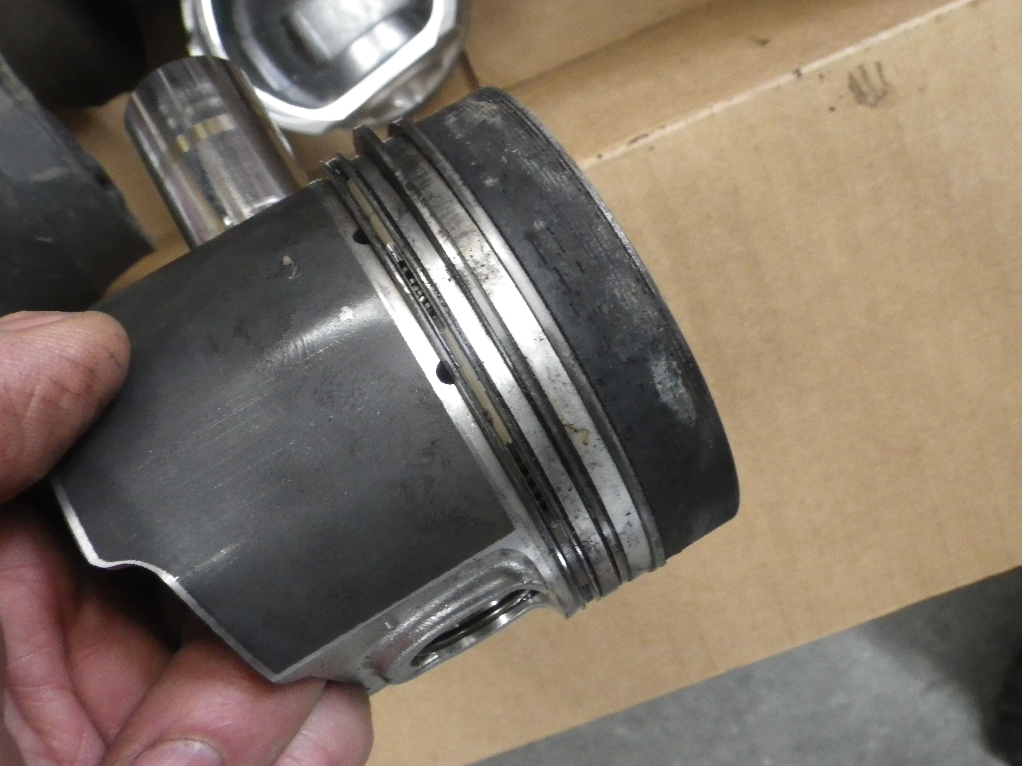

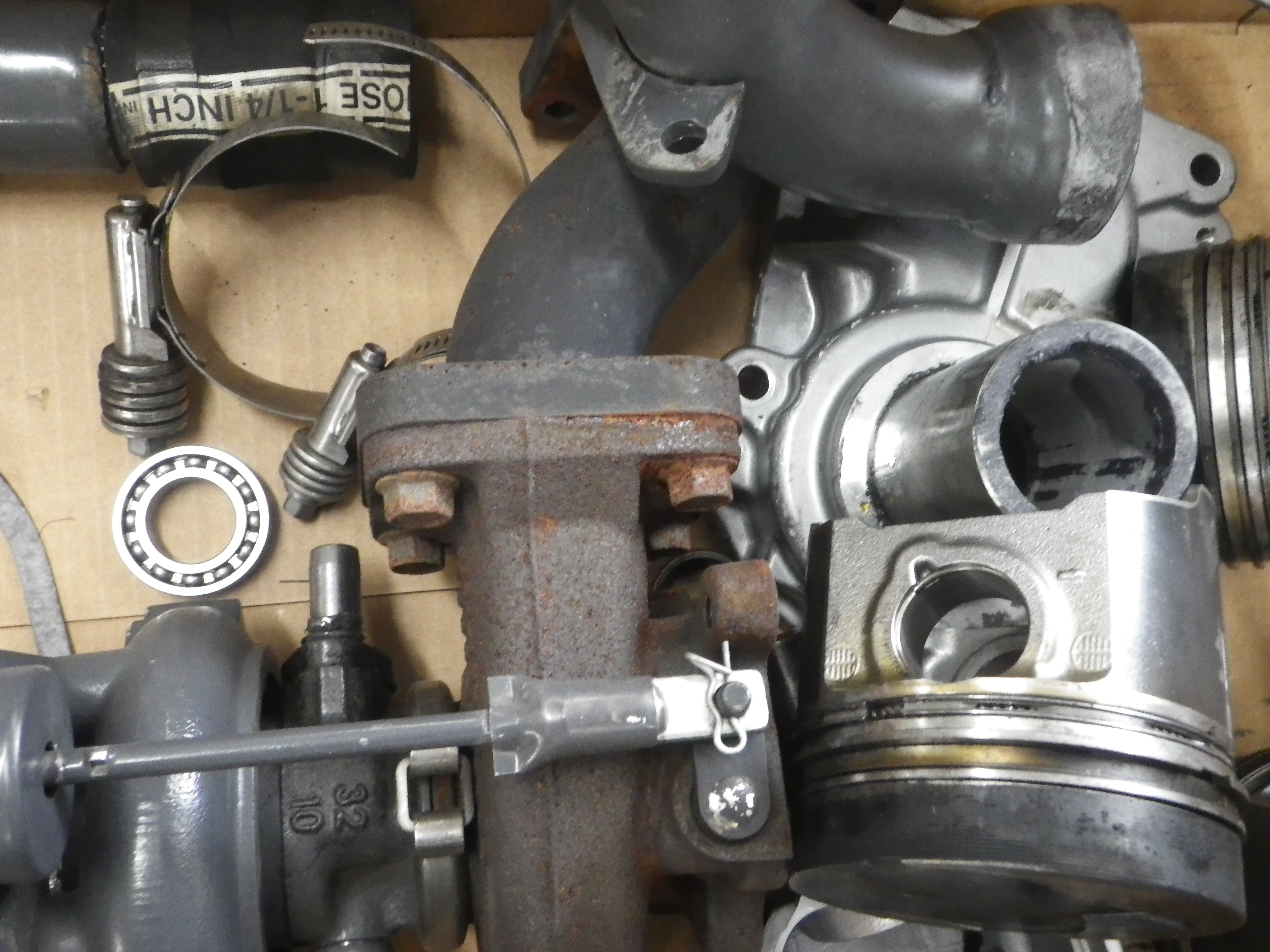

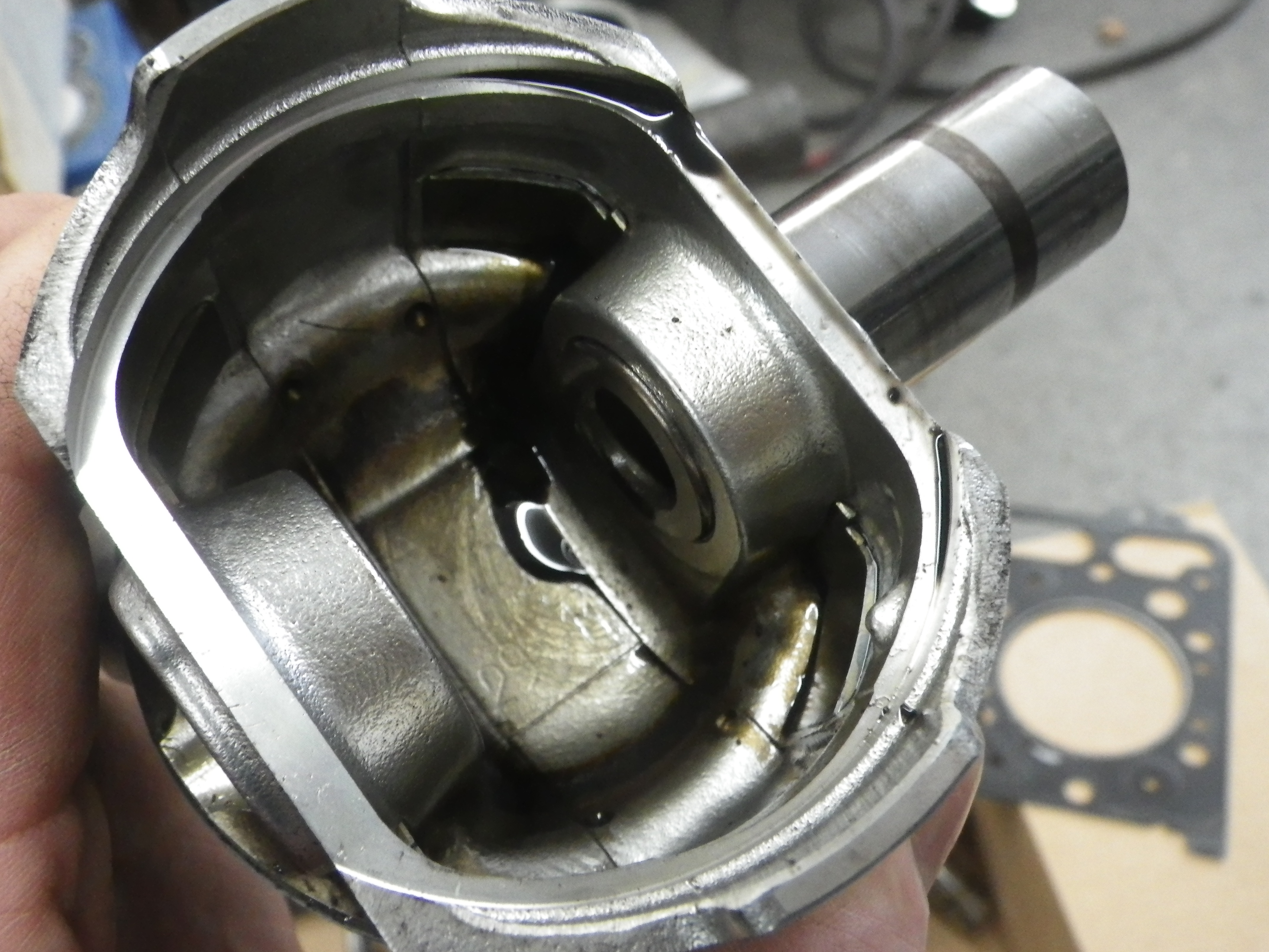

I think too much fuel killed the cat. It only boosted 6.5 pounds. If a guy ran the machine normal and not full tilt it would be ok. In my case pistons with steel ring lands would be the answer for longevity.
I would imagine all of these new tier 4 common rail tractor engines have steel ring lands. I'll check before doing a turbo on my Kioti.
I'll run it through the Winter and get a bigger machine in the Spring. It's not that big of a deal the turbo install, keep it neat and not too hot, maybe install a pyrometer?
I really don't think mine ran too hot but hindsight being 20/20 I should have sent out a few oil samples over the years and I would have known too much aluminum in the oil was certain death of the ring lands. IMGP0246.JPGIMGP0245.JPGIMGP0244.JPGIMGP0247.JPG

Fred, It looks to me like without adding timing with increased fuel duration you may have been wetting the walls *Chasing the piston ATDC*. The oil scrapers look clean and clear (you definitely kept up on oil changes) so oil contamination likely did not cause the rings to stick. But as you know, once that top ring was no longer free to move, it was all down hill from there..
Edit: Also, the reason I agree with Fred it was not heat related is that I don't see scorching in the crown, no major sign of melting, and the skirts look to be in good condition, if it got hot usually the piston swells and there will be a lot of skirt wear.
Side note for those who don't know: Flat piston designs are not very forgiving to increased injector on-time or emissions in general. The newer DI technology, combustion chamber is in the piston not the head. Creates a better swirl effect and cleaner oil (less fuel wetting the walls) and lower emissions.

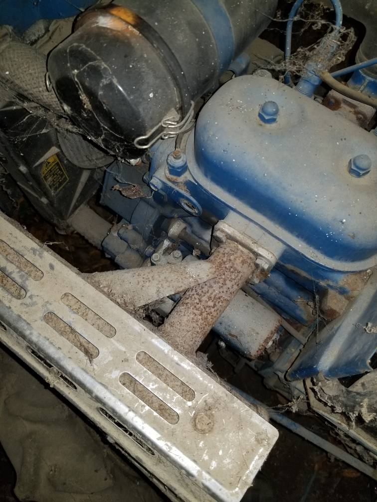

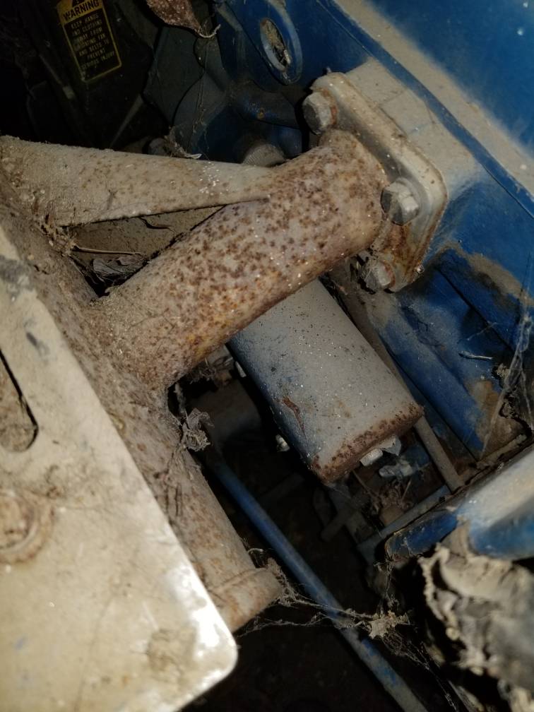

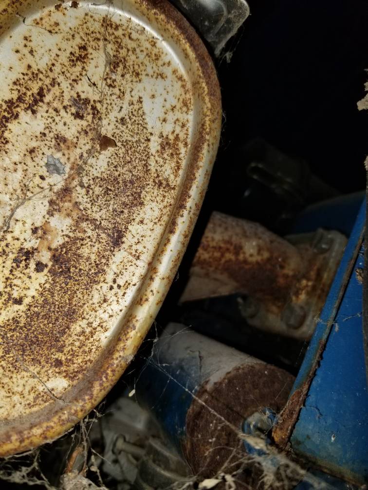

Sorry it took so long. Completely forgot until today. Looks very similar to your 1300.
Showcattle,
Do you still have your 1100? If so, would you mind snapping some photos of the hydraulic pump and exhaust outlet area of the engine? I am curious how much different it is to the 1300.

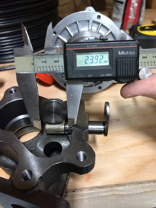

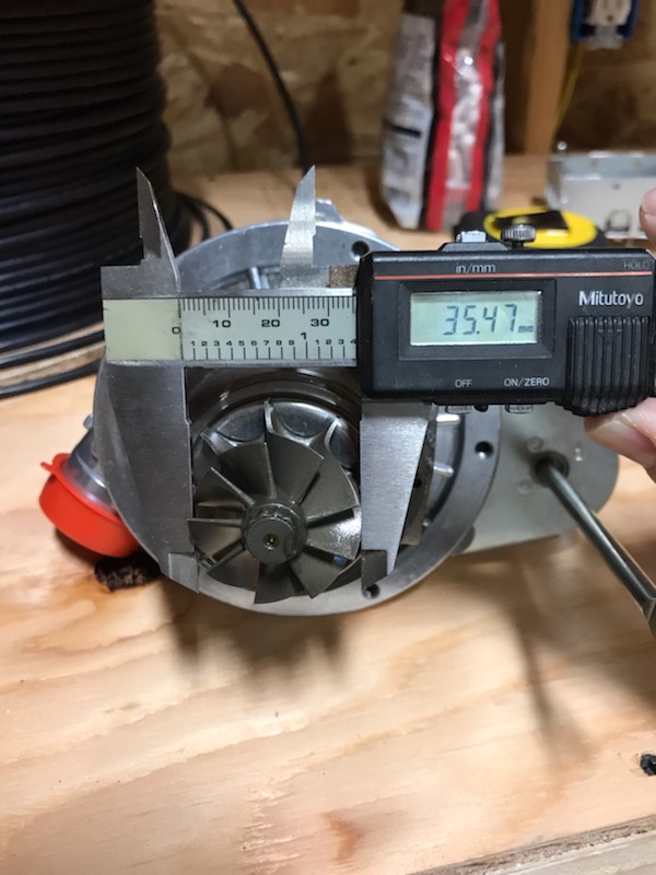

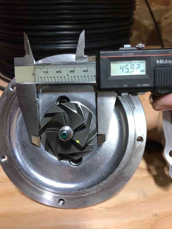

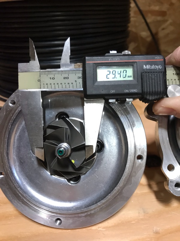

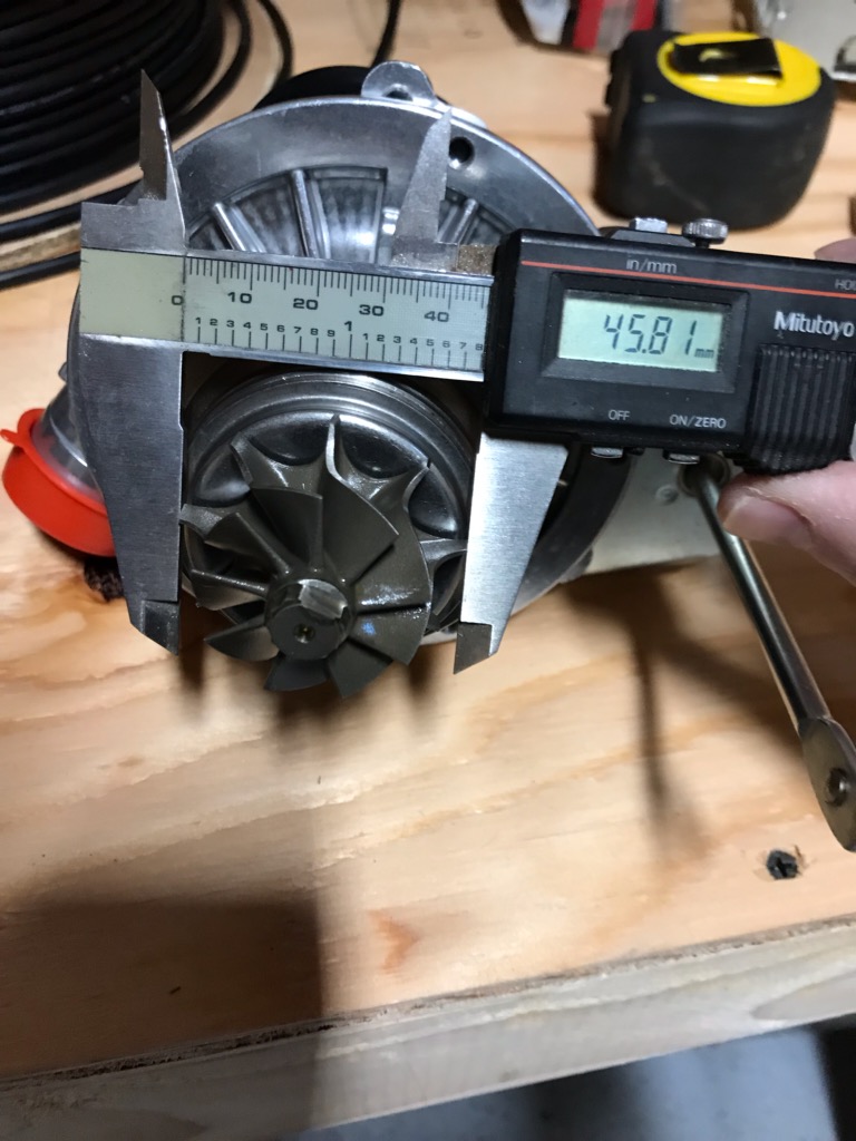

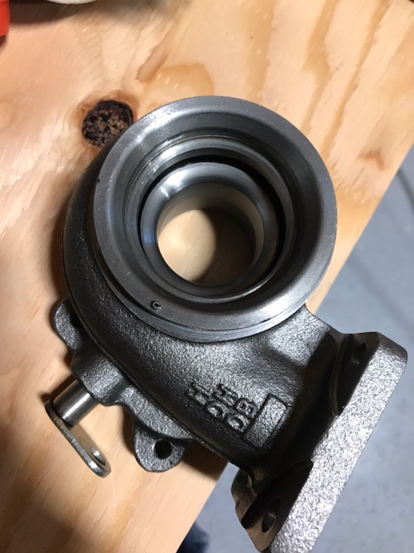

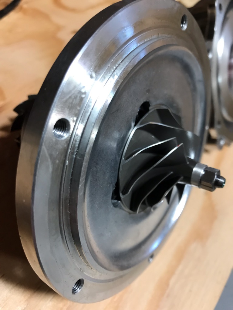

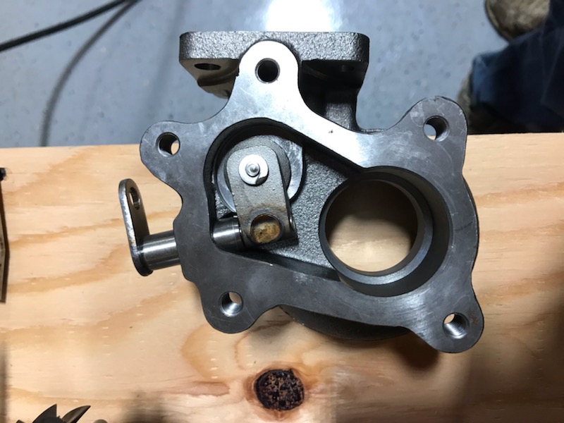

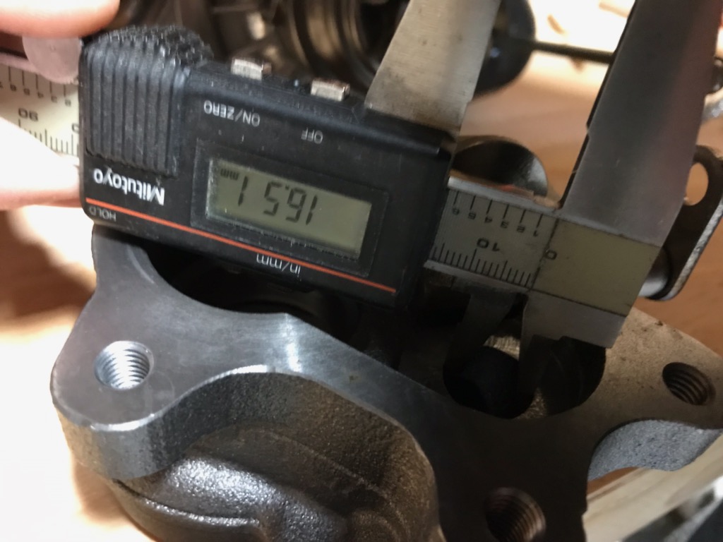

Sorry for the delay, I have a few other projects in the works right now. Main one next is finishing the lighting in my shop tomorrow. In the meantime, here are some measurements and turbo pics I promised early on.
This is the turbine inducer and exducer.
Exhaust inlet size.
Wastegate port and wastegate flapper.
Turbine Housing.
Compressor housing. I am not excited about the lack of seal between the back plate and the cover. Will likely do something here when reassembled.
Compressor inducer and exducer.
Does anyone have questions, want pics or measurements of another part of this turbo? Speak now before I put it all back together.
Thank you for doing that! Looks very similar in the engine but yours has the horizontal muffler.
Side note, has anyone here done an exhaust to route down towards the ground like more modern 99-00 tractors on these older shibauras?

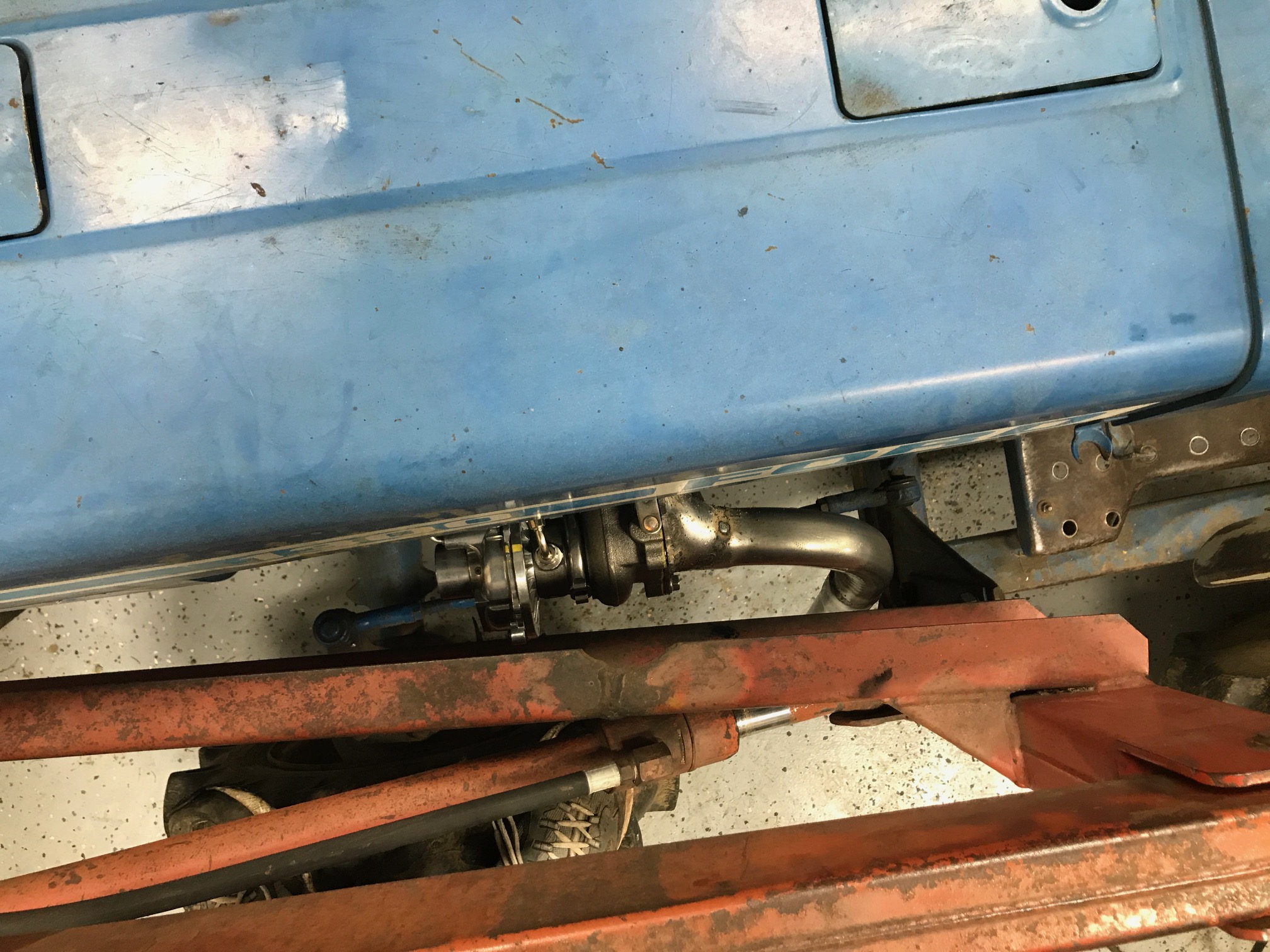

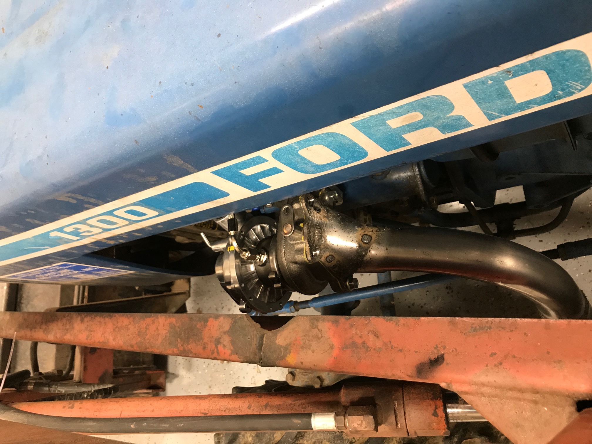

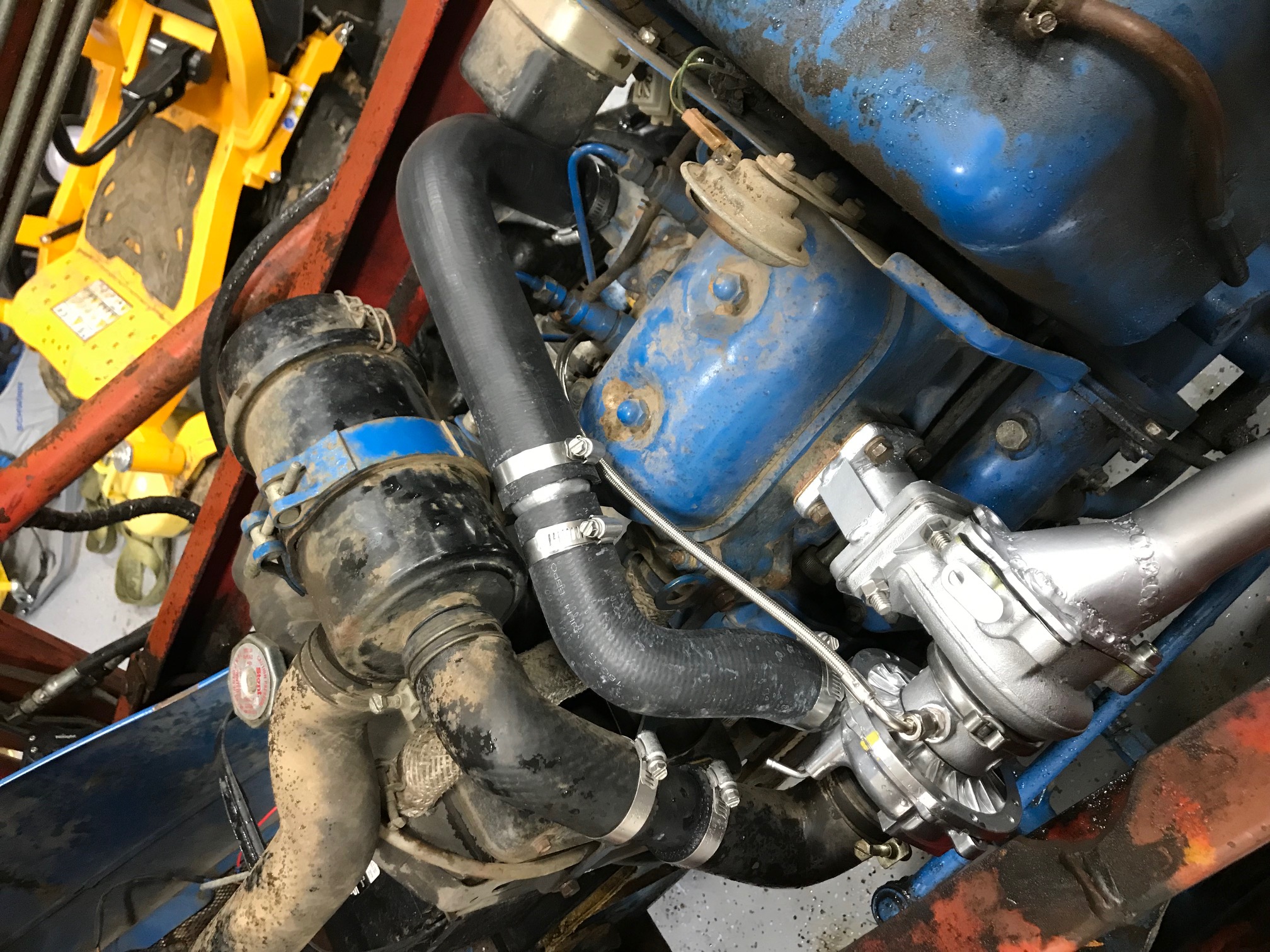

I can finally say with a 99.99% probability, that I have the only Ford 1300 that is turbocharged!!
63115254993__0509CAC2-9BF6-40E5-8561-B095A34855B9.JPG63115257248__FFFC965F-EBBA-4F21-8B2F-DB710618D2BE.JPG
But first, lets recap how it got there.

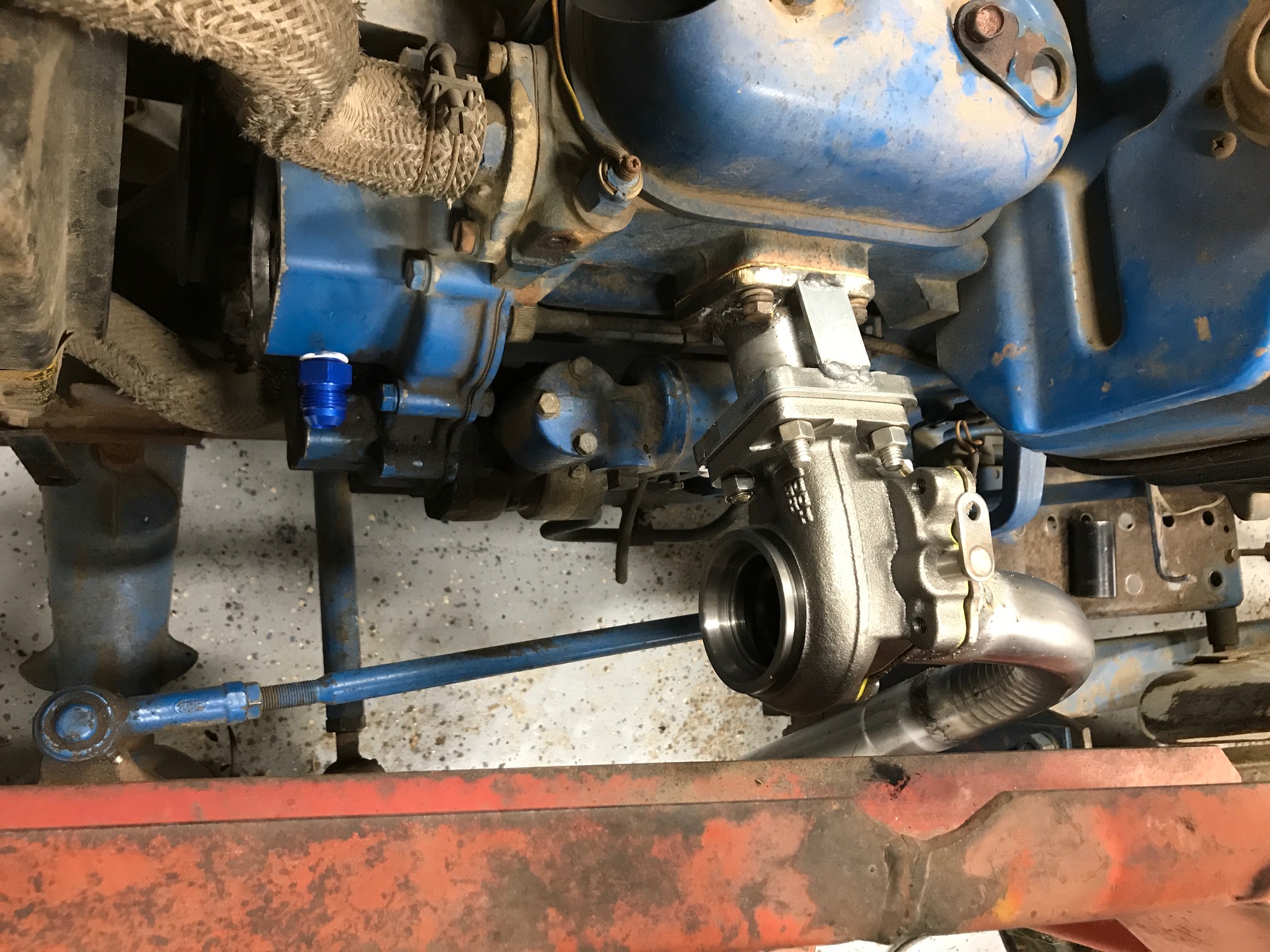

Here we can see the adapter I made, this extends as well as rotates the turbo upward. I did this to get away from the hyd pump and filter housing, then realized I needed to fit inside the loader frame channel. So the adapter was made (tacked) and the turbo was in place.

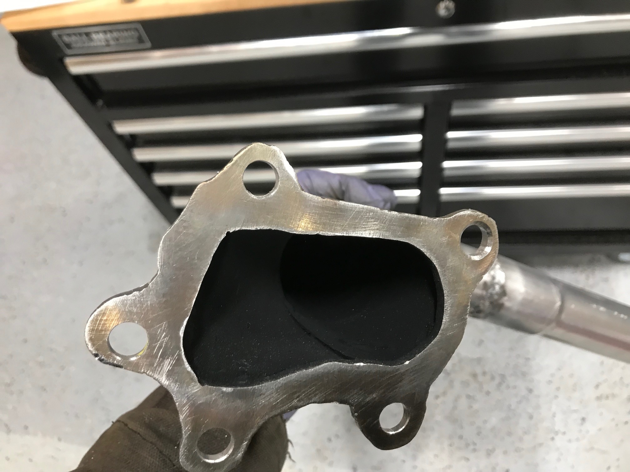

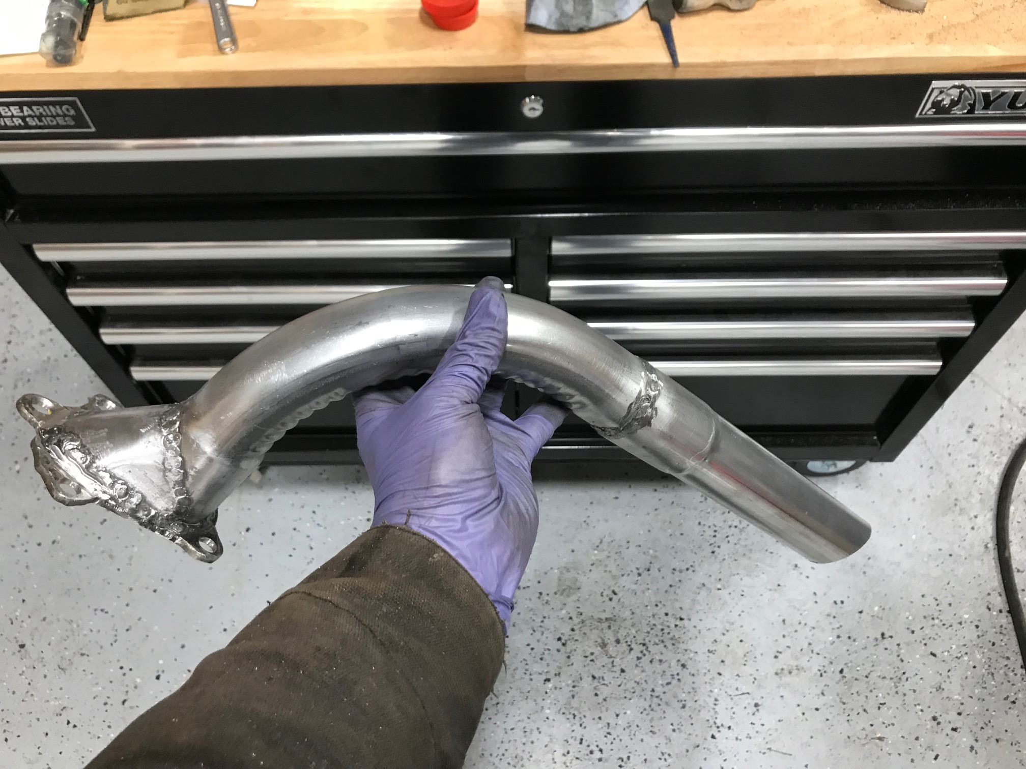

Enter, the downpipe. This again was 100% made from plate and exhaust pipe. The flange kit I ordered does not fit this turbo despite online seller claiming it fits. :confused2:

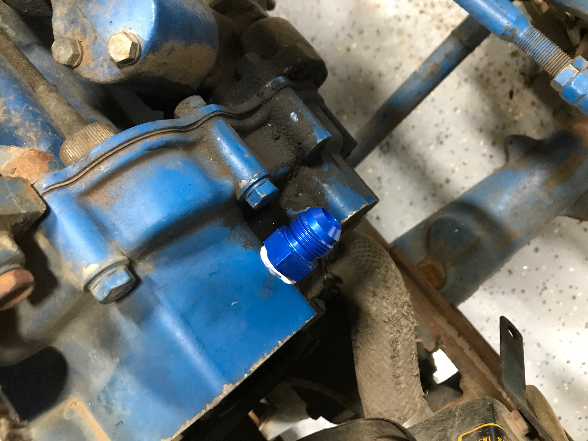

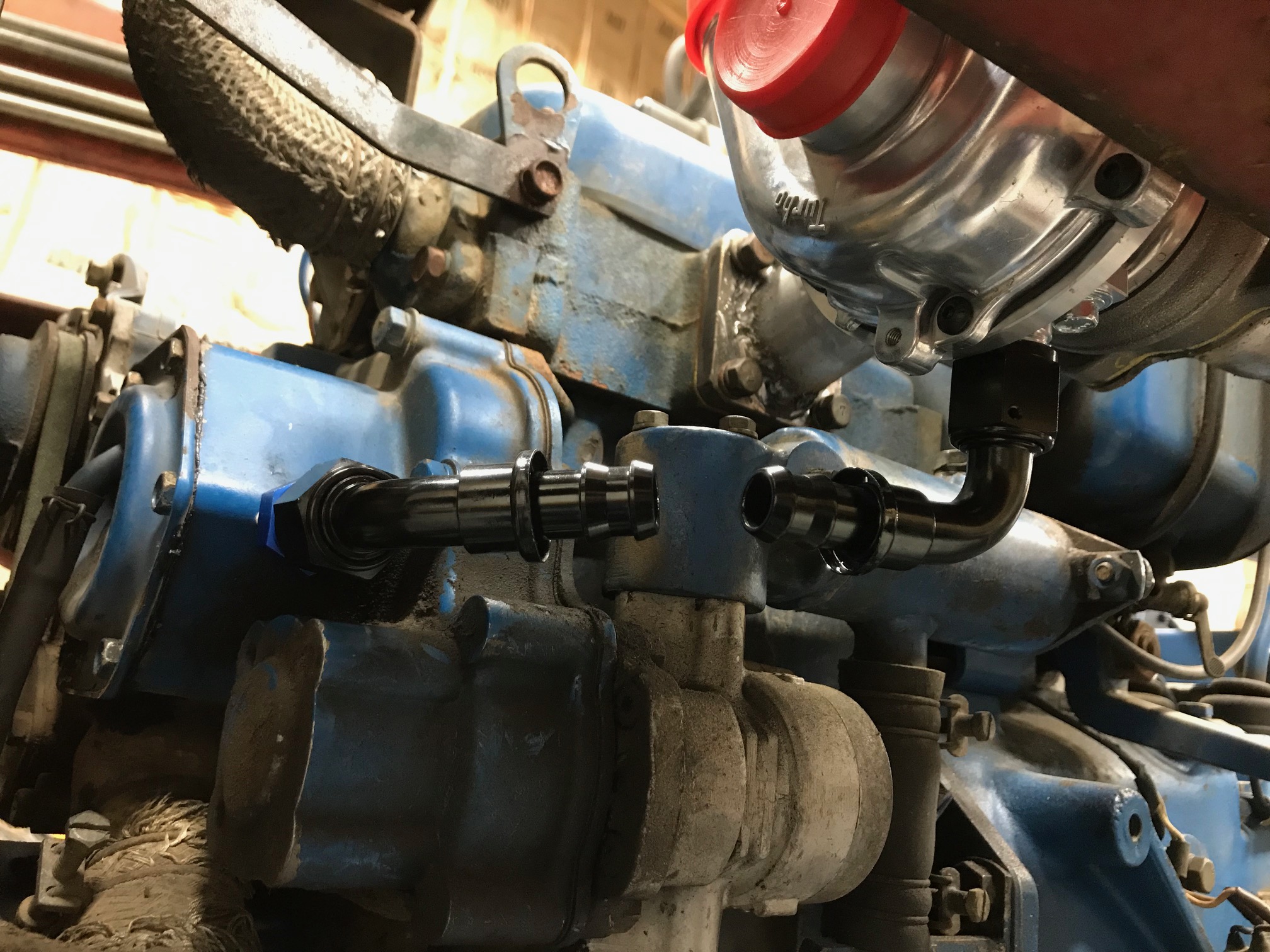

So the turbo is now mounted, adapter is fully burned in, downpipe is complete. Time for plumbing. But wait, this shibaura engine does not have provisions for an oil drain. Hmm where to add a hole? AH! the timing case governor cavity looks like a good spot. Disassembled and removed, filled the void with lint free paper towels to catch shavings. Add a vaccum and a 9/16 drill bit we have a hole big enough for a 3/8 npt tap to match my -10an drain. Finish this off with 5/8 pushlock to -10an fittings.

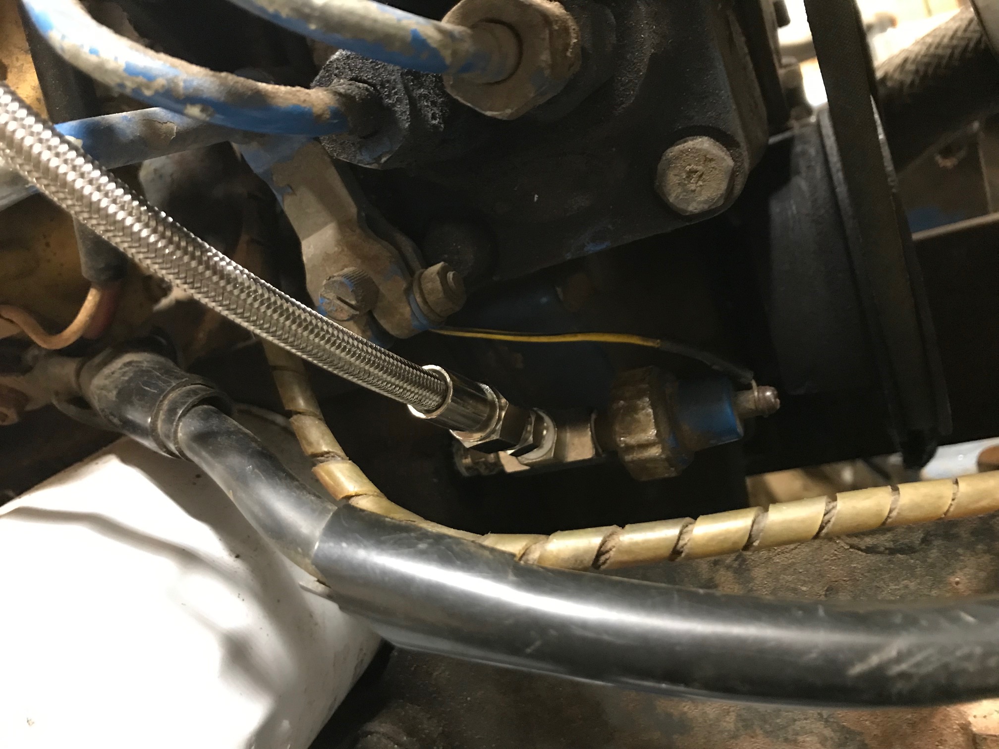

Now we need to feed this turbo OIL. Thats the easy part, install the -4an feed line kit I ordered with included metering adapter. Borrowing oil from filter housing/oil pressure sensor. Works like a champ, but stay away from the exposed +12vdc at the back of the alternator.

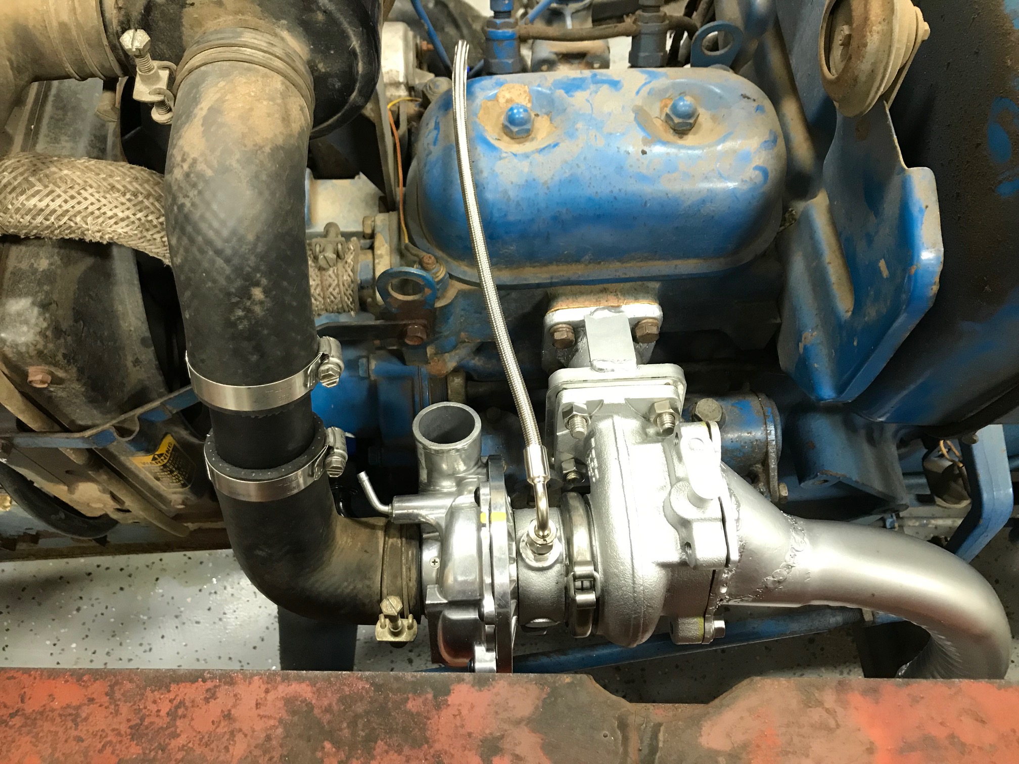

Alright, home stretch! We have oil, we have exhaust, I already cheated and have a full game plan for the inlet. Flipped the air filter housing 180*, and reused the original inlet tube. Cut in the middle to extend the length, I reused a chunk of the old exhaust pipe for the extension.
And finally, the charge piping was added. Turbo outlet is 1-1/2"ish (metric), and the engine inlet is 1-3/4". So I ran to the local parts store and bought two different sections of radiator hose from their stash. And used a 1-1/2" to 1-3/4" exhaust adapter in the middle. VOILA!
Next will be some pump work to try and target 6-8psi.
Thanks for reading!
-Derek
