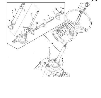

I am looking at a used 790 2WD with only 150 hours. It'a at a dealer and I have not run it yet because of the following discovery.
The steering is very sloppy and loose. It must be six inches lock-to-lock on the steering wheel. It is manual steering.
Anyone have any ideas about this or own one? I would be interested but not if I have a problem like this that I do not understand

My 790 is a 4WD with PS. I did have manual steering Yanmar (the 790 is a Yanmar design) and my steering box had a broken bearing and I had that kind of play. It is a pain to get the steering box out. You can adjust with a screw on the right side but with that kind of play I would assume something is broken.

My 790 operators manual troubleshooting guide says:
Excessive play in steering. See you John Deere Dealer
Is it at a John Deere Dealer where they could possibly fix it before you bought it, or at least tell you what it would cost to fix it. If it is not a John Deere dealer, could you contact a John Deere dealer and ask what could be wrong.
If I had to guess without seeing, it would be something is worn out in the steering box.
