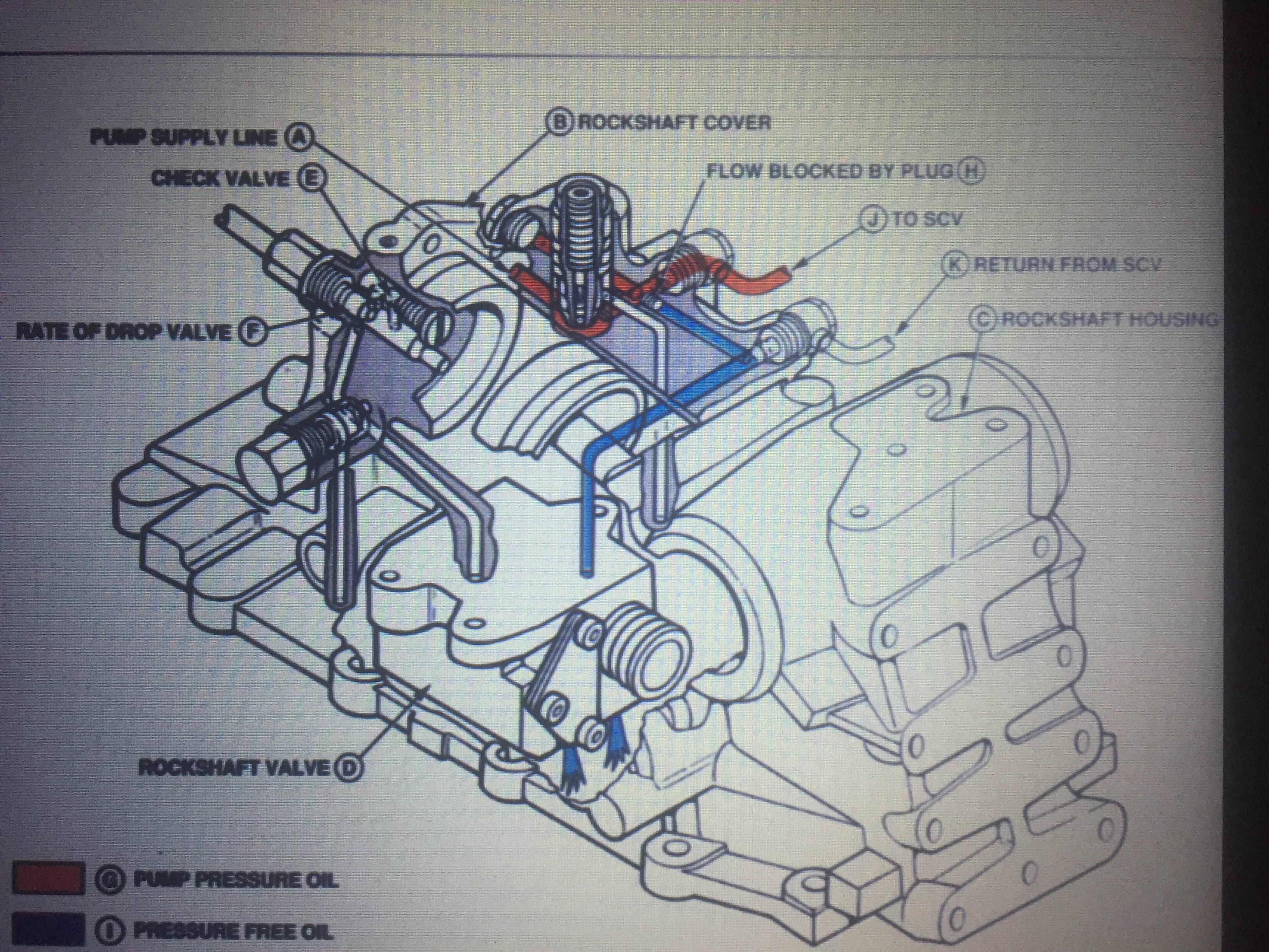

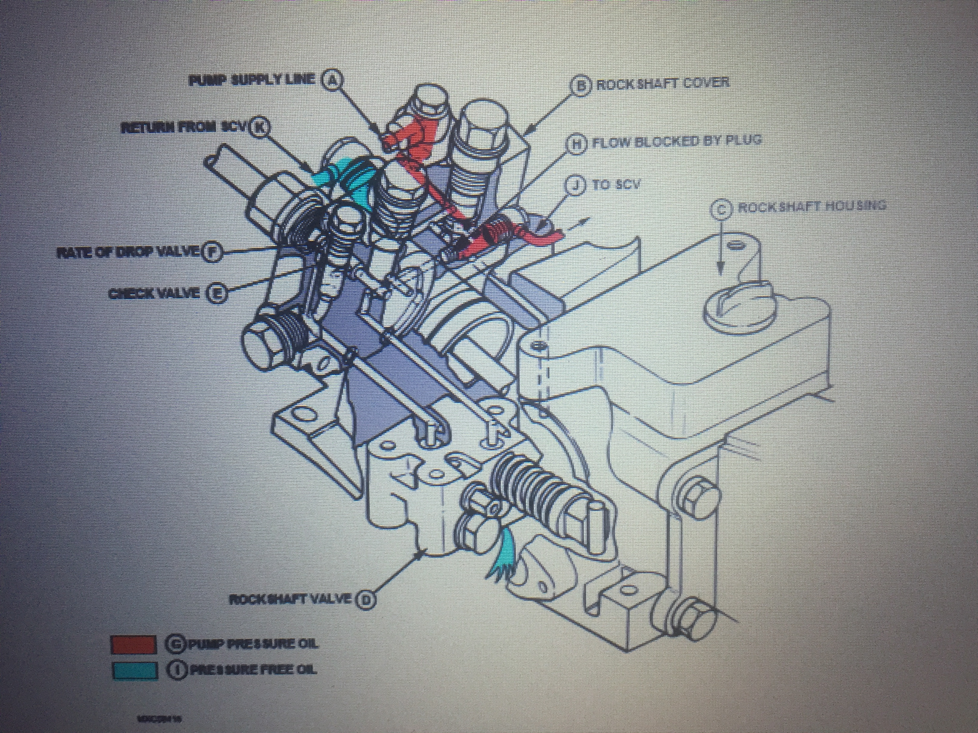

Remove the large plug/cap on the front of your rock shaft and insert the "internal" plug to close off the port. Mine was installed on the port that was on the right side of the tractor.

If u are standing at steering wheel looking at back tractor my 2 service lines are plumbed into the Left hand side hex plugs of rockhouse and return goes into side transmission

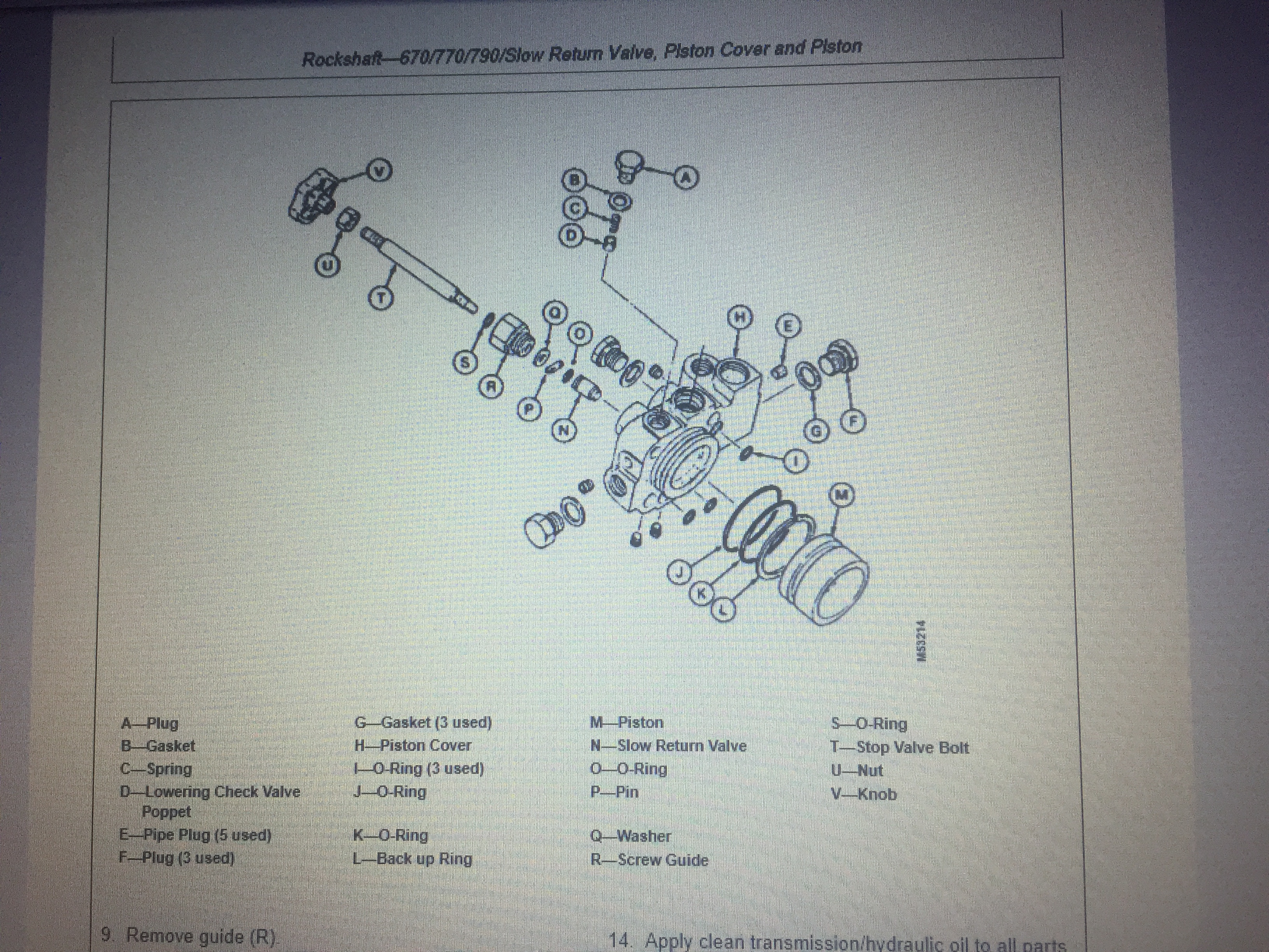

I looked on green parts and it shows the internal plug in the first port (front of tractor)

John Deere Parts Catalog Go to the 990 SCV parts the drawing seems that you have 2 ports on the right side of the tractor. It appears the one toward the front of the tractor is the one that takes the plug. Look at the drawing part 30 is the plug.

Donnie31 special thanks to ya the plug actually went in the front port but loader is working like it should all over a 2.67$ plug lol glad it fixed
