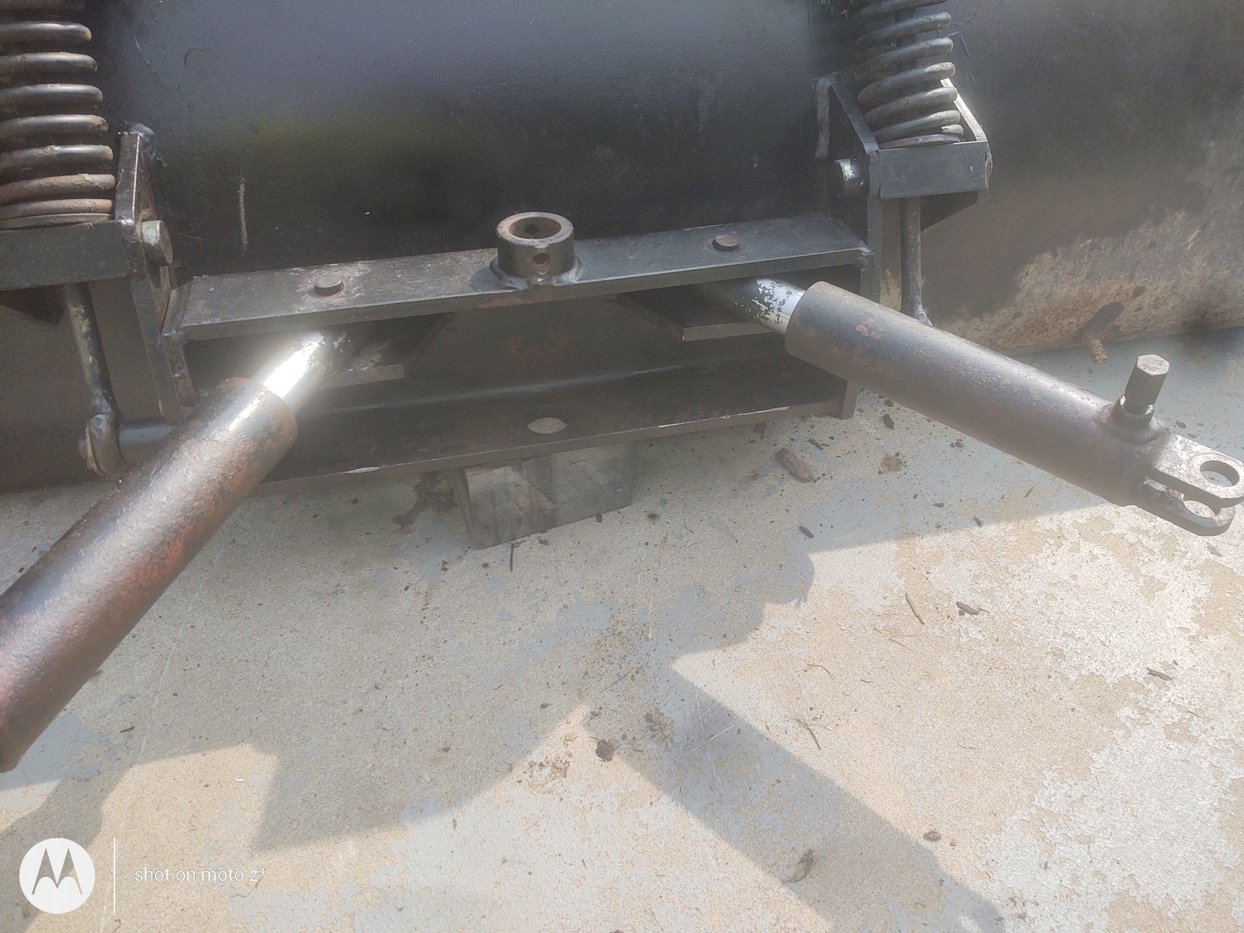

Hello, everyone. It has been years and years since i have been on the form.
I have a 790 front blade that has served me well. Very well over the past 27 years. Could not ask for a better and more and durable blade. I have done a lot of dirt work and plowed miles and miles of snow plowing. AWESOME BLADE!
My problem is this past winter on one of the angle cylinders the seal started to leak. So, before this winter i wanted to reseal ALL 3 cylinders. I have the seal kits.
I cannot get the pins to come out of the chrome cylinder rod.
Any help would be appreciated.
Can add pics if anyone wants me to.
Thanks!

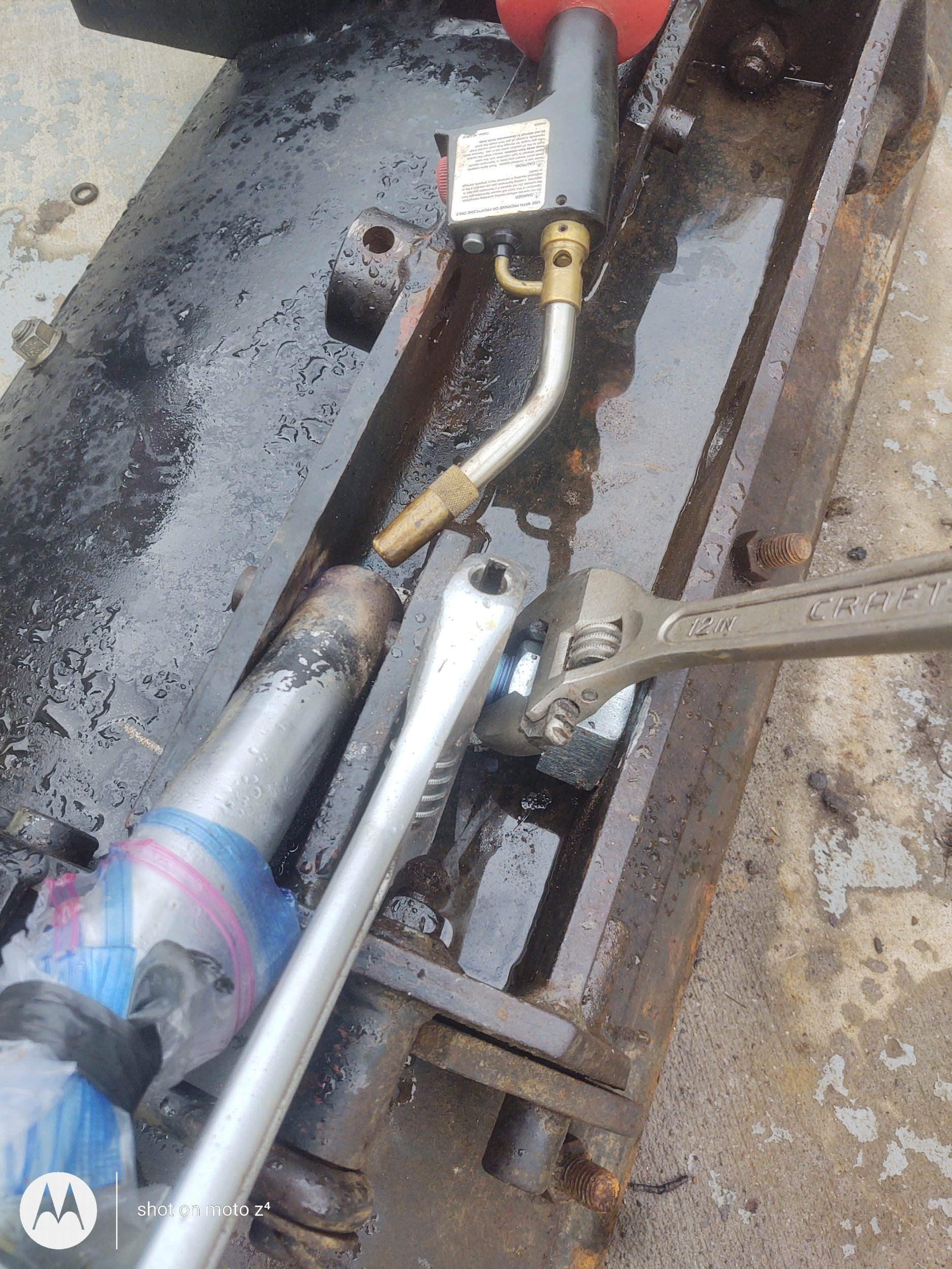

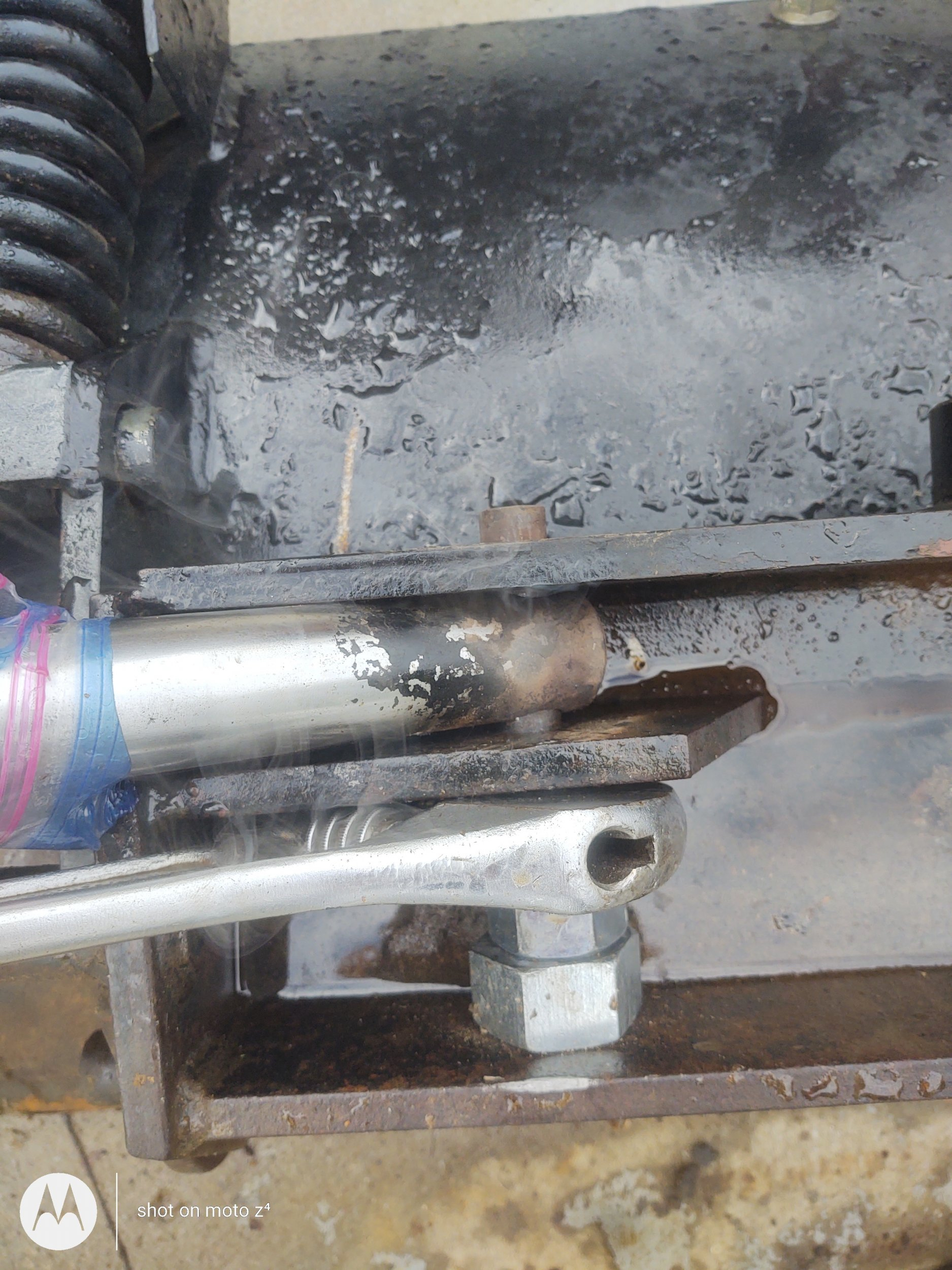

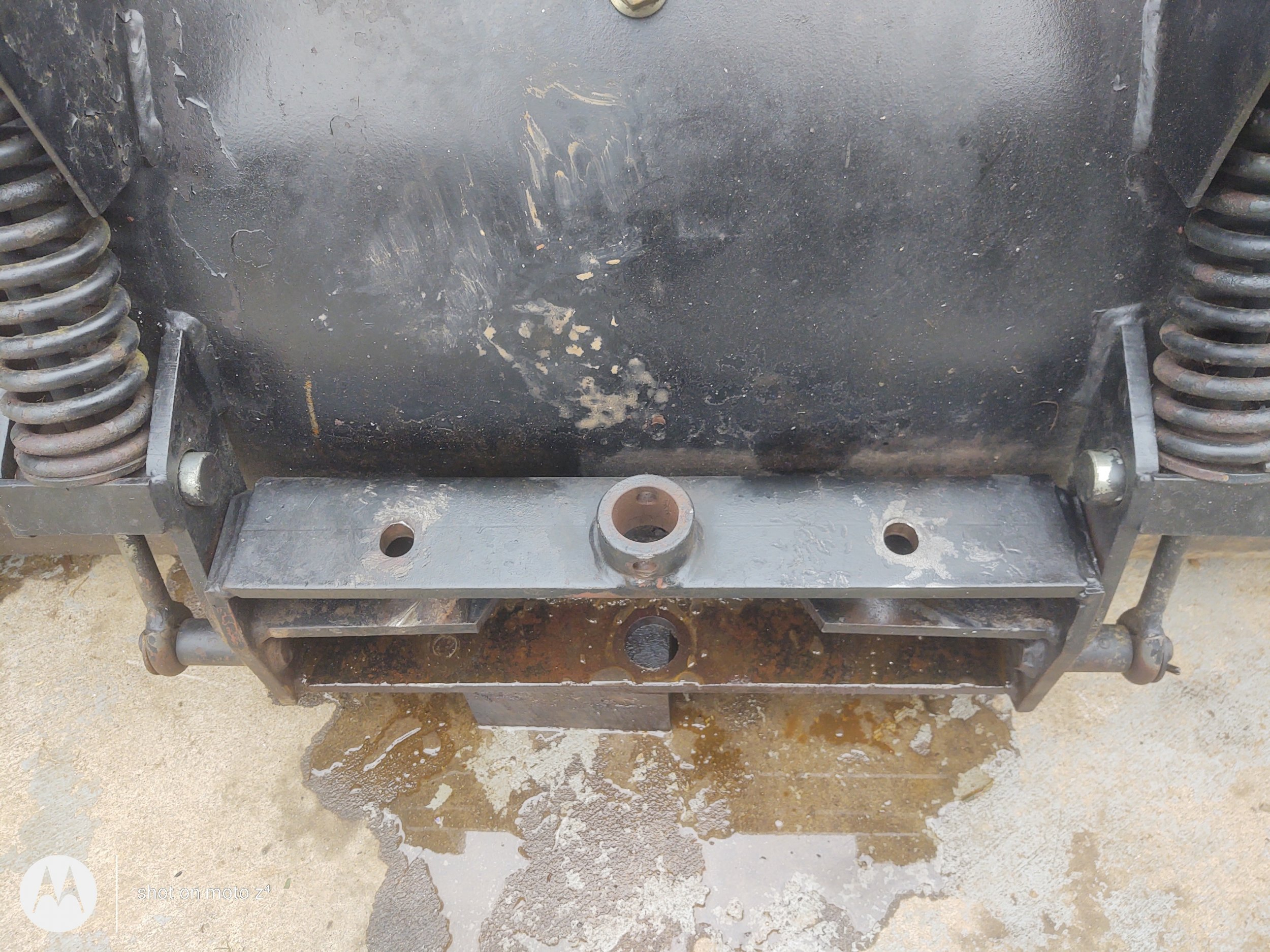

Aborting the plan to remove the angle cylinders from the mold board frame. Going to repack them right in place. Those cylinder pins ARE NOT COMING OUT. We even placed a bolt and threaded sleeve between the pin and boxed in area where the cylinders are pinned to the mold board. 3/4 ratching box end double wrenched with a 1-5/16ths plus a 4 foot cheater. I did pop twice. May have moved 1/32nd. NO JOY. So, going with plan D.
Second pic is lift cylinder. Starting on it first.

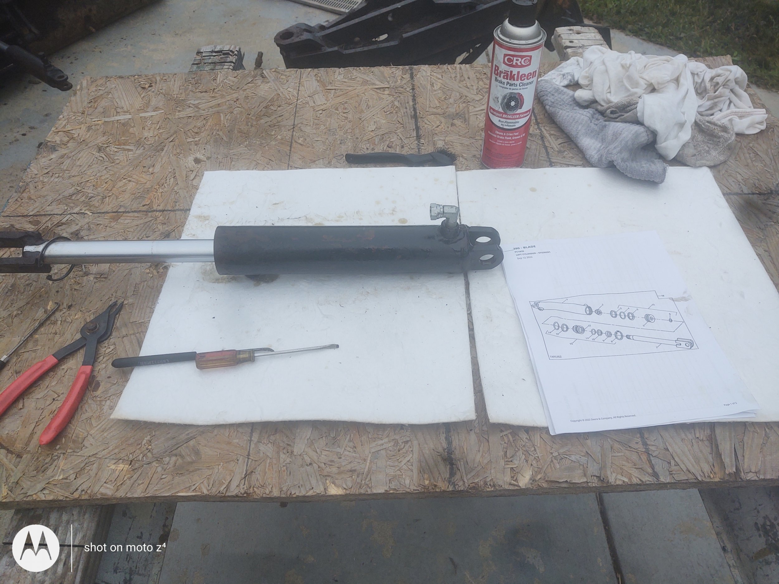

Well, as things go, you end up with going with a totally different plan.
I was able to find s set of angle cylinders at Fulton Mower Salvage in McConnellsburg, PA.
Drove to there place on my way back from the Carlisle Swap meet and picked the cylinders up.
This place has tons and tons of Deere salvage parts and the owner is a great guy!
The second problem was gettting the chrome rod pins pressed out of the cylinder rod ends.
I used BIG BOLT,BIG NUT, BIG WRENCH PLUS a 4 foot cheater bar.
DONE!
