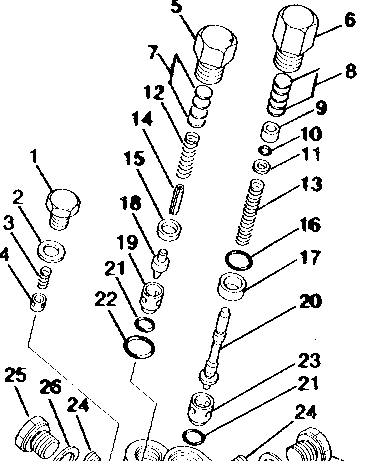

I was looking at my parts and service manual last night, from the parts manual there appears to be a seperate relief valve for the three point, and it listed a different part number for the shim pack for it. The three point is adjusted by shims under the cap to the left of the system relief valve. Not sure how the system valve reflects on the three point valve.
   / 790 HP Reduction By John Deere #55
I was looking at my parts and service manual last night, from the parts manual there appears to be a seperate relief valve for the three point(part #5), and it listed a different part number for the shim pack for it. The three point is adjusted by shims under the cap to the left of the system relief valve(#6). Not sure how the system valve reflects on the three point valve.
I see what you mean, the 3pt relief valve is the next biggest cap and is to the left of the system relief valve cap. from the drawing the shims are as easy to add as the system relief valve.
A couple of questions? Does the system relief valve pressure contol the entire system? Adding shims to the system relief valve as we have COULD still have raised the 3pt capacity IF the 3pt valve is set from the factory at a higher setting so that the sytem valve trips first. It is possible that JD has the system valve set as the limiting factor at 2100lbs and thet the 3pt is at a different, higher setting as a backup in case of a clog or defect etc??
I don't think any of us have tested the 3pt lift after the modification (no need for most of us). My gains were measured ny FEL lift. I have nothing thta would warrant adding the 3pt shims IF that were needed but the procedure would be equally simple and the part is $2.
I still have a feeling the system valve has an effect on the 3pt and thta the 3pt valve COULD be an additional safety built in to the system. If the 3pt defaults at he same or lower pressure than I am dead wrong and you need to add shims (parts # 7 &8 )right to the 3pt.
We could use the original posters help?
All I know is my tractor lifts itsef to full height easily with the FEL w/o using curl now. It would not do that before. My 3pt capacity is still unknown however.

Thanks for posting the parts diagram. Several of the previously mentioned small parts got away as I pulled off the cap. The diagram and a magnet resolved that issue.
I ordered 2 packs of shims. The dealer only sent 1. He cautioned me about damage to the front wheel drive system from excessive loads in the bucket.
I installed the shims (4) that came in the package. Prior to installation the loader would not lift the front of the tractor off the ground, now it will.
