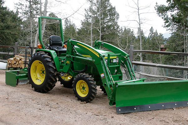

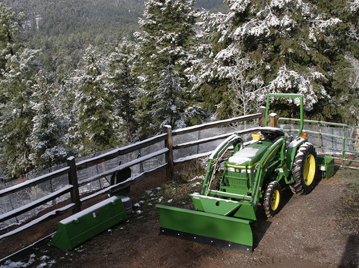

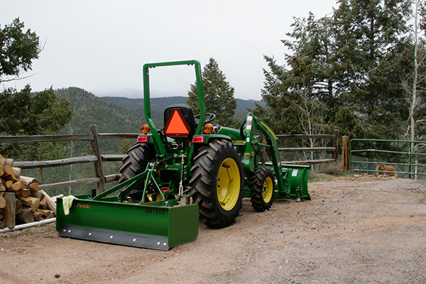

OK, I figured out how to attach pictures in my posts. Still can't put them into photos but oh well.

As the others have said, lower the arms then roll the bucket. I can lift the front of my 790/70 that way.
I see you've got the "other" R1 tires/wheels on yours. Mine are one piece rear rims and seem wider but not as tall. I like the adjustable rims you've got. How do you like them?

The rear rims are at there widest so I'm not planning on moving them. I've only had the tractor for about 5 weeks and have plowed a foot of snow once and graded the road 3 or 4 times and the tires have great traction, the tractor lots of power. It starts a bit hard at 8600 feet but that's probably just the way is is going to be at that altitude for a diesel. Usually use the heat on the intake air. Very happy with the tractor. Had a 20 hours grey market Yanmar before and like this tractor much better. Actually this is a Yanmar too just bigger and new.
I'm planning on putting on a selector valve and the angle hydraulics for the blade before next winter (our snow starts in Sept or Oct). Trying to figure out how to put a tool box on a better place than the fender I have one on now. The tool box is too small. Otherwise since I don't do extensive loader work and I can live with the gear transmission I'm very happy with the tractor.
