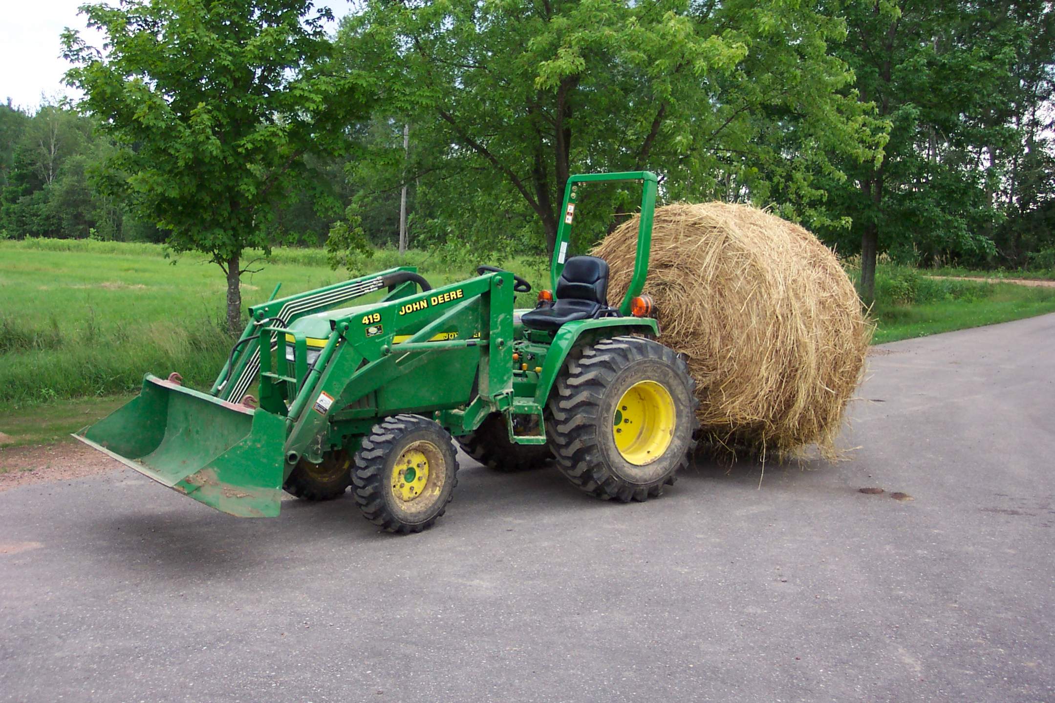

I have a 790. It is a small tractor with a big heart. Most of the time it suprises me in a good way but there are days I am frustrated, always when I am asking way too much to begin with. It has a small wheel base and is tippy. There is always danger when pushing the envelope. We are all quick to preach safety but we must all break are own rules from time-to-time. Just like anything proceed with caution.
I have carried round bales with the 3pt on my tractor. I have not shimmed it...yet. The bales were 5 ft dry grass bales. I would guess in the ball park of 800-900lbs. I have not done it with my loader but do plan on it. For that I will put the shims in. I have seen pictures of it on here. I figure a simple lift and set on flat ground within reason at my discrepancy. Safe...debatable.
All-in-all a good little tractor with traction usually the first to go.

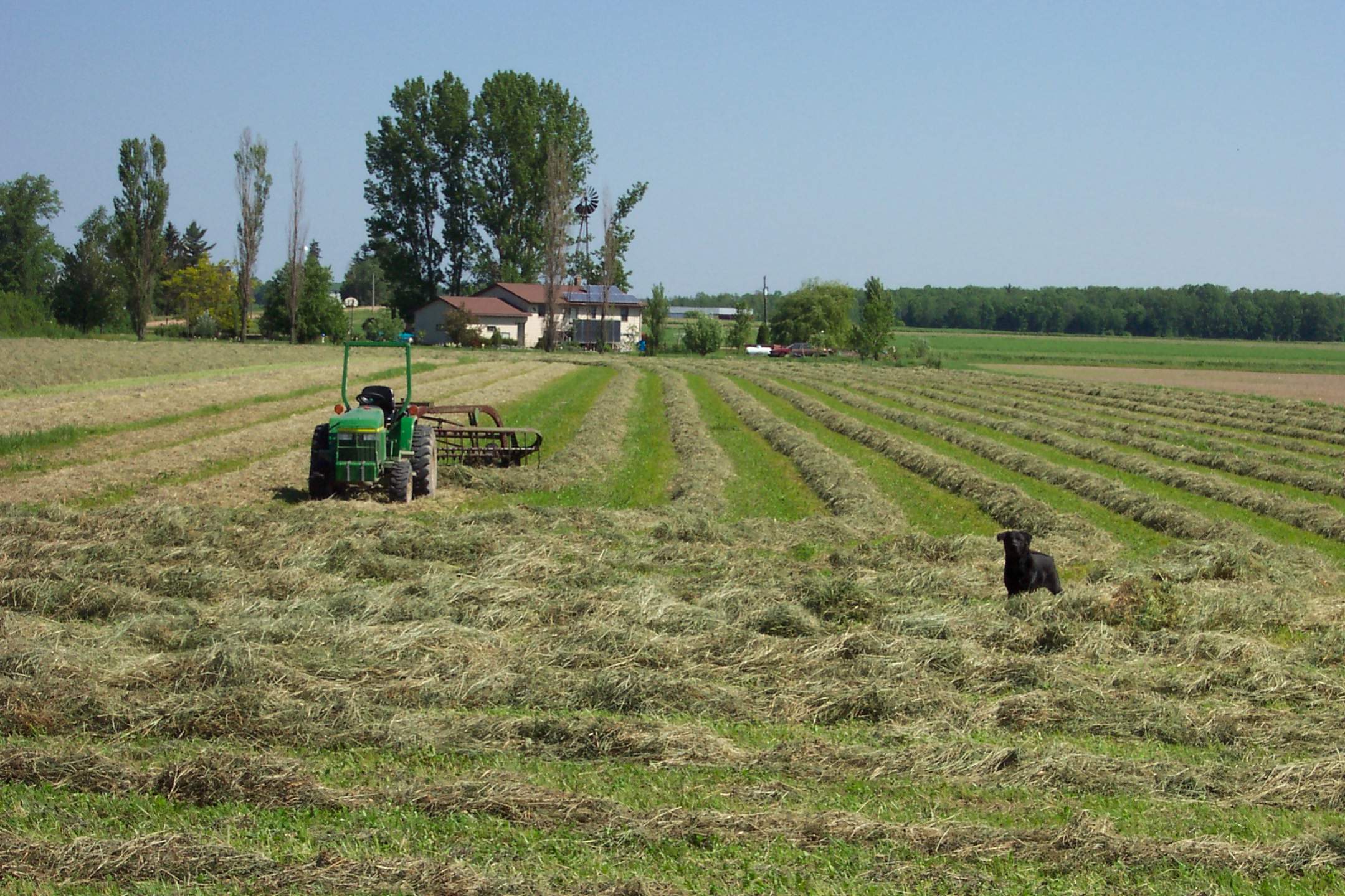

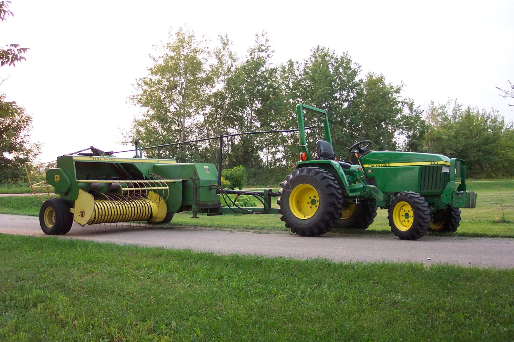

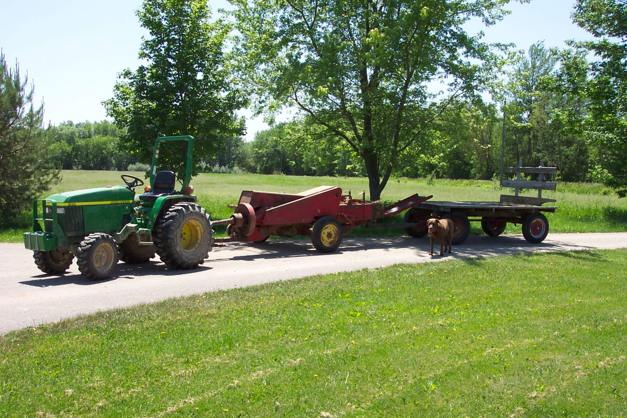

I have baled with several different rigs all the way up to a JD336.
I pull a 2 btm plow in 3pt connection and trailer type. I have pulled a 10ft disc but I get better performance with anything smaller. I do way more with it than most poeple would say is possible. I am sure I am wearing it down quicker than most but it is a tractor for use not collection.
Some more pics anyway....
