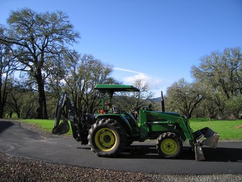

Hi AKfish and Rdln, the front tires on my 970 are not 8.00X16 they are Goodyear 240X70R16 DT810's. This radial R1 tire has the same height as the OEM 7.00X16 Firestone Field & Road tires but are 9.6 inches wide as compared to the OEM 7 inch wide R1's.
Had to change to 990 front rims (#LVA 10550, $78. ea) since the OEM rims were too narrow. My rears are 13.6X 24's and since the front Goodyear's have the same dia as the OEM's my front to back gear ratio is still in line.
I can kick the rears up one size and still be ok on the gear ratio thing.
The wide front tires work well when doing loader work on wet ground since the don't sink as much as the OEM's.
The only down side to this tire move was the bucks for the tires and rims. The clearance factor when turning tight (loader hoses) turned out just fine.
I am attaching a pic of my 970 with Bradco hoe (8') and Long 4n1 bucket.
Note extra glass pack muffler on vertical exhaust.
By the way, I still have the OEM 7.00X16 R1's if anybodys is interested.

Hey George,
I just ordered the stock set of R1's (rims and tires) for a 990 to use on my 970.
8x16 fronts and 14.9 x 24 on the rears (I think it's 14.9's..)
Probably should start a new post--- but, will that bugger up my gearing?
AKfish
